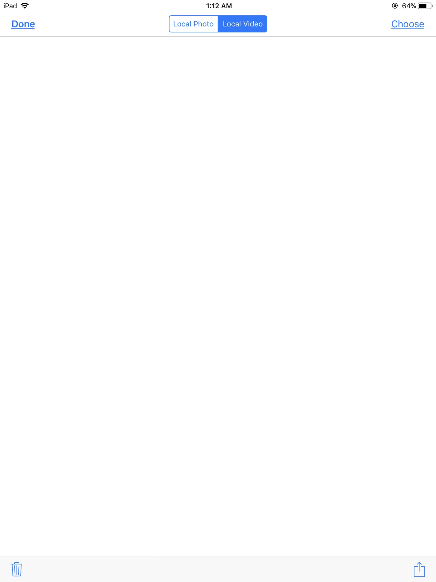

2. The app. Oh my god. What is it good for? I can see in the app only what my cam sees at that moment. I cannot start recording. There are no buttons in the app to control the cam. I also cannot view (let alone edit) the videos I’ve already made. The “album” page is just empty. The app literally has no function beyond seeing what the tiny screen on the cam sees.
3. So far, so bad. I want the videos I record on one of my devices, be it my iPad or my phone or my computer. I can’t get this to work.
Strike 1: Like I said, the app does nothing for me. It shows a blank page when I go into the album section. How I do I view the videos on the SD card? Anyone have any tips?

you need a third party card reader to view the files on your Apple devices, it won't work with the genuine ones
pulling the memory card and using a card reader with your laptop is probably going to be the easiest solution
