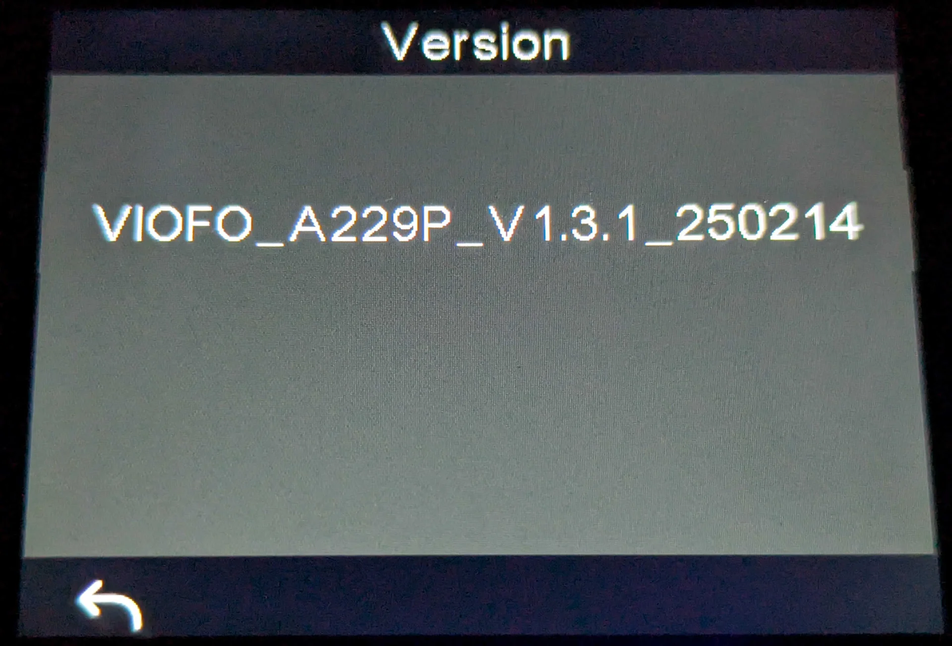

IIRC, I have and attached a video of the issue.
Here is what version its currently on.

In the video, you just pressed it once. Can camera lock a video if you press it twice?
Please update the latest firmware (https://viofotech.com/download/firmware/A229Pro/FWA229P.bin) , reset both the camera and bluetooth button.
Then reconnect them to test.
