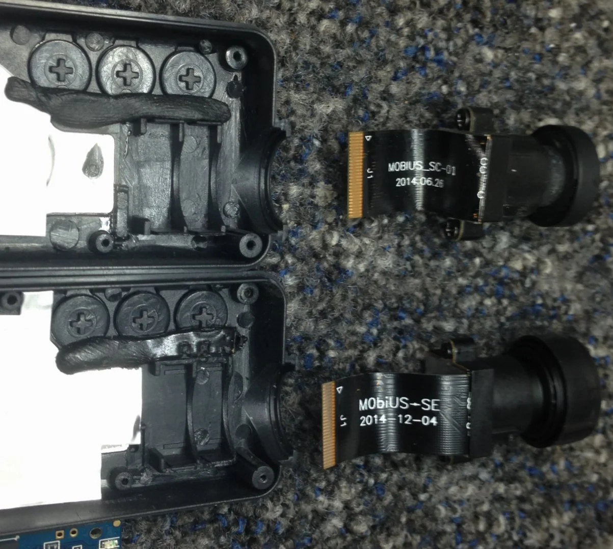

    My new C lens module I just ordered (came with a new case with wider slot for C lens to fit) is out of focus on the left side out of the box. Here is a picture of the old case (bottom) and new "C" case (top). I will attempt to re-focus the lens, but it being out of focus at normal 70 degree weather is disturbing.
    XtrailAndy likes this.
