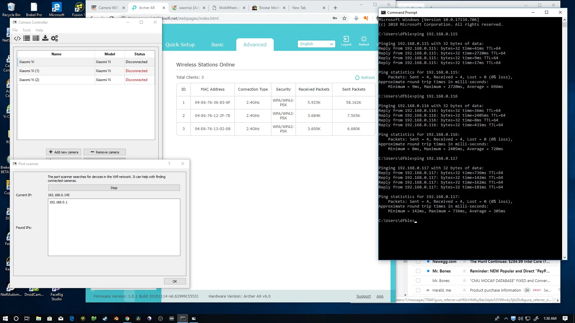

Here is a screen shot of my setup. You can log into your router or go into the Command Prompt.
Best Regards;
David

I tried your script, as your screen shot, and voila :
Then I tried "camera controller", and for the very 1st time the Yi connected.
But only for 5-10 seconds (tried 10 times), but then cannot connect anymore.
Do you have any idea why ?
And strange thing is I tried to ping for making sure :
it just won't show 192.168.1.177
Hope you may know what's wrong
Thank's

Welcome to my world, lol. This is where my problems are. Sometimes, I'm able to connect 1 to 2 cameras and most of the time, it works with zero issues. I'm barely able to get 3 working, I have 5 of these cameras total.
Not sure of your ping, issues. That is strange. I believe I had the same problem with my old router.
Also, you're not turning on the wifi on the camera?
That could cause issues.
You should send Herald, your setup files and have him take a look at them. Maybe there is something he or we missed.
