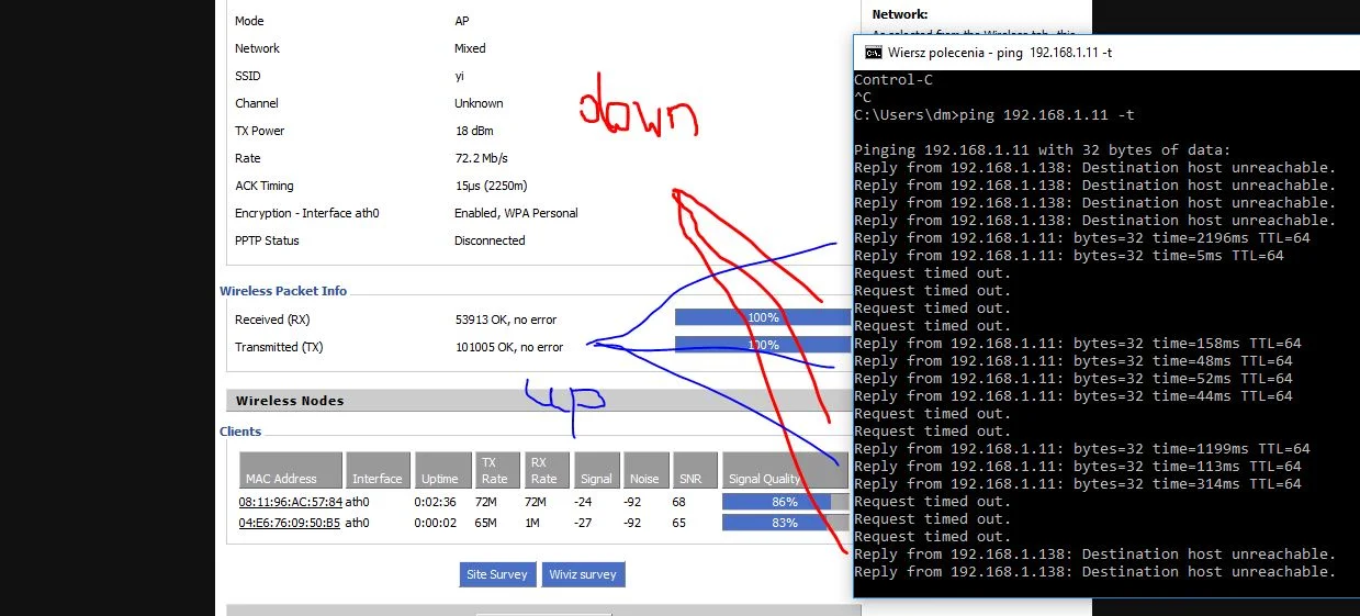

I still have the problem ... i think Yours watchdog modification is OK, but the problem is network in client mode ... something bring them down after few seconds after every start.
I tried it on 1.2.0 and 1.2.13 firmwares - I have the same problem.
Maybe problem appears with new hardware version - what version are You using ? My HW is Z23L. I'll try another router too...
every power ON of the camera or every network recovery-start ?
What will happen if you turn ON camera and will not touch it for 5 minutes? network WILL go down after a minute , but it must came back after a short time and will work forever.

Network never works for more than few seconds in client mode. After start camera (with scripts at SD card) network starts and working for few seconds and goes down. Next, watchdog, starts it again, and after few seconds is go down again, next watchdog starts it ... and so on ... I can see it on router (appears and dissapears) and check with ping tool - for a while is connected, for while disconected, connected, disconnected.... Something like driver was killed after every network (not camera) start - not only first time as You wrote. I have no idea what's wrong ...
