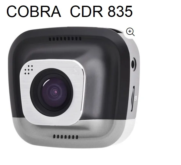

Hi,
anybody knows if I can operate this Cam with dead battery. I have my battery dead.
I actually removed it and after that put camera back it worked OK while on Power, but now after couple of weeks
It won't started automatically, date reset back to 2015 each time, etc ... looks like factory reset.
To start it you need to go thru series of clicks.
I just wandering if there any other Cap or battery for chip that died too ?
My replacement on the way.
Tx
M

When LiPo batteries such as this fail, they usually swell up which can possibly damage the cam. There is also a small chance that the battery will "vent with flames" in this condition (think "hoverboard"). You decide whether those risks are acceptable for yourself.
Most cams will still record with a failed battery if they boot-up properly at starting. The cam battery is there mainly to correctly close the last file on shut-down, so if you are involved in a crash (or otherwise need the most recent file) and the power drops or is turned off, that last file may not be readable. It's usually that last file you need the most. If you let the cam run for longer than it's saved file duration period after an event, that should see the file you need closed properly as another is begun- again in a crash power may drop preventing this.
Good to know you have a replacement on the way! If you decide to continue using this one till the new cam arrives, inspect and watch it closely for signs of excess heat, and to see if a swelled battery is trying to split the case open. If you find either, then stop using the cam.
