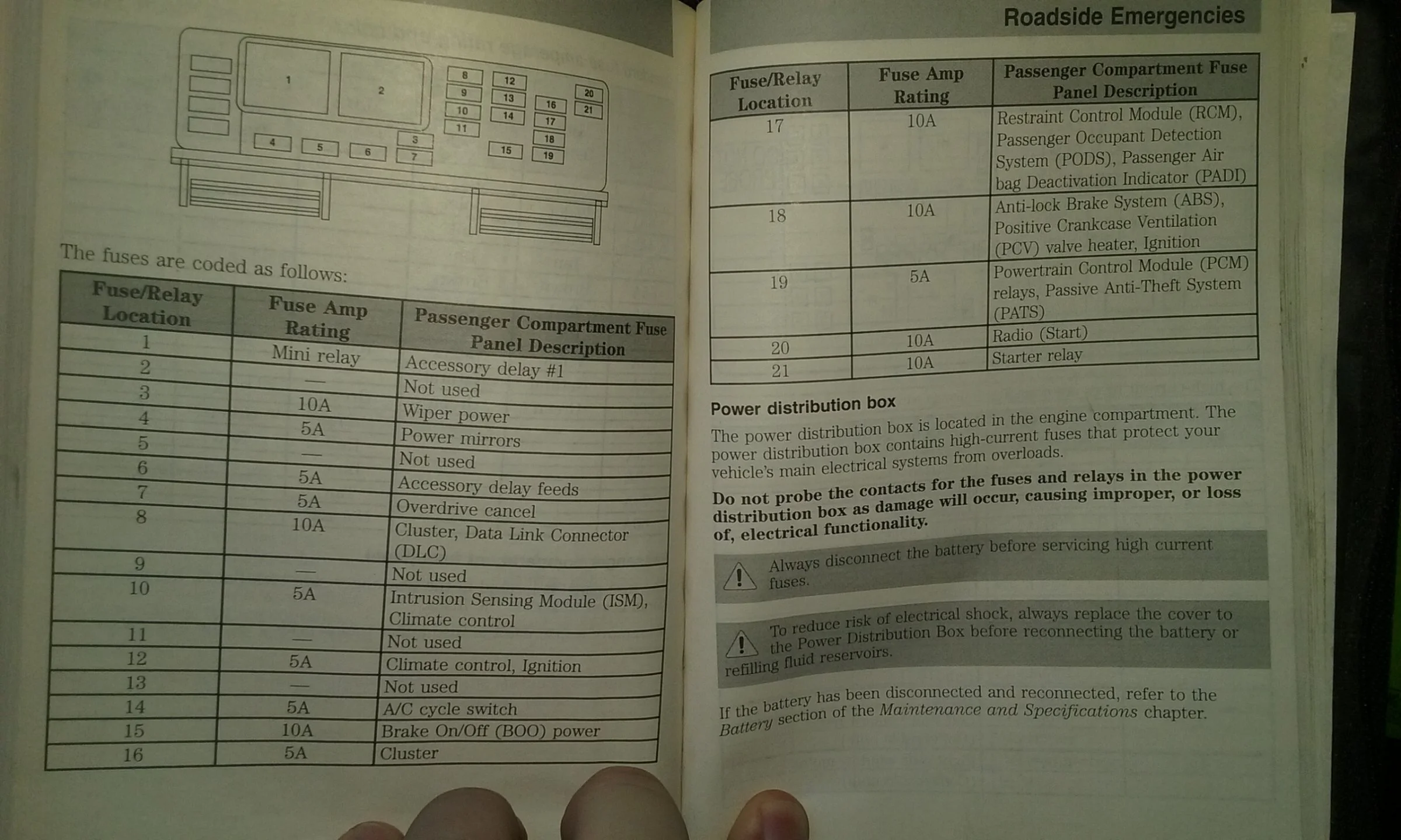

They dont go to anything for 5 n 9. So you are saying use the 3A in the original port of the fuse tap and nothing on the external slot? the external with is the 3A fuse that goes to directly to the dashcam?20170803_113251.jpg
Nigel
Jul 7, 2014
14,203
7,237
Devon
Gitup F1+G3ꞈꞈꞈꞈꞈ Viofo A139ꞈꞈꞈꞈꞈ Blueskysea B4K+B2K
Just because the manual says they are not used doesn't mean that they are not connected to anything. They may be unconnected, but unless you can prove that they are not connected it is not worth taking the risk of putting a fuse in them.
You will need your 3A fuse in the top, going to the camera. Leave the bottom empty, and remember the tap will then only work one way around.
