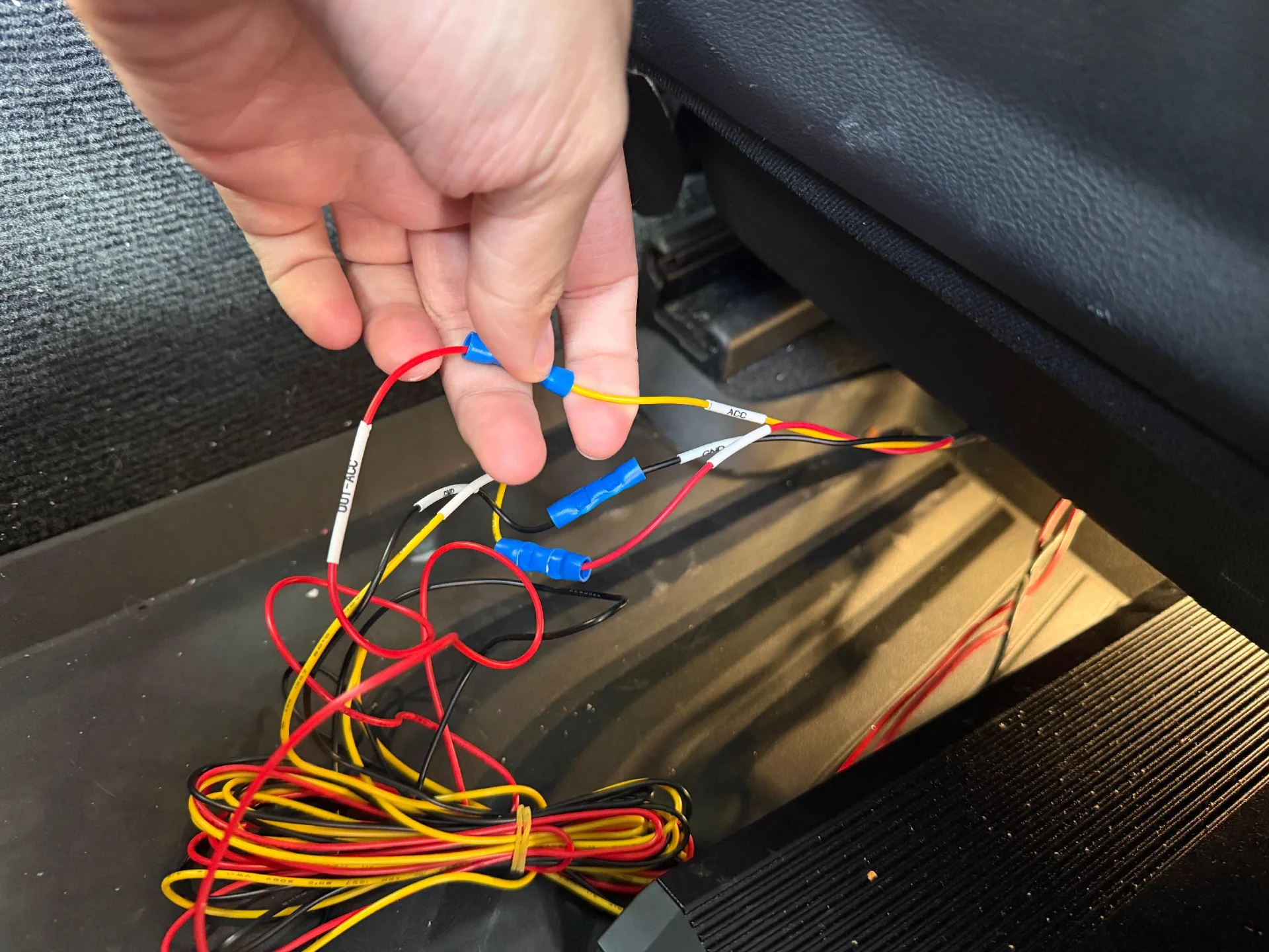

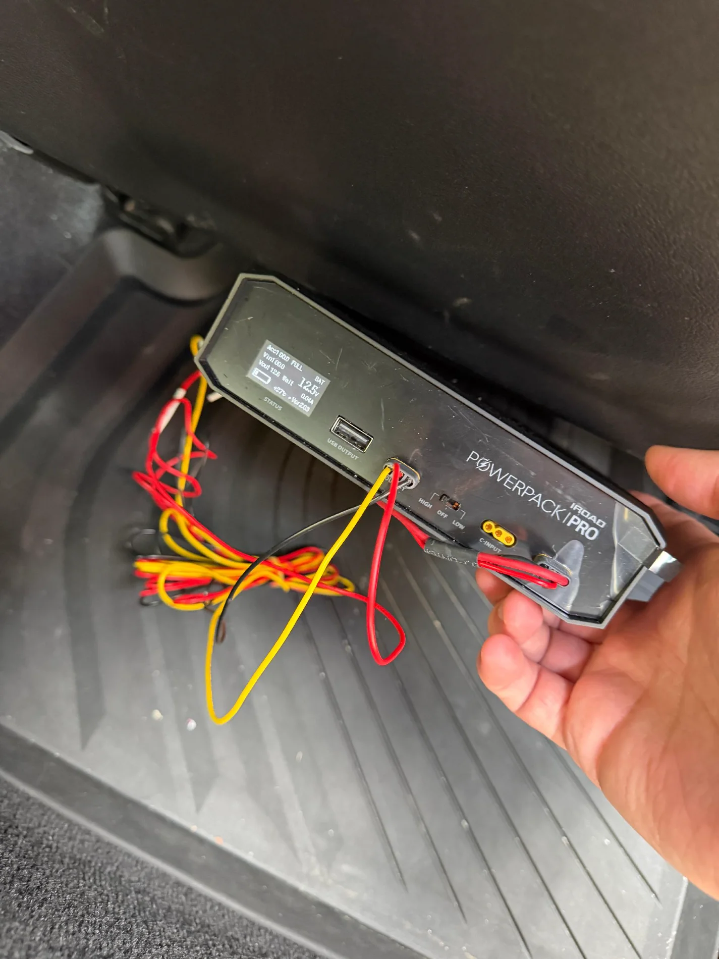

I have my HK6 set at 11.8v and connected to the iroad powerpack pro 12 through the following;
Yellow (ACC) > red (Out-ACC)
Red (Battery) > Yellow (VCC)
Black (Ground) > Black (Ground)
*Please see pictures for verification.*

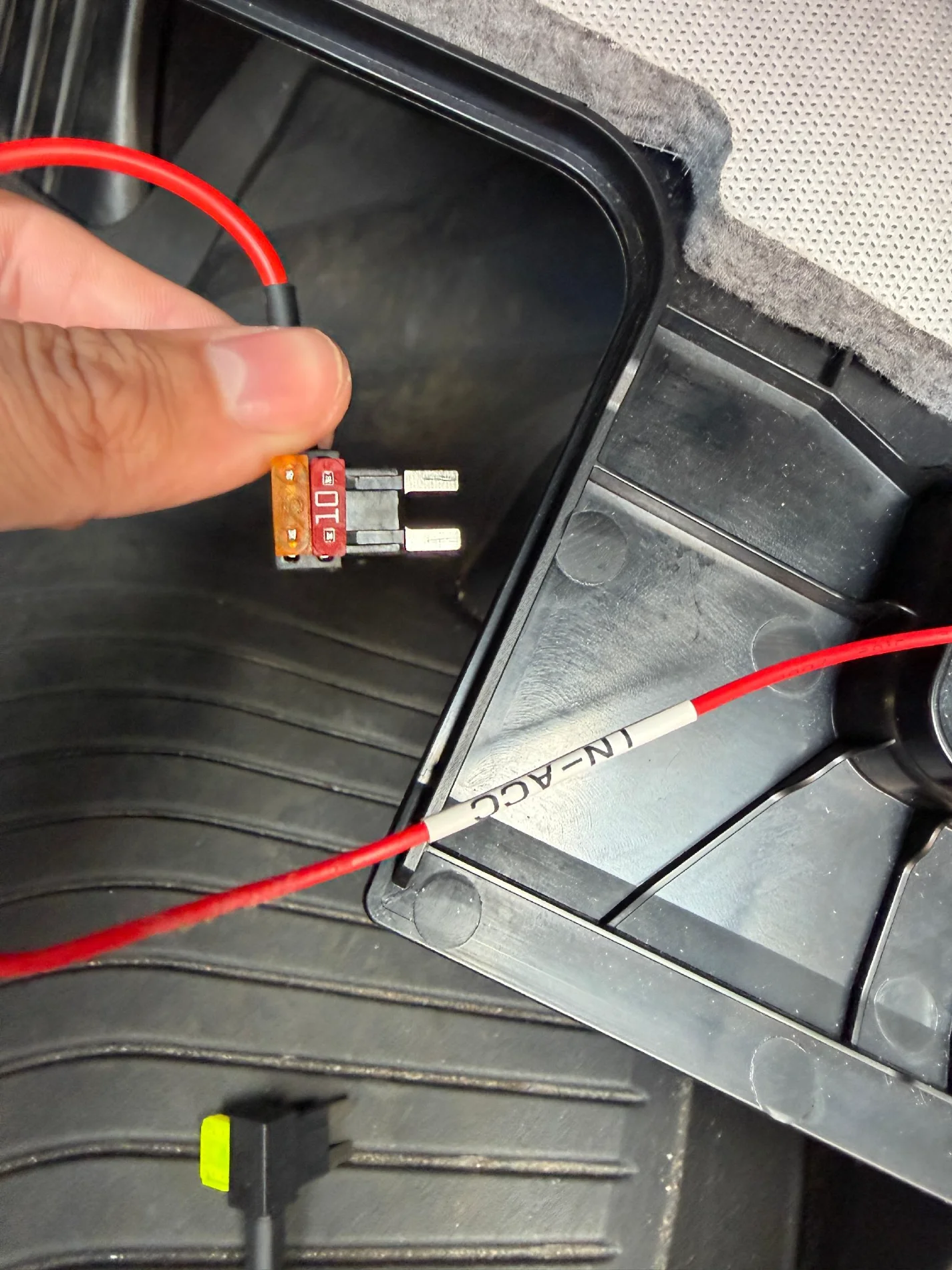

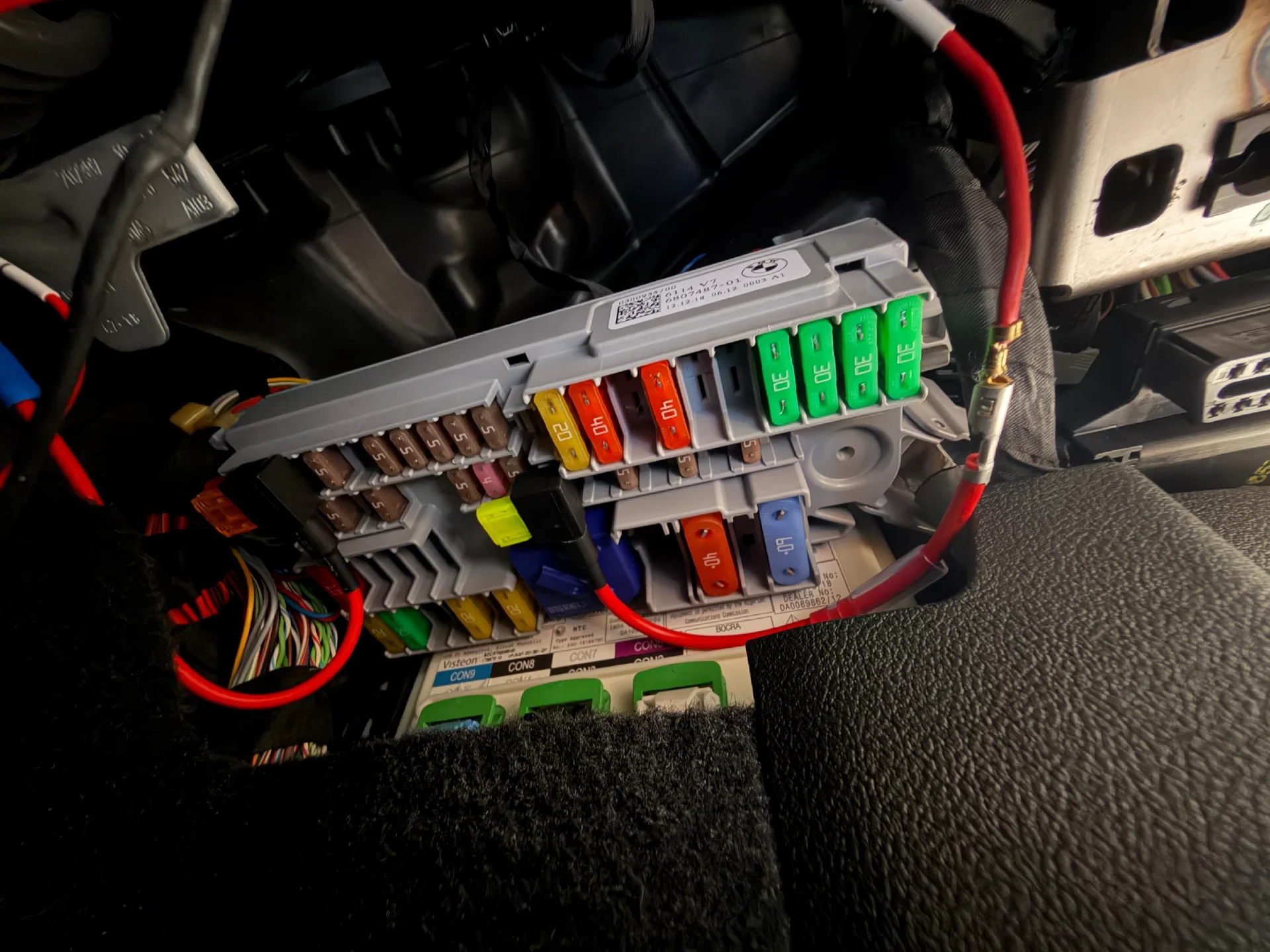

I then have my VCC Fuse tapped into fuse 38 (always on) and my IN-ACC fuse tapped into fuse 74 (USB - Ignition) - It was previously 71 - ambient lighting but one of Viofo's suggestions was trying a different accessory fuse.
When the car is running and the ignition is turned off, the camera remains in parking mode standby (through the icon). I read somewhere about taking out the accessory fuse whilst the car was running to see if it activated so after trying that I could see the parking mode symbol pop up on my camera so that to me seems like it's not a camera issue.

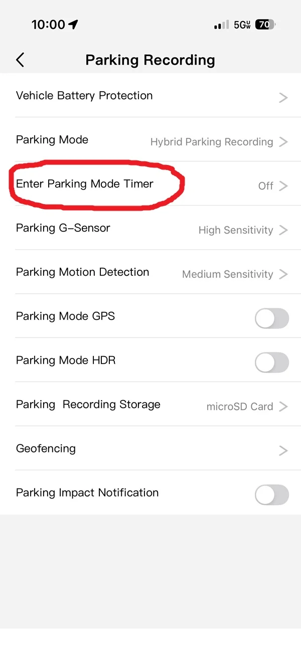

Have you tried to use a hand over delay, so the camera would continue in normal mode after you left the car / slammed the DOOR ASO to not generate false events doing that.
But maybe if the car smarts get a little time to settle down before the camera do something.
I think this selectable delay is often 60 or 90 seconds if it is there.
I can not recall what it is called in Viofo cameras as sadly i have not been privy to sampling their systems lately

The A329S setting is Enter Parking Mode Timer and adds a 90s delay when turned on:

Thank you for the reply. As someone has mentioned, there’s a 90s timer delay which I have tried (should have mentioned that in the post sorry!). However, I think I’ll keep it on regardless as you make a good point regarding door slamming etc.
I’ve had a good look around and have found that a fuse in the rear of the car (not ideal) does in fact turn off instantly. I’m just looking for a suitable fuse to tap into for the battery power then muster up the courage to test it out (which includes a whole lot of rewiring!).

2017 Bmw x5 as i have the same setup as you
Hard wired a329s 3 ch with hk6 and iroad 12 pro.
Found a fuse at trunk that is on when car is on but goes off when car goes to sleep u must wire to that one or other where power goes off so this way parking mode kicks in
