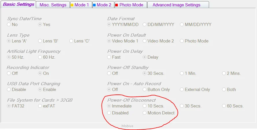

I just noticed that mSetup (latest version 4.0.9.1) for the M2 does not have an option to control the 'Power-Off Disconnect' variable, which it does for the M1, so you cannot set the M2 to "immediate" for capacitor operation. Am I missing something? Currently using a battery in my M2, and it does turn off automatically when external power is turned off. I'm sure I set this parameter some time ago on my M2???
Mobius 1 Settings:

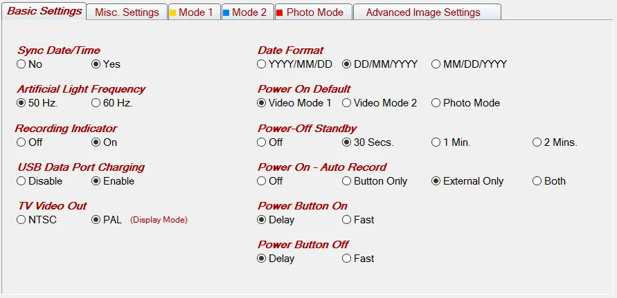

Mobius 2 Settings:
There has never been a 'Power-Off Disconnect' parameter for the Mobius2.
So long there is a battery or a supercap in the camera the last clip will always be saved when you disconnect power, even if 'Power On - Auto Record' is not set.

I took the battery out of my M2 and replaced it with the capacitor tonight. Initial testing showed that the camera was not saving the last file properly after disconnecting external power, resulting in a video that could not be viewed. I played around with a few mSetup settings, and found that "Power-Off Standby" needs to be set to "Off" when using the capacitor. Otherwise it appears that the camera tries to go into standby, and runs out of power before saving the last file. It seems obvious in hindsight, however an extra note on the mSetup "power-off standby" tooltip might be worth adding to aid anyone using a capacitor.
I'm glad I tested the M2 at home with the capacitor installed before taking it back out to the car.
