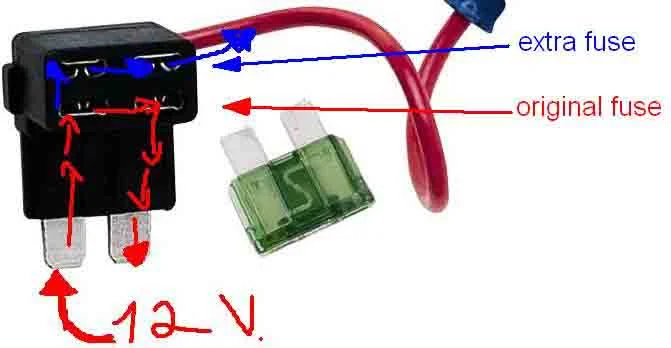

VW electrics certainly are different . I have a Polo and a Passat. My cameras are HARD wired by hand LOL and run off spare fuse slots that arent being used for anything. Have been going OK for 4 years so must be doing something right Your Celllink can be wired in the same way as most VW have power to one side of the spare slots and you can fit an addadfuse and just put the fuse in the top slot and run your battery off that.
If you dont understand what I am meaning Print it out and get a sparky to wire it up

Wiring it up using a add a fuse if easy as it's how I did the pmp
I used the cigarette lighter fuse for the Acc and the towing electrics fuse for the constant
Not like I am ever going to tow using a golf R lol
As the cellink b only needs a ground and a Acc I will just use the same cigarette lighter fuse
My main question regarding chopping the plug off the bv650s was just to make the install clean and tidy as the cellink b female plug is very short approx 10cm long so would be close to the cellink b in the glove box I have looked to see if they sell a longer version but no luck finding one
