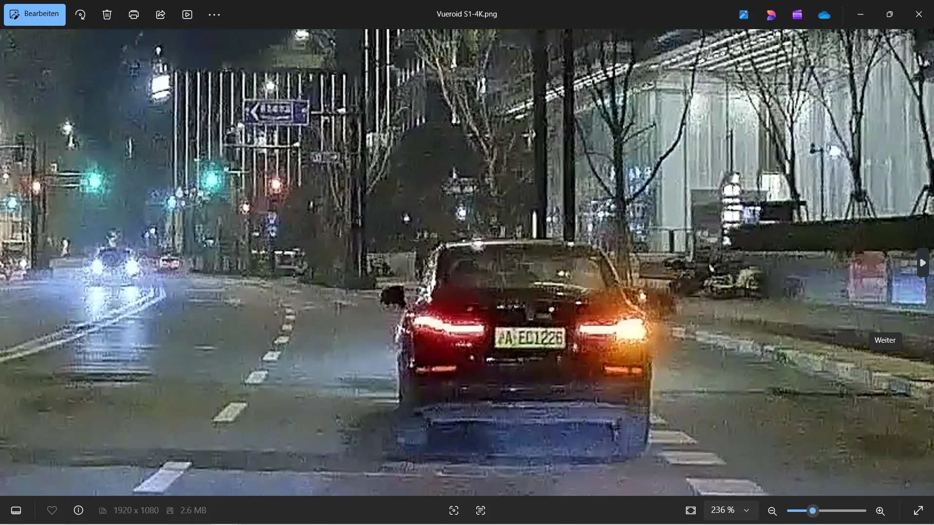

Compare the some dashcam to take the license plate, S1 4K 70mai A810Pro ELITE 10 A329WW
That's right.
The screenshot from the Vueroid video was taken when the car in front was closer to the dashcam, compared to the screenshot from the A329.
This is visible from the red sign on the right side of the wall.
Furthermore, the Vueroid screenshot was enlarged before publication.
if u want i can send u all video
u are
The images seem cropped from the original full size capture, which won't affect the comparison.
But without showing the original full screen capture image it can appear that way.
u are right
I'd love to see it.
I don't have all the models you have, but comparing videos from my A329T and Vueroid,
I can confidently say that in a situation like the one in your screenshots, the A329 can't perform worse than the Vueroid.

I know some people will question this result, and the same is true of social media in China. I am still editing the whole video. I will send you the original picture. I am a dashcam lover. I don't need to fake this view I sent it to viofo officials, and they admitted that the optimization was insufficient

You don't need to send me anything.
My comments have nothing to do with countries.
I just like seeing pictures that haven't been edited when they are trying to compare the products thats all.
It just my view on how to do something with the same baseline for all of the cameras.
I try to do something like this:
Grab a still shot of each dashcam at exactly the same place and point in time and post them without cropping them.
If the review is of just one camera and not a comparison then cropping the photo should be fine.
You have a very clean windscreen too 🙂
Your photo of how you have the dashcams installed remind me of a spaceship. To get a better comparison it does really matter where the dashcams are posisitioned. Placing the lens of each camera in line will help with your comparisons.
The wiring reminds me of the mess I make in my car with wires going all over the place.
I think my comparison will be more accurate.
The difference may be due to the device and software used to view the video and take screenshots?
I think you are using a windows PC, whereas indigo is using a mobile phone
I play the video in my mobile phone and then use the screenshot and then enlarge the screenshot.
Correct - viewing on a mobile phone compresses the video due to a smaller screen resolution.
Then taking a screenshot of a compressed image compresses it even further.
For example - the Vivo X200 has a resolution of 2800 x 1260, whereas the raw video is 4K at 3840 x 2160. So you've already got almost 50% compression just by viewing it that way.
Best to view in it's native resolution on a 4K TV or 4K capable PC to see the raw comparison. Then any screenshots will retain the original image.
