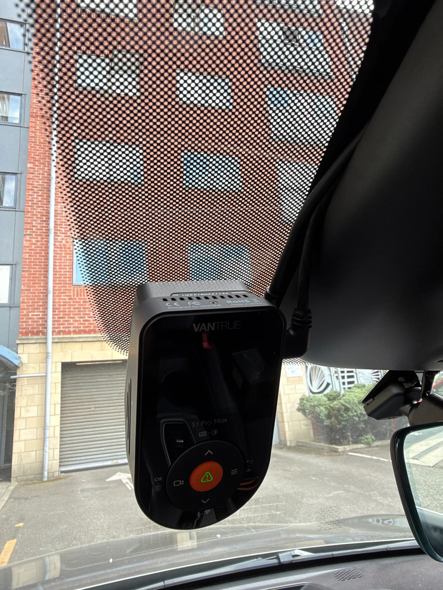

Nice job on the install! Some people have found the rear camera prone to some bounciness due to the accordion mount (I never had this problem). If you notice this (it is subtle), there are several easy solutions: Tighten the screws in the mount, tuck the cord into the headliner or under the trim to help hold the camera steady, and/or add a layer of 3M Very High Bond between the mounting plates. In addition, you can also use some Fun Tack to add a rectangular Viofo polarizer to the rear camera to cut some glare. I've done this and fount it to be a worthwhile improvement.

I’ve tightened the screws and will keep checking. Yes I noticed the glare on rear cam i.e where i was parked so yeah adding polarizer to rear cam will be handy.

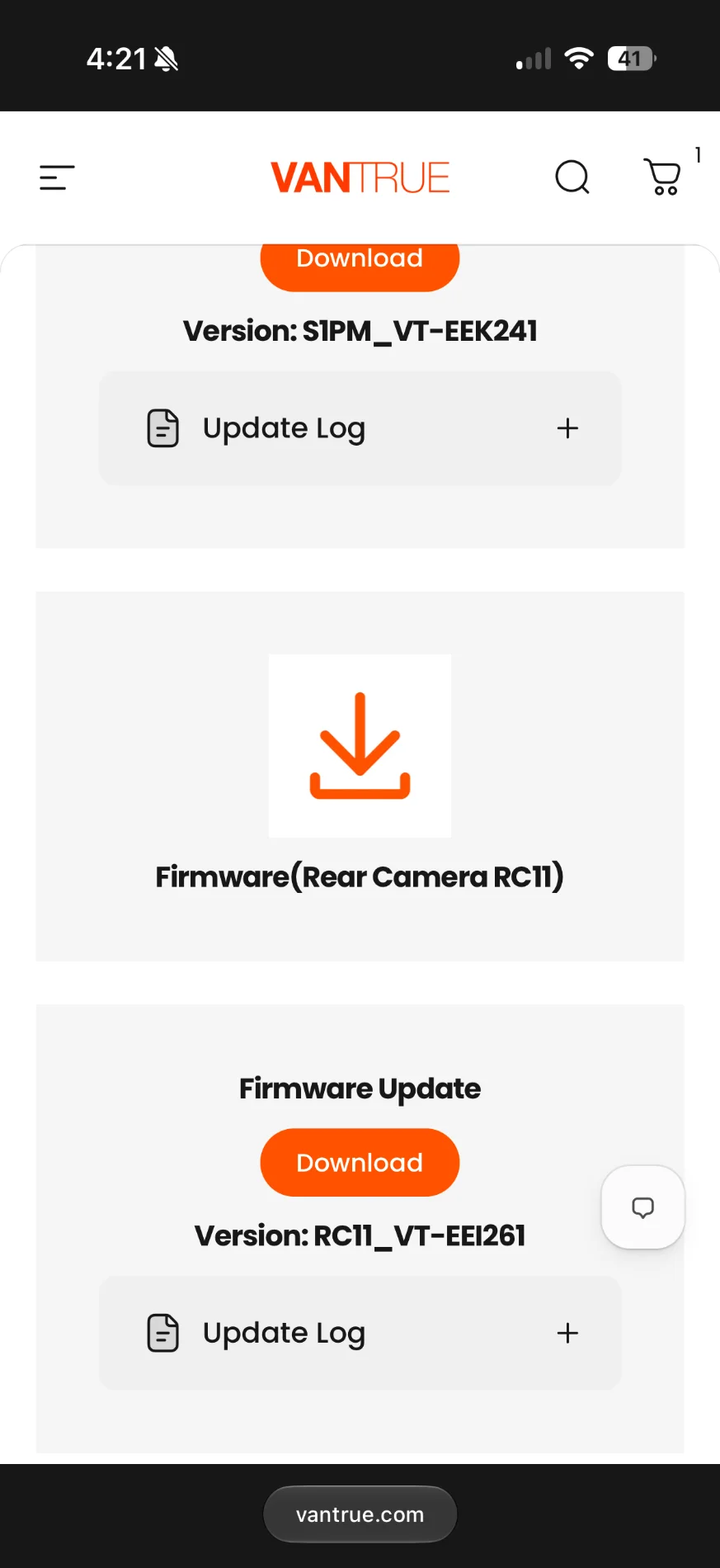

Current software:
Are these the two i need? Do i need to update them individually or can I download on same SD card at the same time?
Current software:
You have to update it individually. Should be able to update the dash cam via the Vantrue app. Is it necessary to update? I usually say yes, especially for initial setup, best to get it up-to-date during the installation process.
The real trick is picking the correct firmware for the rear camera. There are several rear cameras that are compatible with the S1PM. You have the RC-11

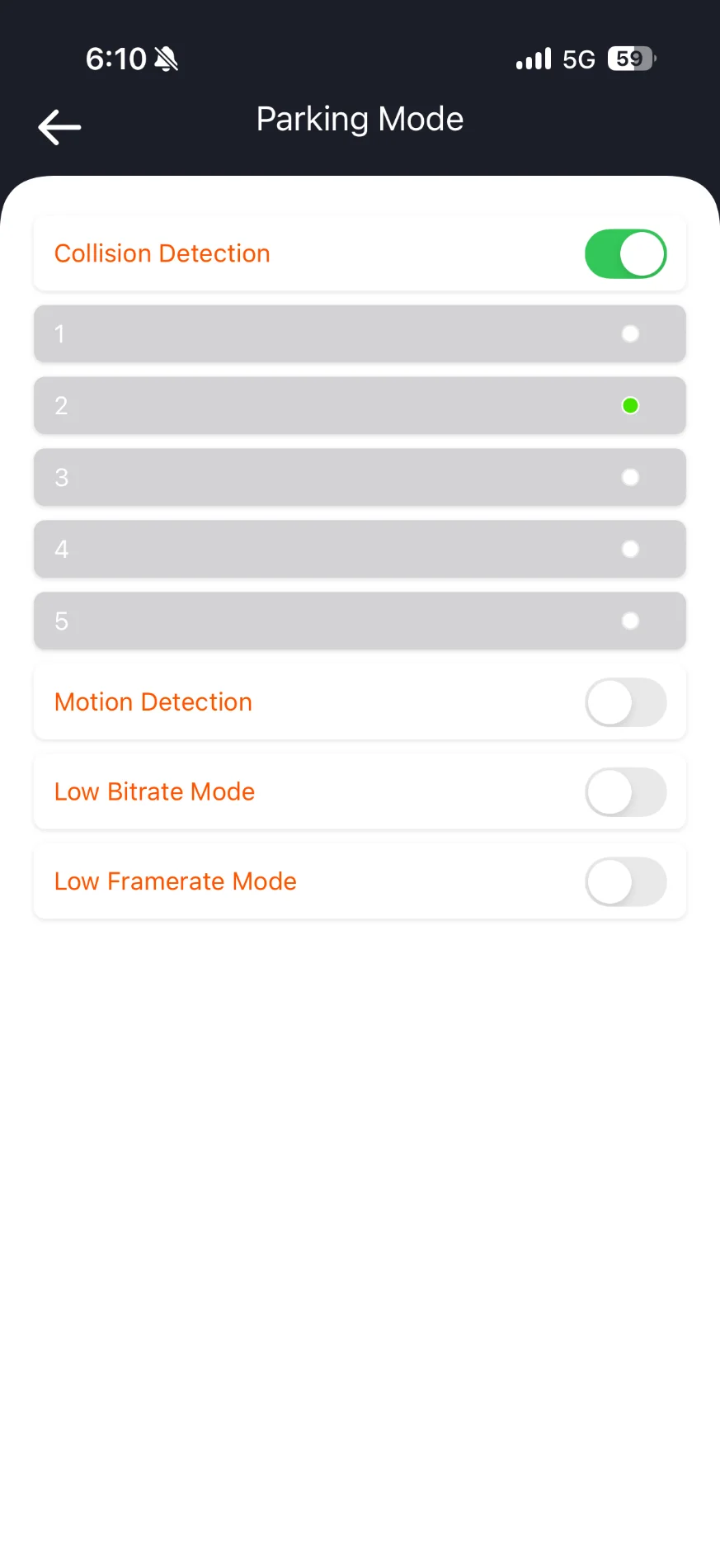

Am i only allowed to pick one?
Yup, mutually exclusive… most people here seem to choose Low Bit Rate, but that will consumer your car’s battery more quickly. LBR is typically the highest power draw parking mode. When you are ready for a dedicated parking battery, there are other threads here that will help you out😁
Hahaha. Im not there yet. Maybe in a few months time LoL.
For now I'll stick with Collision Detection which seems to be logical choice unless you think Motion Detection will be more beneficial.
