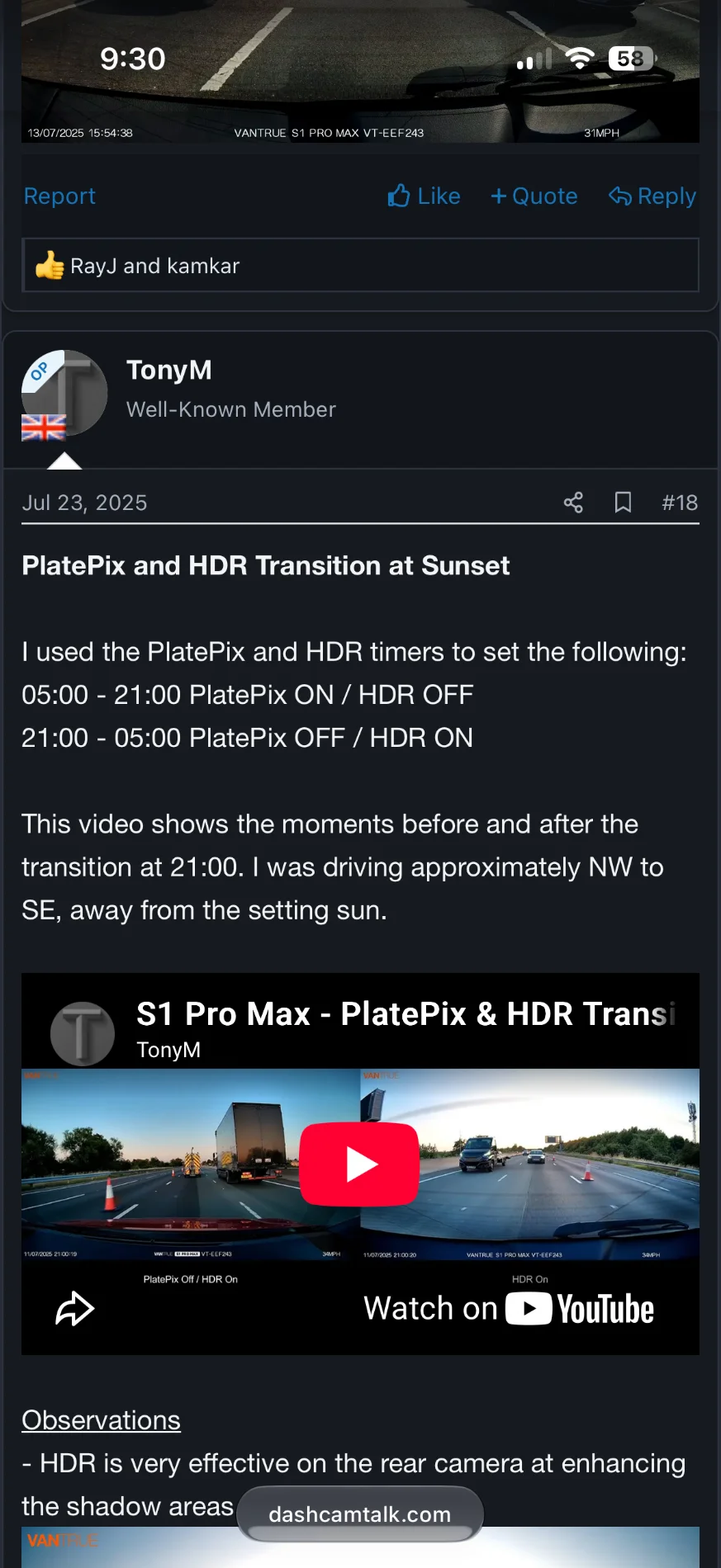

@TonyM These settings do they even work?
Plate Pix for me doesn’t work without HDR? Unless its working just the stamp is not showing on the videos?
@TonyM
I believe the firmware has changed since I posted that. PlatePix might now need HDR to be enabled. @Jeff_Vantrue can you confirm?
Yes, you’re right. With the latest firmware, PlatePix requires HDR to be enabled in order to work properly. Please turn on HDR to use the PlatePix feature.

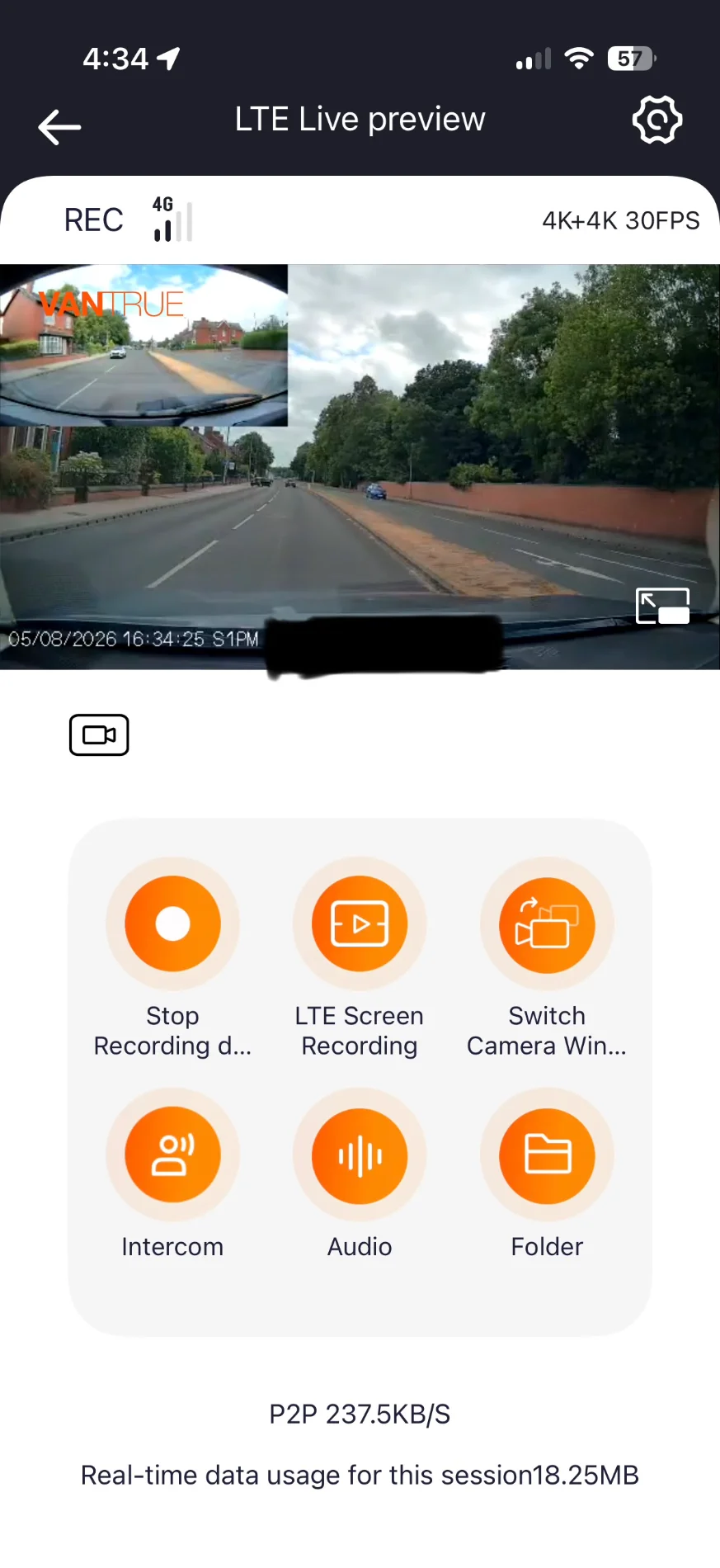

I now have an LTE module installed, thanks to a member here.
Setup remains incomplete because I am still waiting for my SIM card to arrive.
I also spoke with Vantrue customer service about the ordering and shipping charges I encountered last month; they confirmed a system error and noted that shipping should have been free. By the time they responded, the offer had expired, leaving me no choice but to keep my Amazon order.
Fortunately, they provided a partial refund on my Amazon orders for the inconvenience. It is not as good as the discounted deal they had offered, but something is better than nothing. A big thank you goes to Angel and Likki.
Slowly but surely getting there.
Again a big thank you to everyone in here for their help, support and guidance.
I will keep you posted 😁
Its up and running.
