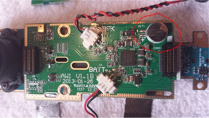

I see that the battery marked in the attached picture has gone bad.. It has some green color corrosion on it. So does any one know what is the rating of this button cell and is it rechargeable one.

I find myself lazy sometimes and decided to delve into this power-supply board and find out what it is.
Unfortunately, the manufacturer offers no clue as to what this tiny battery is as it has no markings and once the battery has died, it's impossible to measure it directly.
In an attempt to offer something back to this community, here's what I've found.
The + side of the battery is charged from output 6 of an Active 8810QJ power management chip. Output 6 is designated for the RTC circuit (real time clock). This is a programmable output voltage which I've determined to be 3.36v.
This output is modulated to a maximum output of 30mAh.
Essentially, this small battery is a manganese lithium 3v rechargeable battery. The RTC used on this camera is a Maxim DS1337+ and has a current requirement of between 200 and 500nAh. This mean that a 5mAh battery will maintain the RTC in backup mode for approximately 1 year without being powered on. The spacing on the PCB pads is exactly 1.5mm.
@kamkar is 100% correct in saying the MAH rating doesn't matter, however, so long as the maximum charging rate doesn't exceed 0.12C for the battery.
Here is a perfect high quality replacement for the generic battery.
https://www.digikey.com/en/products/detail/panasonic-bsg/ML-621S-DN/278835 <------ if the link doesn't work, search for a Panasonic ML621S/DN. ML621S/F9D to be exact with the tabs.
This battery is 3v, 5mAh, 6.8mm wide and has a tab spacing of 1.5mm and fits perfectly.
The above fix will put it back to factory specs if you're happy to occasionally replace the battery as Cowon has made an engineering mistake on this board that will definitely reduce its life span.
Error #1 - They are charging the tiny battery at 6C which is 50X the .12C standard charging rate suggested for manganese lithium cell batteries. 30mAh is WAY too high and should be in the 600uAh range.
Error #2 - Manganese lithium cells should never be charged above 3.1v and they are 0.25v higher at 3.36v.
Either of these conditions are detrimental to the life of the battery and together perfectly explains why they are releasing the green goo after a year or two.. Possibly sooner if the battery is allowed to get too low.
I will be modifying my board with a series resistor and a voltage dividing circuit to exactly 3.1v and .6mAh as suggested by the manufacturer. This will provide me years of trouble-free service.
If anyone is interested I'll gladly post the upgrades here, but I doubt there's much interest in such an old design.
