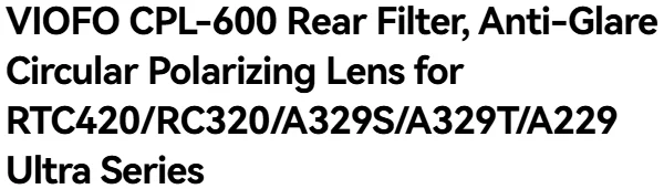

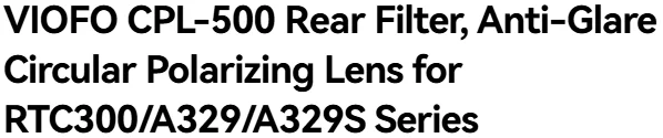

I find it difficult to determine which filter is needed for each camera. The text "CPL-500 Rear Filter" and "CPL-600 Rear Filter" implies that both of these are suitable for the REAR camera of the A329 / A329S series.
Is the CPL-500 just for the RTC300?
For the camera in the first picture you will need the CPL-500 and not the CPL600
Reason for that as far as I know:
The A329-Rear-Camera had a design without cooling vents
The A329S-Rear-Camera has a design with cooling vents
But for the early batches of the A329S 2CH Viofo still used the old Rear-Camera-Design (I suppose they had that still in stock and used it up) and that design needs the CPL-500
Regarding quality there is no issue with that. It is the same sensor and lens and same quality. Just different housing-design.
As far as I know they switched the camera housing to the version with cooling-vents because they use the housing for newer rear-cameras now in general.
And the 4K-Rear-Cameras like the A229 Ultra actually need the cooling vents while the 2K-Rear-Cameras don't need it.

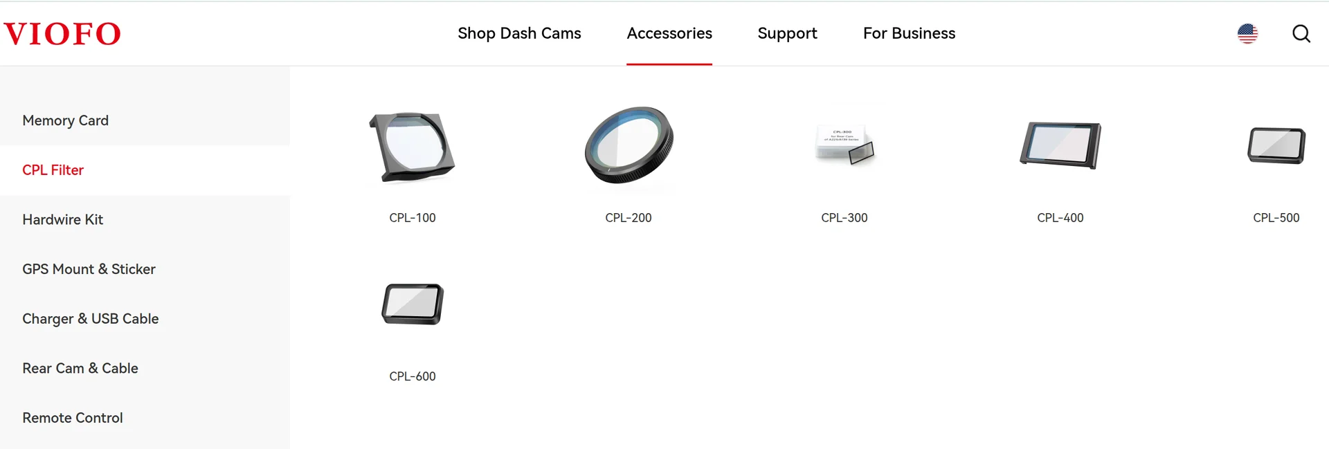

(-2020) CPL-100
(2021) CPL-200
(2024) CPL-300 / CPL-400
(2025) CPL-500 / CPL-600
(2026) CPL-700 / CPL-800 / CPL-900 / CPL-1000 / CPL-1100 / CPL-1200
I’m not following, what could be easier than memorizing all of this? lol
