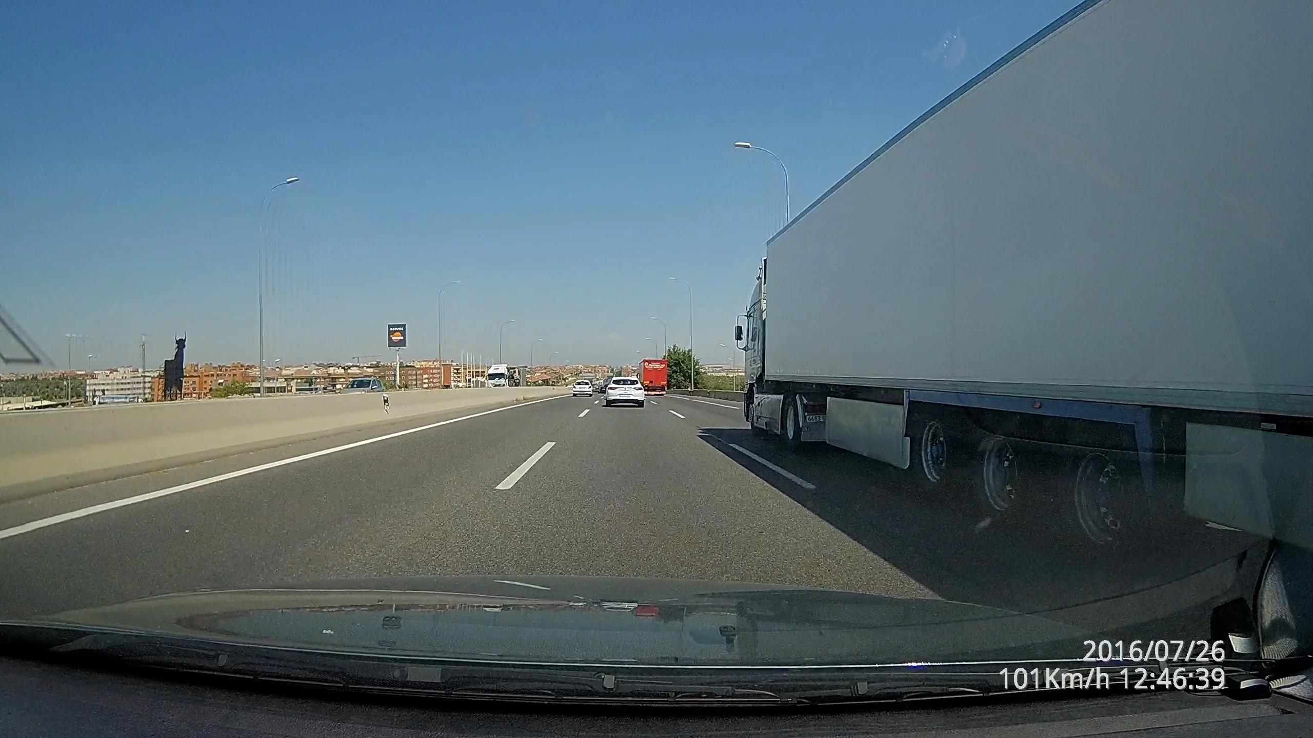

These are two captured frames, with Superfine and Fine (both on the highest resolution and HDR mode)
You can check the difference in quality looking at the artifacts in the streetlights.
The first image is Fine, second one is Superfine.
I'll stick with SuperFine.
Waiting for an ExtraSuperFine. ;)
