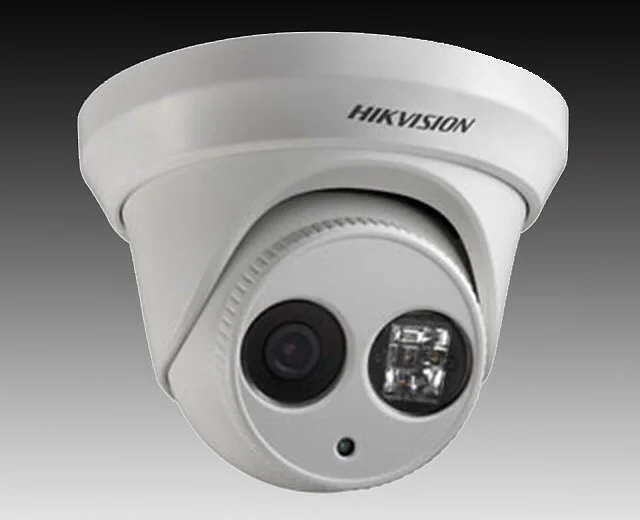

The OP expressed a need for outdoor use and night vision so I was going to say that the first type of IP camera GJHS recommended was not a good suggestion. The 3MP dome camera suggested afterwards is a much better choice (The HIKVISIONs are excellent), but it is far more complicated than just buying a camera. The camera is only a small part of the system as it needs a stand alone DVR/NVR or network support to a desktop computer to function. Usually, one camera is not adequate for most set-ups and the user soon finds that they want or need to expand to more cameras. The Blue Iris system is also excellent but there are drawbacks to using something like that especially for someone just starting with their first security system. The problem with software based camera systems is that they use a lot of resources on your computer and really need to be run on a dedicated machine for optimal performance and data security. They can be more complicated to use and the average user trying to turn their home computer into a surveillance system will run into many hassles and will also need to have the ability and willingness to run their computer 24/7. A constantly running security camera or set of cameras puts a lot a wear and tear on a hard drive and the last thing anyone should do is risk their important data on their primary computer to something like that. Of course, the other main concern is that a constantly running CCTV camera is going to need a lot of hard drive space to store the data and this is not practical unless you can mount another hard drive in your box. From longtime experience I've found that a dedicated stand alone DVR/NVR with it's own hard drive is a far better way to go and is far more reliable and safe. In fact, just this evening I needed to shut down my computer and network because of a thunder and lightning storm but I left the protected and isolated CCTV system running.
