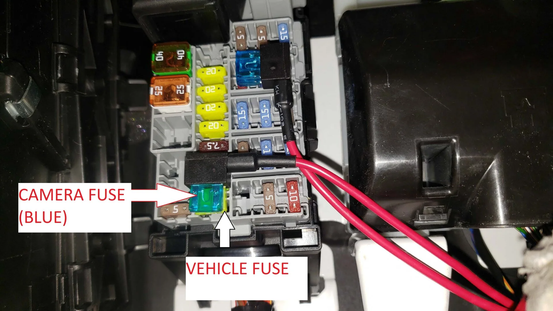

Here is an Example of a Hardwire. One of the fuse taps is for Accessory (Fuse Active When Car is Turned on) and another for Battery (Fuse active both when car is on and off). The vehicle fuse always goes to the bottom of the fuse tap. Fuse to protect the circuit up top.

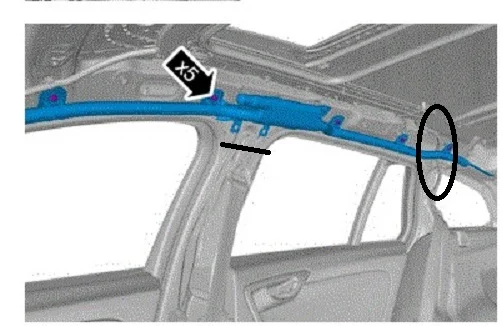

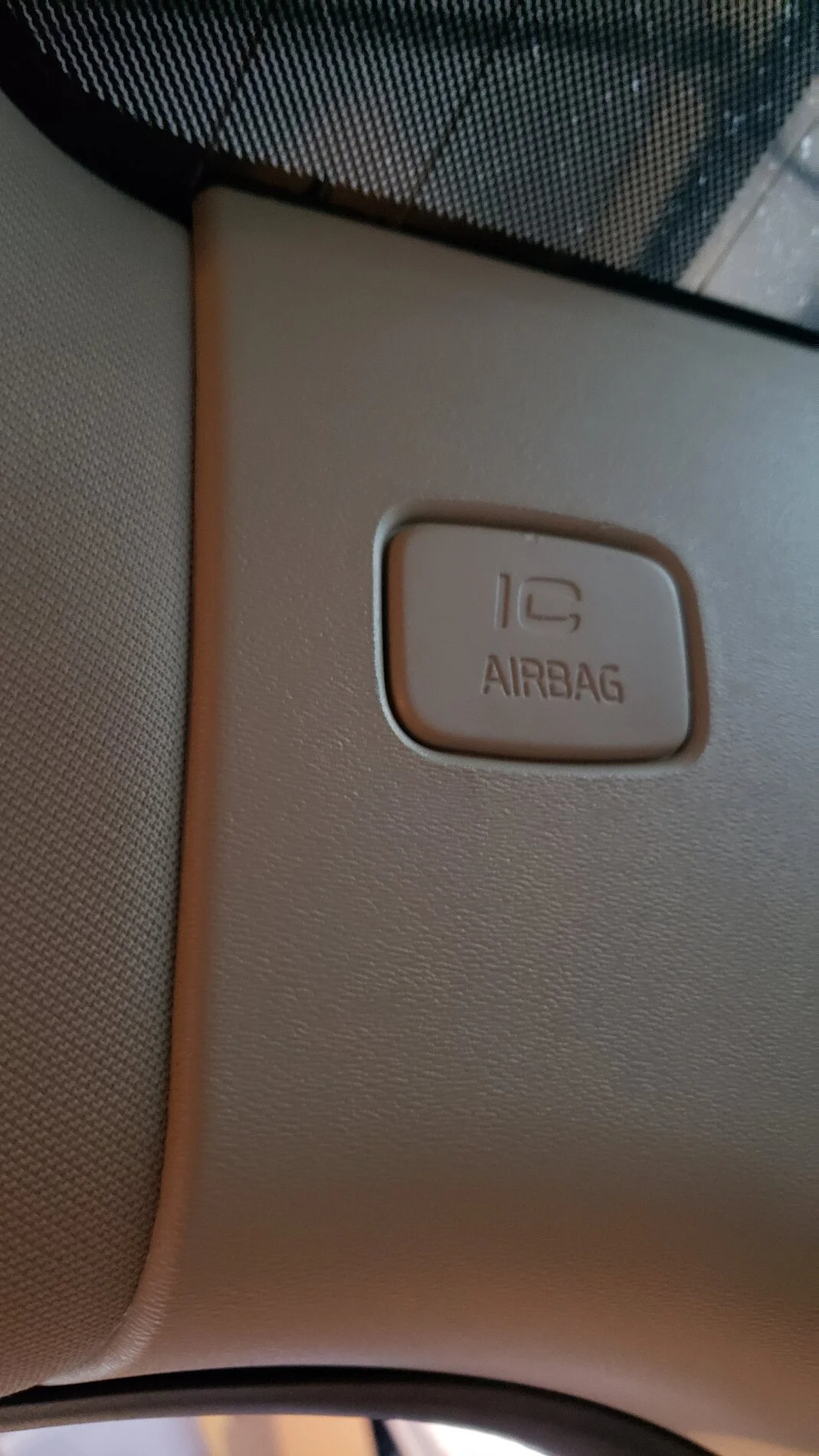

Installing a 2 Channel Dash Cam (Front + Rear) in a modern vehicle.
On New Cars, you cannot safety "Tuck Wires". Wherever there is a a Side Curtain pillar, the pillar needs removed to tuck wire behind or out of the way of that curtain.
As you can see in this example where the circle is at is a curtain. If you Tucked it into the Groove, it would cross over that curtain and obstruct the side curtain deployment in the event of an accident. Requiring you to remove that pillar and routing the wire BEHIND THE CURTAIN instead over overtop.

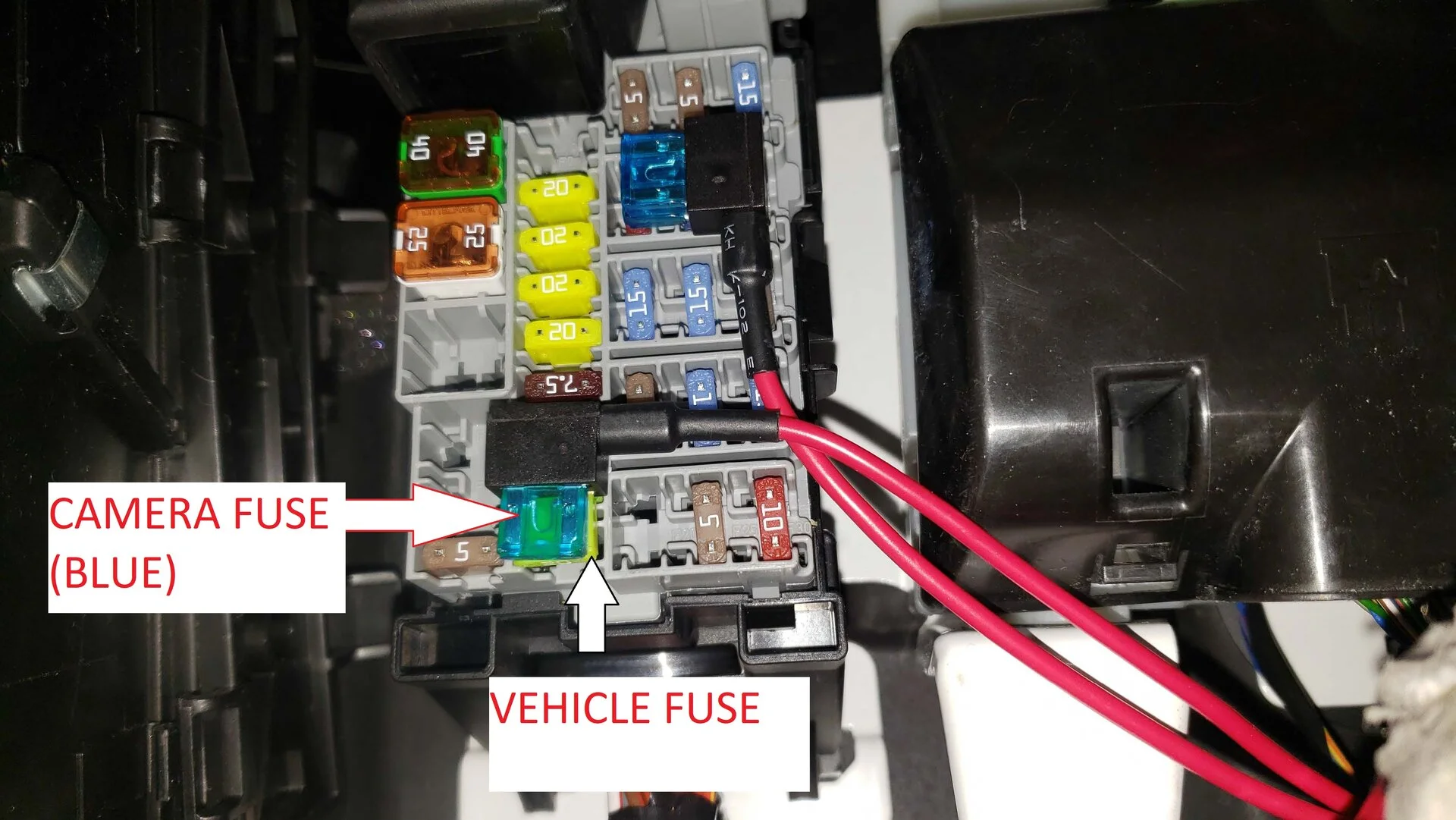

Thanks ... interesting fuse option.
Without the parking mode, if I just want rear cam option, do I still need to go to car fuse ?
Yes the fuses adapters ( piggyback fuse adapter ) you still need if you want to be able to use parking guard..
The type of fuses in the picture is what all cars use nowadays, but they do come in a few different tupes / phuysical sizes, so you need to know what kind your car use ( look up ATO fuses there are charts where you can see the different types )
The rear camera are powered by the front / main camera, this can be thru a USB cable that also move the data, or some also use a coaxial cable that though just 1 wires transport both power and the video data.
USB are the most common cable type to rear cameras
Per @kamkar
The rear camera needs power. You can either run two individual cameras and both would need a power source (12v socket, hardwire, or battery pack) or you can run a single Front + Rear Setup. Where the front camera supplies the rear with power based upon those 3 power sources. Or on a Front + Rear + Interior Setup (3 channel) the front powers the rear and interior. I wouldn't necessary say a 3 channel is a great fit for Dallas. Because it will most definitely reach the 65C / 149F cutoff in a Texas Summer with the sun heating up the interior. So parking times would be pretty short.
Whereas a 2 channel setup would be "OK" and take much longer hot.
If you want parking mode, you must hardwire to the vehicle fusebox or to a separate battery pack.
Fuses these days are usually Micro or Mini. You can easily take a fuse out of your fusebox to a place and they can identify which fuse tap you will need with the hardwire kit.
On the Front ---> Rear Camera cable, be mindful of side curtains. Never ever tuck wires over the curtain. Like I said, they will prevent deployment in an accident as the wire can catch and prevent the curtain from deploying. So the wire must be behind or out of the way of the curtain.
