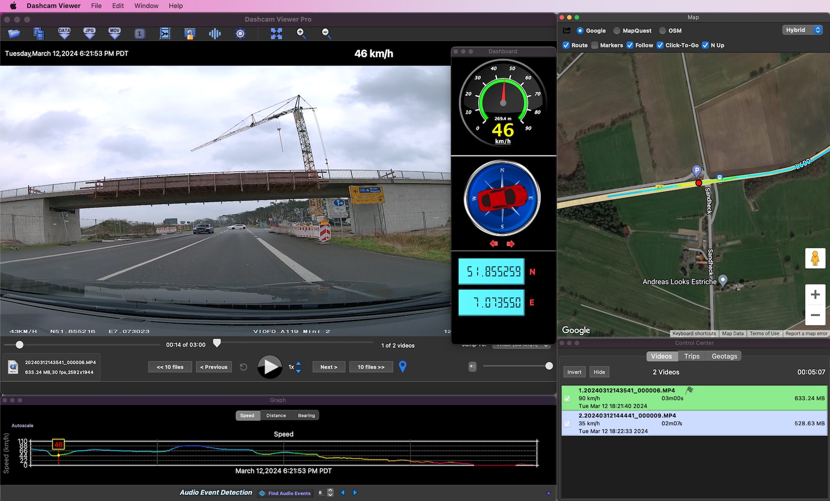

@Nedia, I tested my copy of Dashcam Viewer Plus v3.9.6 with footage from an A119 Mini 2 with firmware version v1.0_20231116 (latest available). The loading of the folder of videos (33 video files) took a few minutes and the popup panel that displayed the loading countdown would appear and disappear. After the 33 videos were processed, Dashcam Viewer Plus showed the map and the full route driven during that trip with speed info as well.

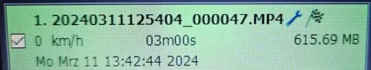

Hi John,I have send you 3 files from my Viofo A119 mini2 ,can you please see what could be the reason why no speed data and no map can be seen in the full version 3.9.6 on my Windows 10/11 PC?
All data was transferred from the Viofo A119 mini2 to the smartphone via WLAN and then to the PC.
I was amazed that with the perfect display (video + speed data) with the DCV, only the target flag could be seen. If the map and speed were missing in the DCV, a wrench could be seen next to the flag. What could be the reason here? See photo:
All data was transferred from the Viofo A119 mini2 to the smartphone via WLAN and then to the PC...
That's kind of important information. It's possible that the video files may have been somehow corrupted going from the camera to the phone then to the PC. Have you tried taking the memory card from the camera directly to the PC? That would eliminate that possibility.
John just told me that he had recognized the error. The solution will be solved with the update to version 3.9.7, he wrote to me, which I'm really looking forward to!

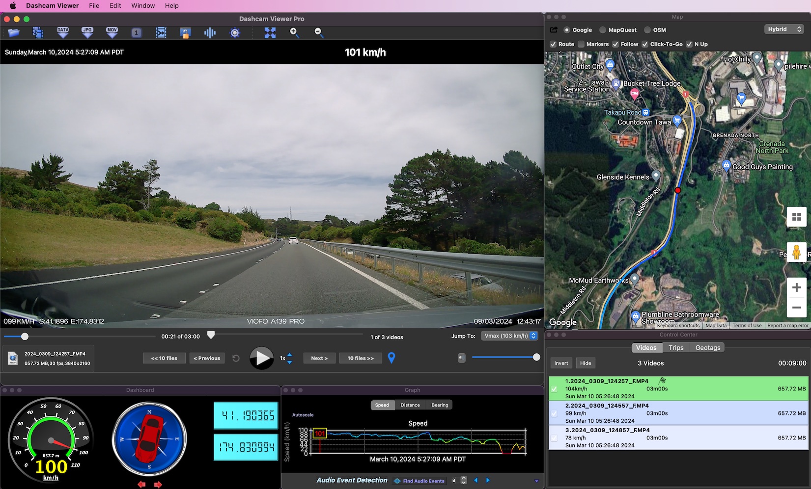

v3.9.7 was released today for both Mac and Windows. This release added support for three new models. Thanks to the users who provided the video samples.
New Camera Supports:
  • Added support for Viofo A119 Mini2
  • Added support for Viofo A139 Pro
  • Added support for Cooau D30
Dashcam Viewer v3.9.7 playing Viofo A119 Mini 2 videos with GPS data/map shown
Dashcam Viewer v3.9.7 playing Viofo A139 Pro videos with GPS data/map shown
