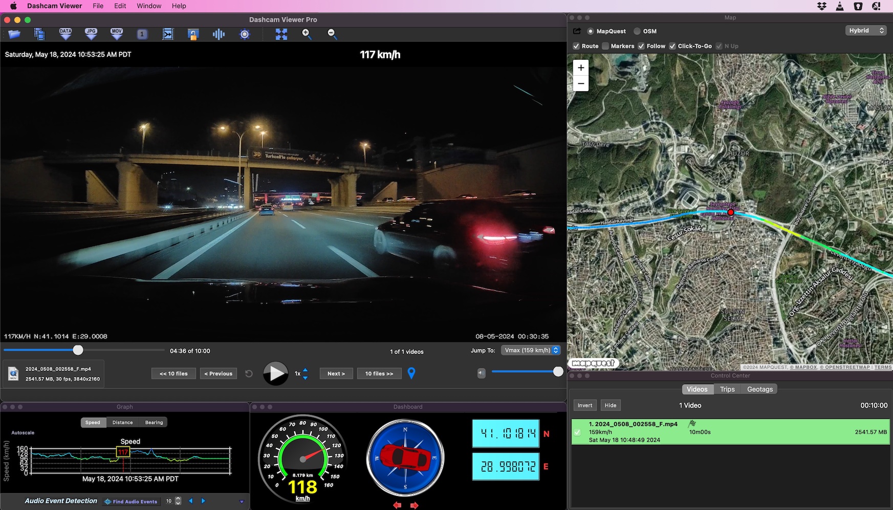

@Devedikeni Thanks for the resend. I downloaded your 10-min Viofo A229 Pro video and it seemed to work fine in DCV 3.9.7. I can see the GPS data as shown below. The problem could be that the cache is corrupted or some setting in DCV became corrupted. Please try the following

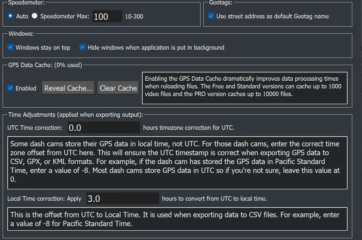

  1. Try clearing the cache (under Advanced Preferences). Then reload your videos.
  2. Try a hard reset as described here, the reload your videos

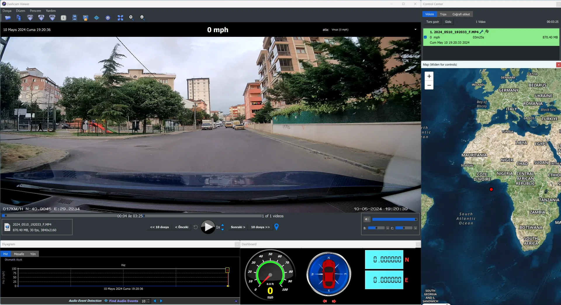

It's a bit hit and miss, the data is in the files but most of the times the map reports "Sorry we have no imagery here" if I then zoom out the map shows the red dot in the Gulf of Guinea (right under Ghana). Believe me I'm still in the Netherlands as far as I know.
Edit: I found the problem I think. It seems that the filenames are giving the problems, the filenames were e.g.: 20240515141018_000046.MP4, thus YYYYMMDDHHMMSS_######.MP4.
I renamed al files in Totalcommander as 01.mp4, 02.mp4 etc. Now ALL files will show the data in Dashcam Viewer.
So my suggestions is the the long filenames are giving the problems (?)

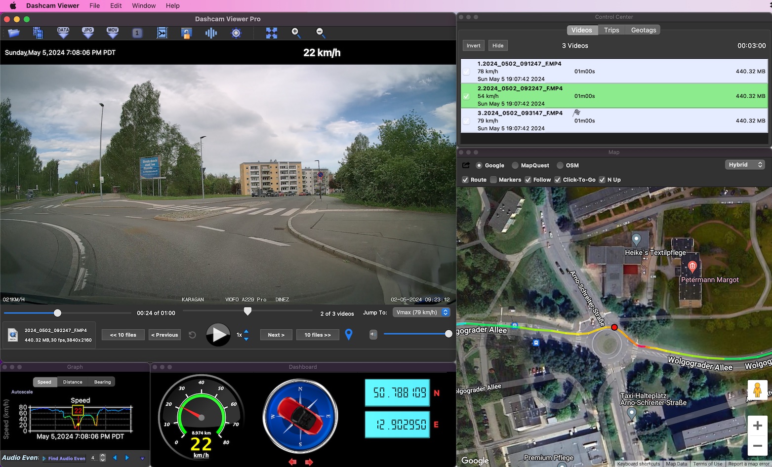

@Karagandinez thank you for the A229 (f/w V1.2_240227) front camera sample videos. I loaded these into Dashcam Viewer 3.9.7 and the GPS data was recognized. See screenshot below.
If you're still having trouble viewing the GPS data, please try the following:.
  2. Try a hard reset as described here.
John

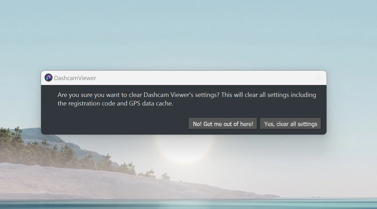

I installed Dashcam Viewer Pro 3.9.8. I applied the methods you mentioned above. My 10 min video did not process GPS data. Couldn't find the GPS location in the video.
1- I cleared the cache memory first.

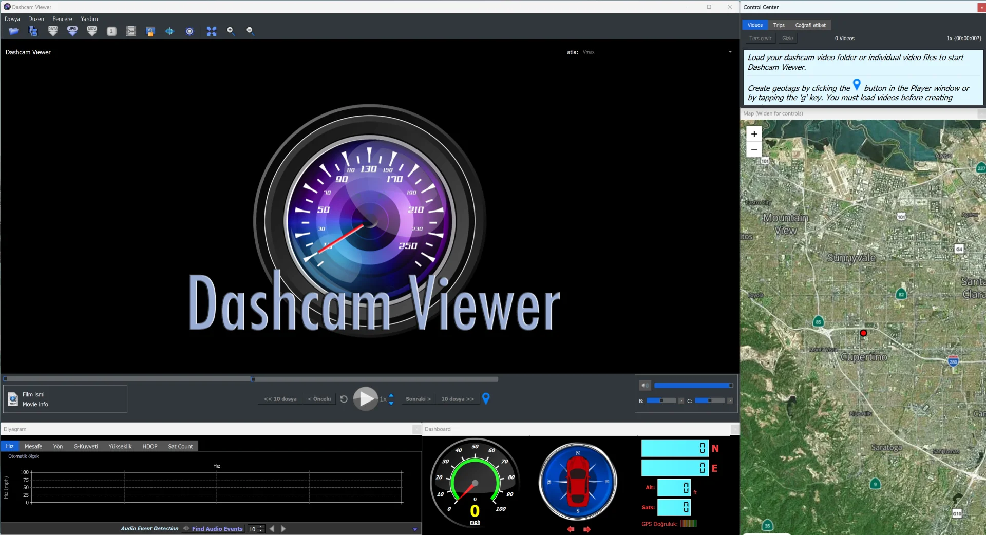

2 - I did a hard reset
3 - After the hard reset, Dashcam Viewer opened as below and the map appeared.

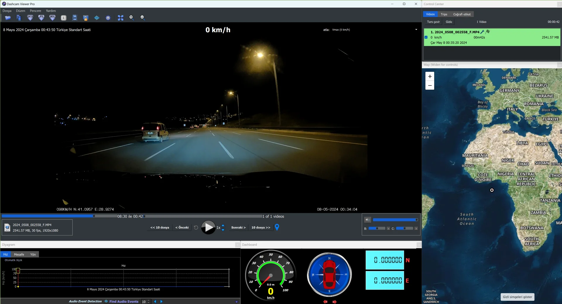

4 - After loading the video from the microSD card, GPS information did not arrive. The map pointer is positioned somewhere in the middle of the sea.
I uninstalled the Dashcam Viewer Application, turned on the computer, reinstalled Dashcam and repeated the same steps. Problem not solved.
I changed the dashcam viewer's language to English and followed the same steps. Problem not solved.
My problem is not solved but I thank you very much for your help.

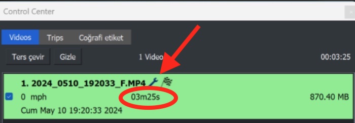

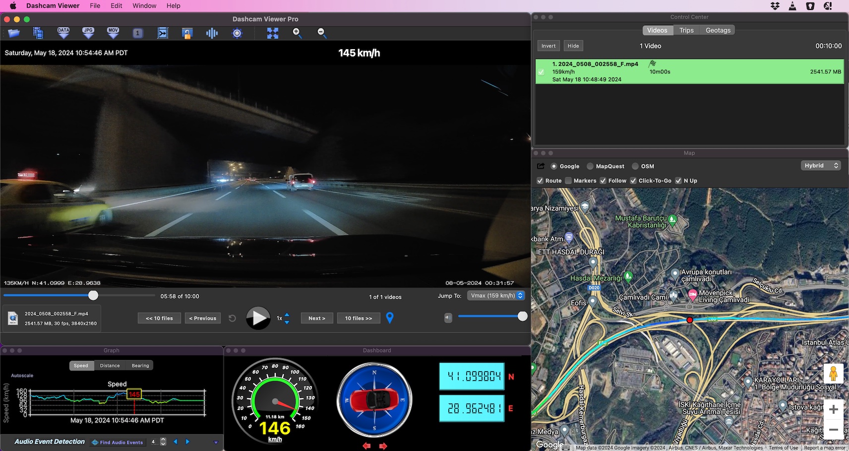

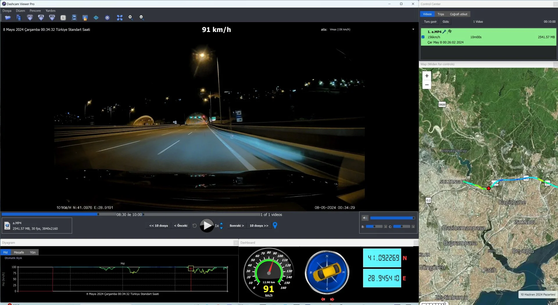

@Devedikeni See screenshot below. This is what I see when I load your 10-minute Viofo A229 Pro video into Dashcam Viewer 3.9.8. Everything seems to be working fine.
I noticed a clue to the problem you're having. In your last screenshot, the video duration is 3:25, not 10:00 minutes. Also notice the "wrench" icon next to your video filename. This indicates DCV found a problem with the data in the video. So perhaps this video is corrupt. Please try loading the 10-minute video you sent me and see if it works for you.
John

I also tried it in the video I sent you. GPS information did not work again. The map shows a fixed location in the middle of the sea.
There is also a wrench in the screen printout you send while working on your computer. As far as I know, the wrench icon is a toolbar used to stabilize windows. I guess it doesn't determine whether the data is corrupt or not.

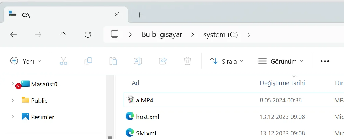

I named the file "a". I moved it to the "C" directory.

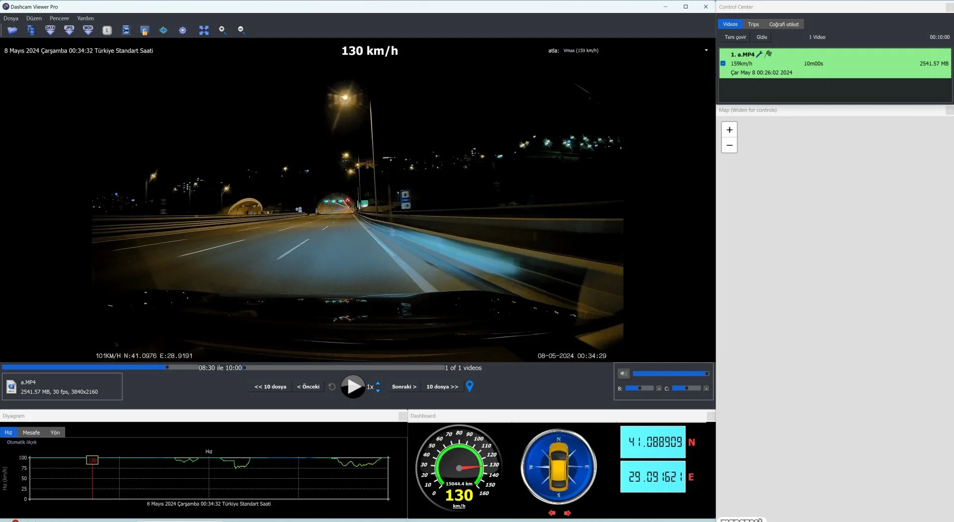

I opened the file in Dashcam Viewer Pro. Dashcam Viewer Pro displayed GPS information as below but the map view did not appear.
Using the "ExifTool" software, I created a "gpx" file with the same name as this file. These two files are shown below.
When "Dashcam Viewer Pro" saw the file with the gpx extension, it immediately displayed the map along with the GPS information. The latest situation is seen below.
Unfortunately, "Dashcam Viewer Pro" cannot display the map without a file with gpx extension.
