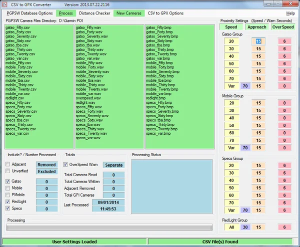

I have a similar program I supply that converts Garmin CSV files to GPX for greater control and can change dozens of files in seconds. As a result it does often have to be whitelisted even though I've digitally signed it

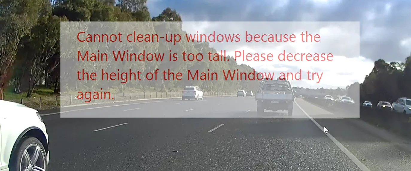

And option to "Clean Up" brings up this message. The program is running on a 4K monitor and it is set to
doesn't seem to fix it.
What does the message really mean? Oh and I have tried various size windows, that's for the peanut gallery.

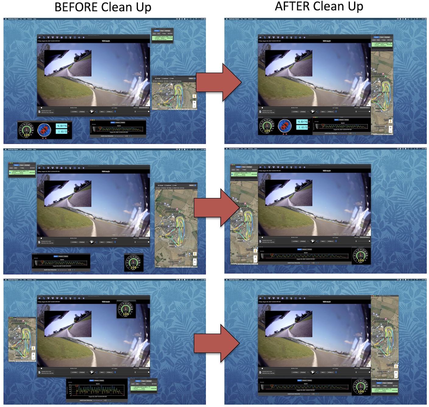

Great question. Regarding the "Clean Up" window option: Sometimes it’s useful to gather the ancillary windows around the Main window, without the Main window changing position. This is where the Clean Up function steps in.
To control whether the Dashboard and Graph windows appear above or below the Main Window, simply move the Dashboard window anywhere above or below the Main Window before selecting "Clean Up". Similarly, place the Dashboard window to the left or right of the Main Window to make the Dashboard clean up to the left or right.
The Control Center and Map windows will clean up to the left or right of the Main Window depending on where the Control Center window was before the Clean Up command was issued. Similarly, the Control Center window will clean up to the top or bottom depending on where it was relative to the Main Window before the Clean Up command was issued.
Here are some before and after examples of the Clean Up function.
The error message you observed was due to the Main Window being so wide or tall that the ancillary windows could not be "cleaned up" around it neatly. The fix is to shrink the width/height of the Main Window and then try the Clean Up command again.

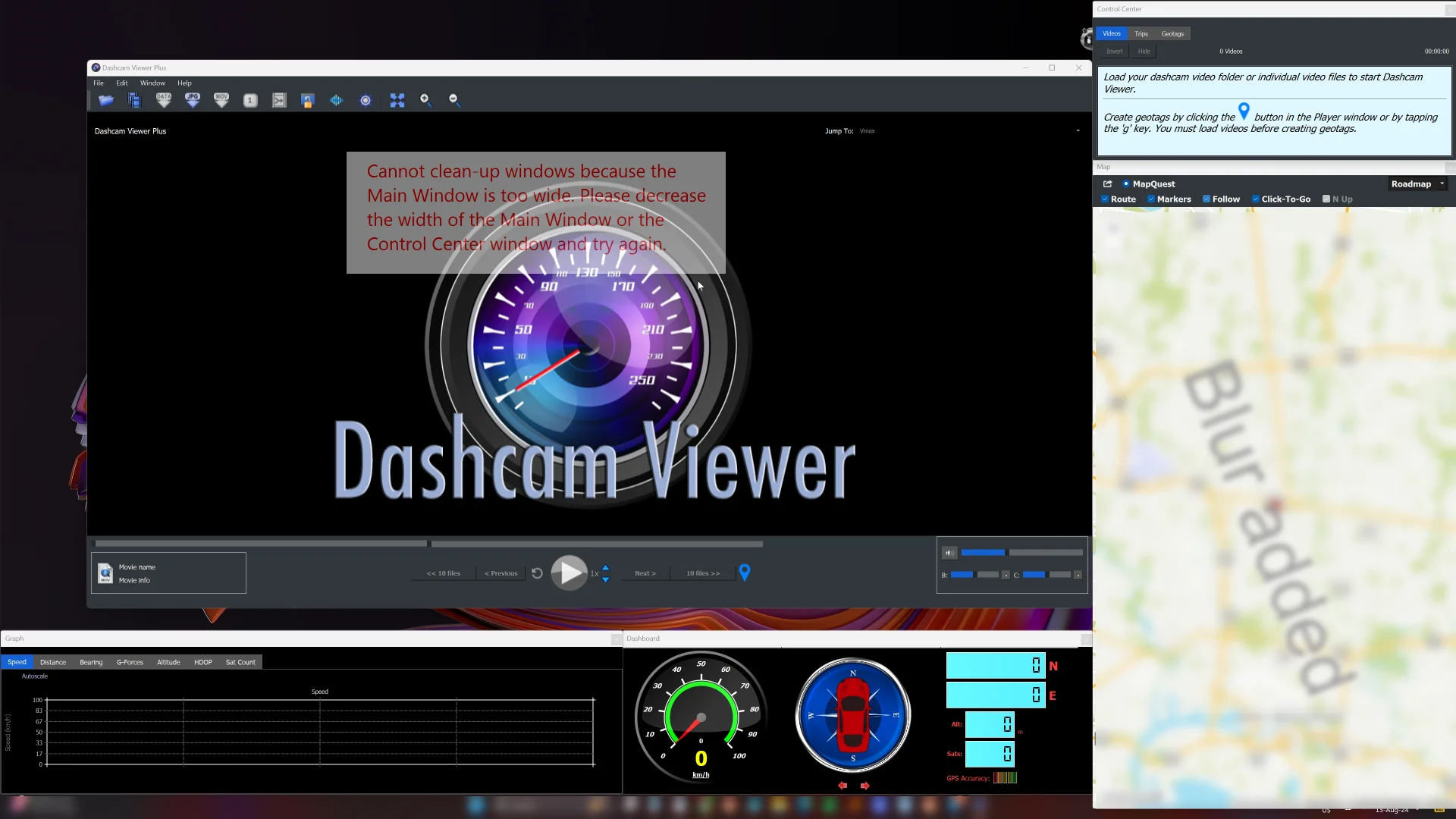

Thanks for the examples it helps me better understand what the function is supposed to do. I thought it was to clean up the cache!
So below is just some things you may consider addressing to prevent user error and then submitting a problem/error.
I might be missing something or you may need to have another look at your program. Here is an example of the main window being smaller but it still happened.
Note the "white space" (actually black) around the main window so it is smaller similar to your examples above. What I am saying here is the message doesn't reflect what is the real problem eg the outer windows are consider by the program as at their max res.
Are you able to make the main window the reference window and resize the other windows based on a percentage of the screen resolution? eg they all get a % of screen space when first set allowing for resizing later?
It also happens AFTER I do a
and then a Cleanup
I think is doesn't know that the windows are in the correct place or at least close to the correct place - note the GPS map is below and on top of the Task Bar and needs to be manually resized to fit in the desktop frame.
