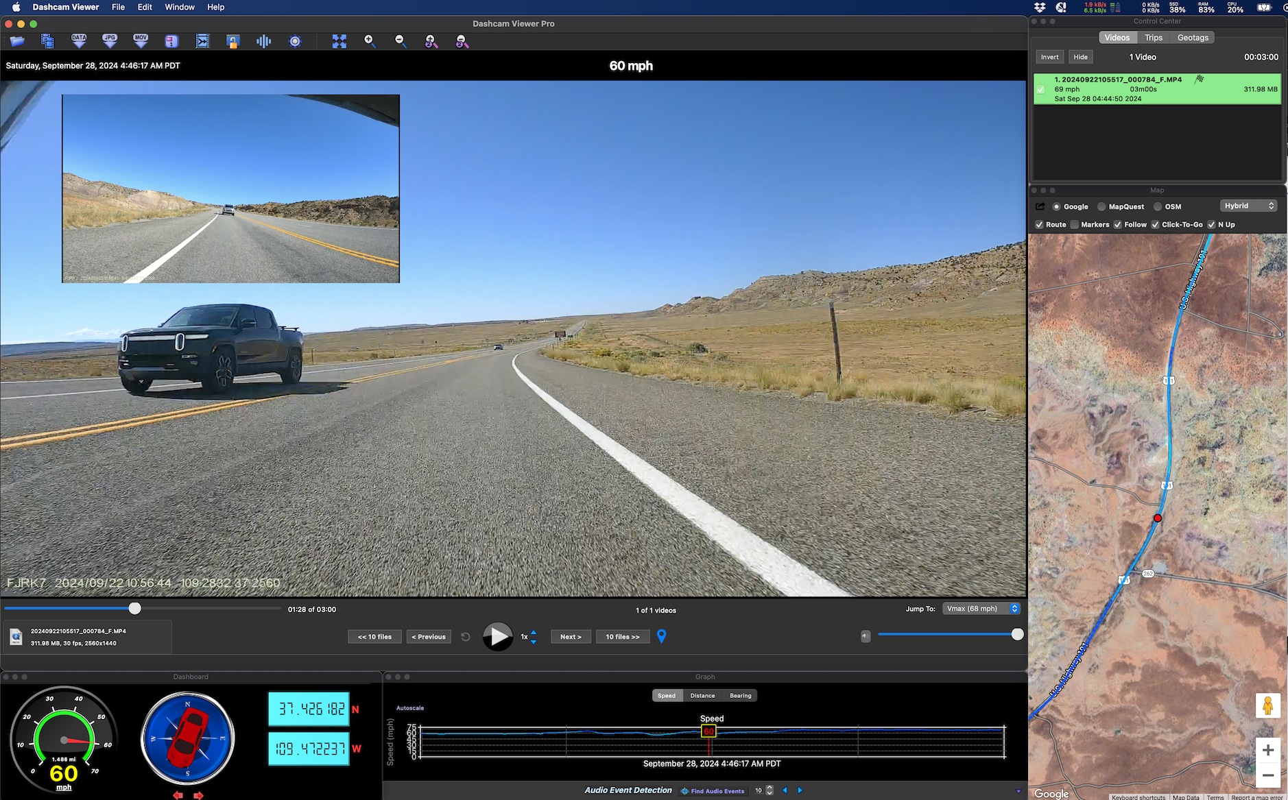

@traveler I don't believe you have yet listed it as a supported model, but so far it seems Dashcam Viewer Pro 4.0.0 is compatible with video produced by the Innovv K7 motorcycle dashcam system.
I recently bought a K7, installed it on one of my motorcycles, and have a good amount of video collected with it by now. Is there any testing I could do for you in DCV to confirm compatibility?
@DesertBike Thanks for reporting Dashcam Viewer compatibility with the Innovv K7. If you have some free, please send me a pair of front/rear raw K7 videos so I can test on my systems. You can send me large files using https://wetransfer.com.
Done, you should have them available soon. They are in the K7's default 2k (2560x1440x30 fps, with GPS tracking) mode from a recent trip.
If you would like files recorded in other formats the K7 is capable of, let me know, I wanted to experiment with others (e.g. EIS mode and high-framerate 1080p) anyway.
@DesertBike Thank you for the Innovv K7 samples. Dashcam Viewer 4 loaded and displayed your Front/Rear videos and GPS data, no problem!
Beautiful Utah desert scenery, btw. Must have been a great ride.
