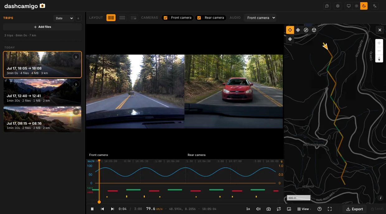

Hey everyone!
I built dashcamigo — a free, browser-based viewer and editor for dashcam footage.
App: https://dashcamigo.app
Source: https://github.com/amkulikov/dashcamigo
You just point it at your SD card folder, and it processes everything locally in your browser. Nothing gets uploaded to the cloud — the network is only used for map tiles (and optional analytics/crash reports you can turn off).
What it can do:
  • Continuous playback: Automatically stitches those fragmented 1–3 minute clips into complete trips based on timestamps.
  • Map & telemetry charts: Displays your route color-coded by speed, alongside a G-force chart that highlights hard braking or impacts.
  • Multi-camera sync: Synchronizes front, rear, and cabin feeds on a single timeline. You can expand any angle with one click.
  • Flexible export: Combine multiple camera angles into one MP4 (side-by-side, grid, PiP), burn in telemetry (speedometer, G-force, mini-map), crop, or adjust playback speed. Exports GPS to embedded MP4 data or standalone .gpx.
  • Plate & face blurring: Blur sensitive areas manually or use browser-based AI auto-detection (powered by ONNX) that tracks objects across frames.
  • Wide format support: Handles .mp4, .mov, .ts, .m2ts, .mkv and parses embedded/sidecar GPS data from 70mai, VIOFO, BlackVue, Vantrue, Garmin, GoPro, Nextbase, and others.
  • Works offline: Can be installed as a PWA and run completely offline after your first visit.
If your camera model isn't recognized, you can send a quick sample report directly through the app to get it added: https://dashcamigo.app/add-my-camera
I’m the developer, so if it chokes on your footage or crashes, drop a comment here or open an issue on GitHub.

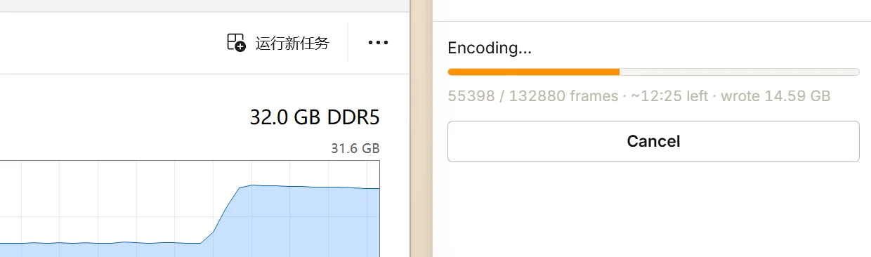

Hello, I'm here to report another problem. When I export a large video file, The video is approximately 1 hour long.,after exporting about 15GB, the memory is used up, and then the export fails with an error.
Which browser are you using?
Tried reproducing this, but no luck so far. Not really sure what's causing it — in Chrome, RAM usage shouldn't be tied to the video length.
Could you try triggering the error again, preferably on the beta version? Once it fails, just hit any "Report a problem" button, follow the steps to download the .txt report file, and send it over.

Checked the logs - looks like the issue happened during the reading process, which could be caused by a few different things.
I've tweaked the logic to make the export less likely to crash from one-off read errors. The fix is already live on the beta.
If it still fails, try exporting a small chunk right around 33:00-36:30. It's possible there's an issue with specific sectors on the disk/SD card.

After testing, the export of very large videos was successful, and memory usage was normal.
