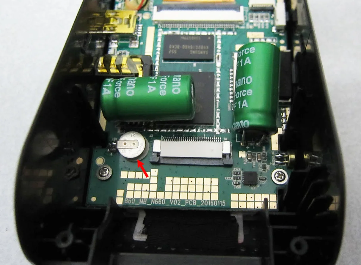

Replacing the RTC requires skill in soldering. The battery is about 5 mm in diameter.
In this photo, you can see the silver disc on the left of the picture.
This picture was for a different discussion but it gives you an idea.

Not the same as computer.
There is no battery holder.
The battery is held in place by the soldering tags.
Well that sound sucks, will it possible to use battery holder and a bit extra wire from the board?
So in future just replace the battery without messing around the board with solder.

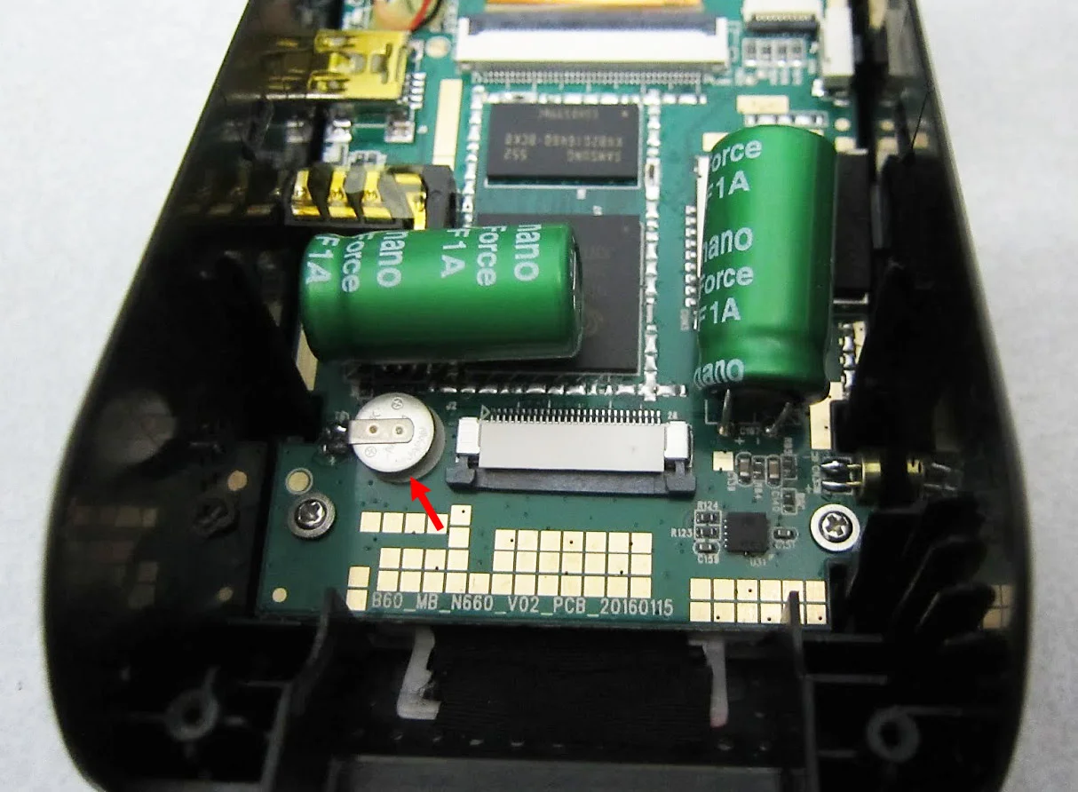

Picture taken from other post in this forum.
Hmm. it seem the two dots is the it cold welding.
You can get replacement batteries that will have the + and - tabs already welded to the battery, then you just need to remove the old battery and solder in the new. Some users have found these on Aliexpress.
