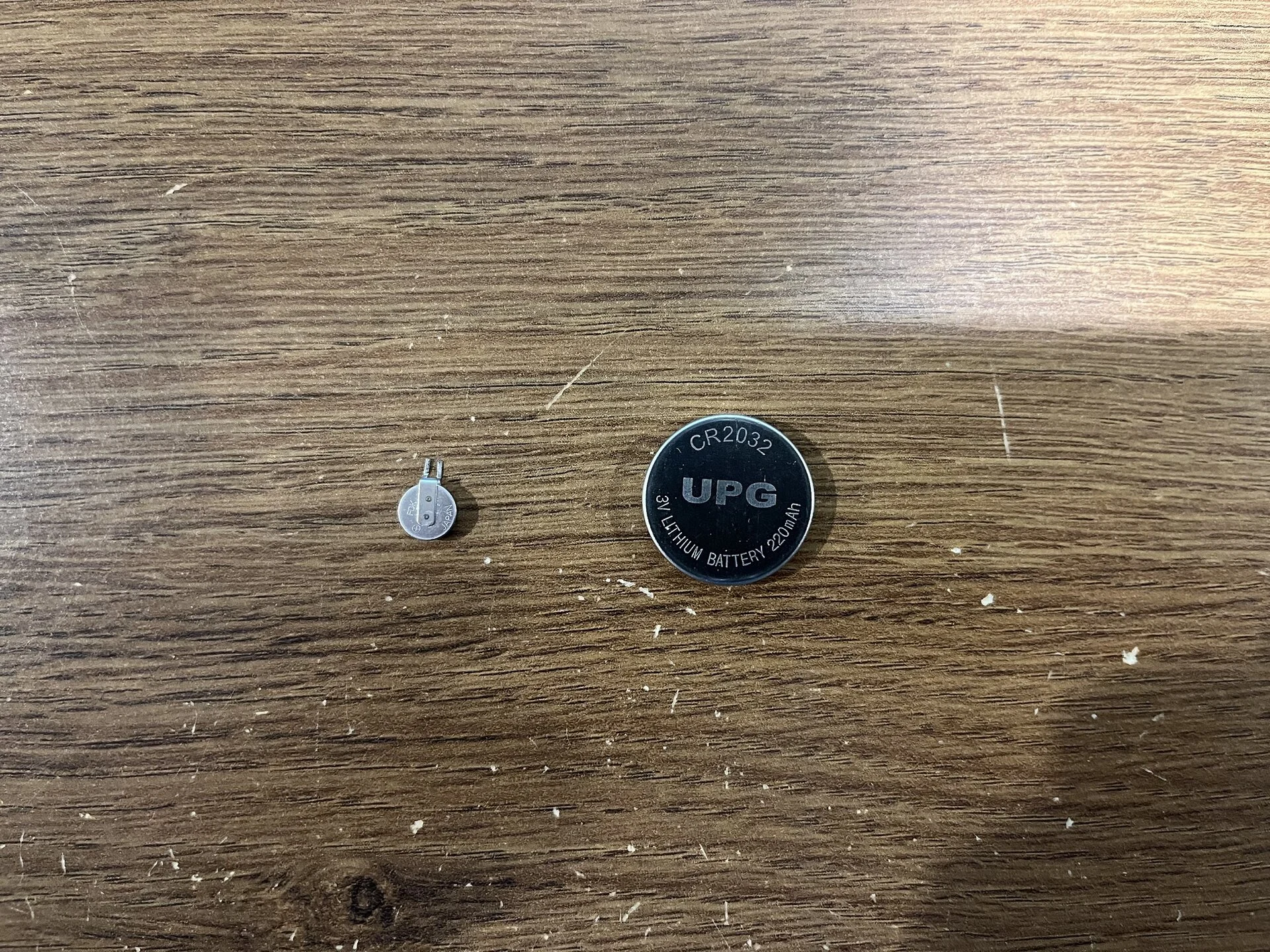

A PC battery is probably considerably larger than what they can fit in a dashcam.
Having said that, I've had mine sat idle for a few months during lockdown and the clock was fine. I'd have also thought a weekly journey would charge the battery sufficiently for the next week.
PC motherboard batteries are usually CR2032, which is considerably larger that the RTC batteries in dash cameras.
I'd have expected longer service from the RTC battery but occasionally one dies sooner. I don't know who they source the batteries from but many Chinese cells aren't very good or are rubbish. There are some good ones too but in general the best batteries will be Korean or Japanese made and do cost more. Size definitely plays a role here.

The RTC battery above is from a Viofo camera and was from Japan. Could simply be the OP doesn't drive enough to keep it charged (he said he drives about once a week). Over time, I'd think drainage would win over the minimal charging. That said, the above battery was from a camera that was much less than 2 years old, so duds certainly to occur.
Wow didn’t realise the one in the cam was so small?

@gse Thanks for that, so the battery is 6mm by 2.1mm so bloody tiny.
