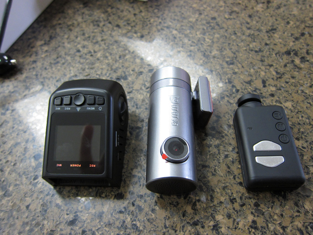

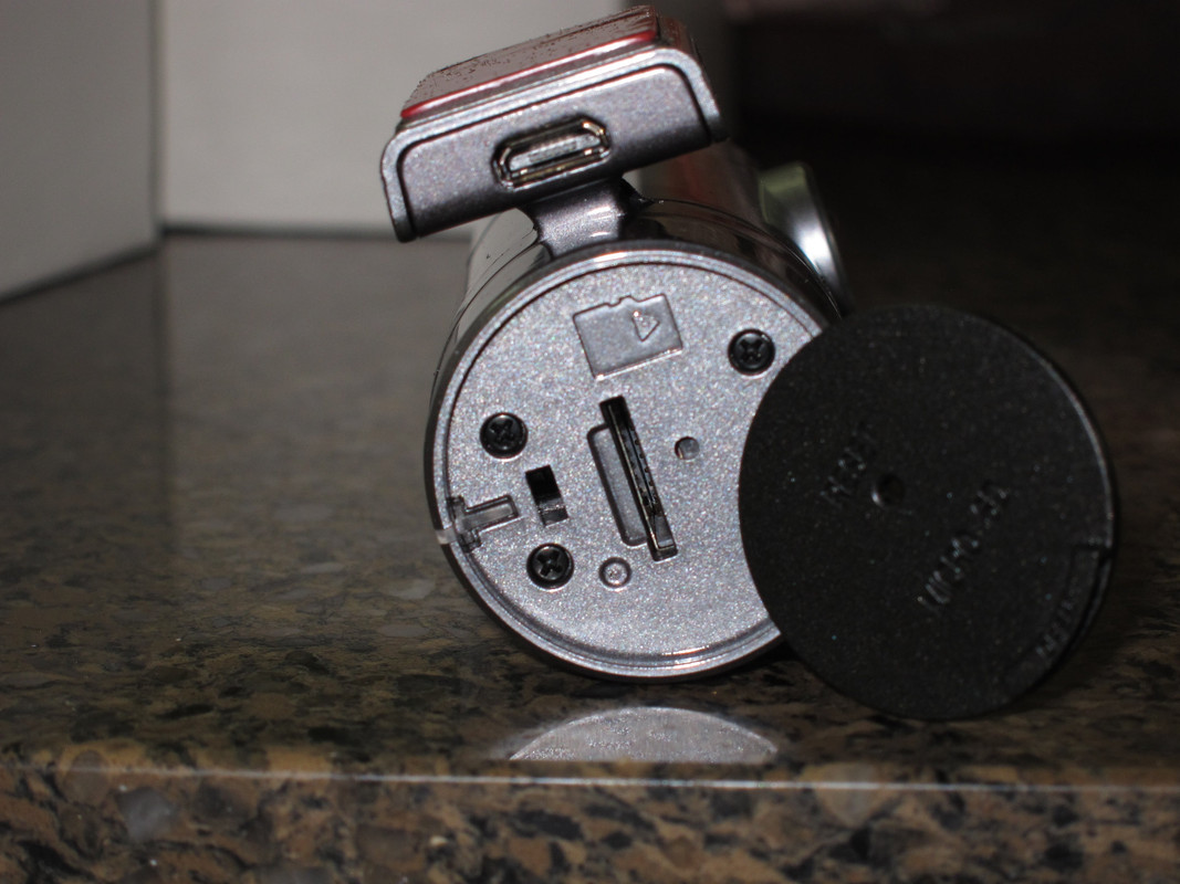

Size comparison - from L to R, SG9665GC, Mini2, Mobius B Lens
I'm not going to review the app or remote button, as it functions exactly like the M6+ that Techmoan reviewed. The M6+ and Mini2 use the same sensor and chipset. Primary difference (besides form factor) is the Mini2 is capacitor based, and has no GPS.
My primary intent is to use the Mini2 as a rear facing camera, and parking camera. My Mobius B in one car is currently performing this duty, but before I mount it there, I wanted to review it against my SG9665GC that is forward facing.

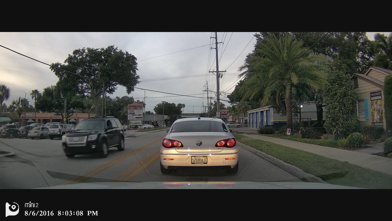

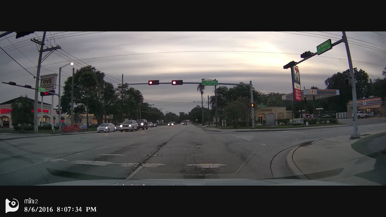

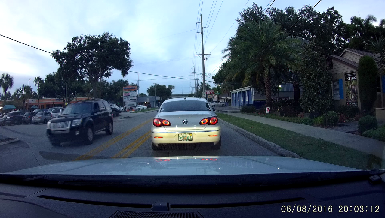

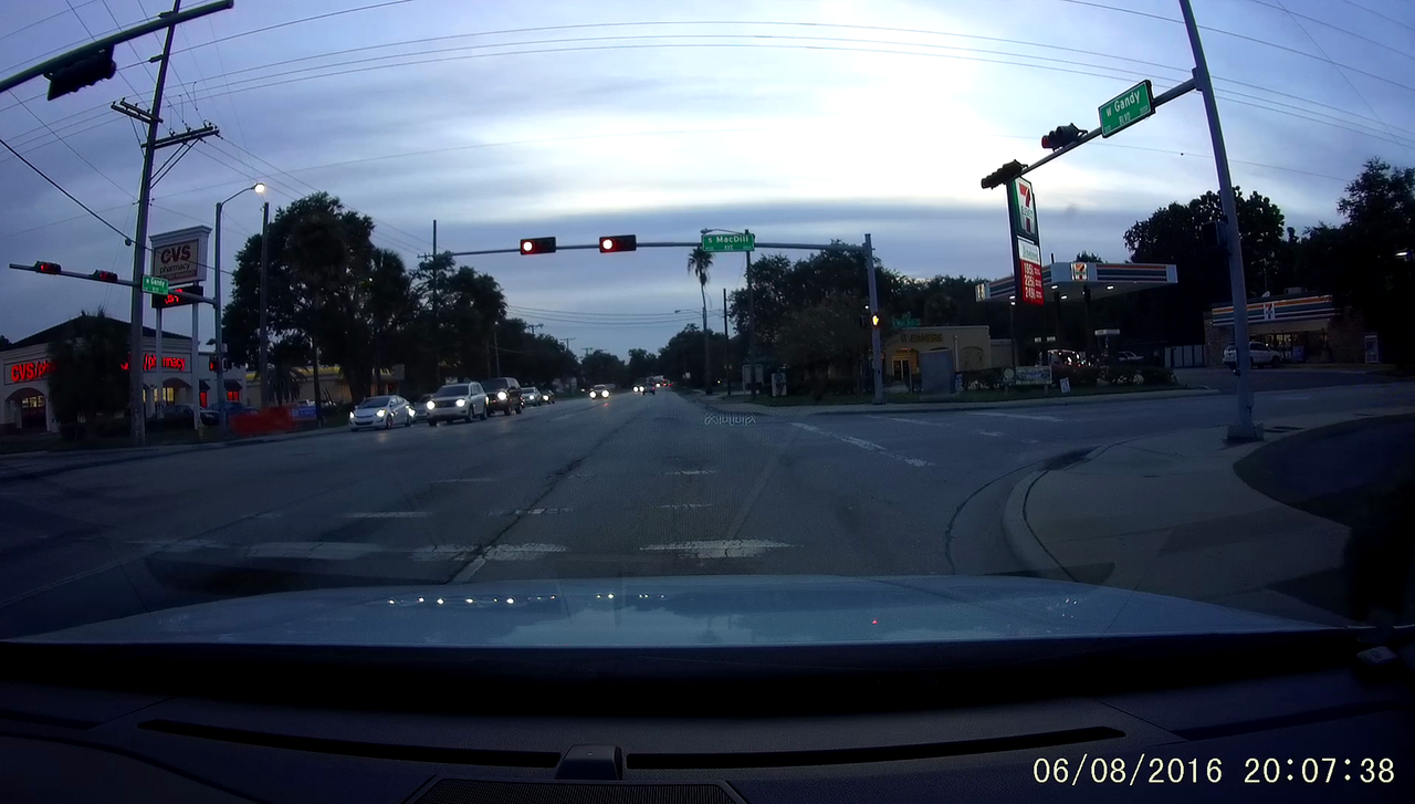

Evening Performance
Still frames
Mini 2
SG9665GC
Mini 2
SG9665GC
I see more detail in the Mini 2 images, but the colors are muted.

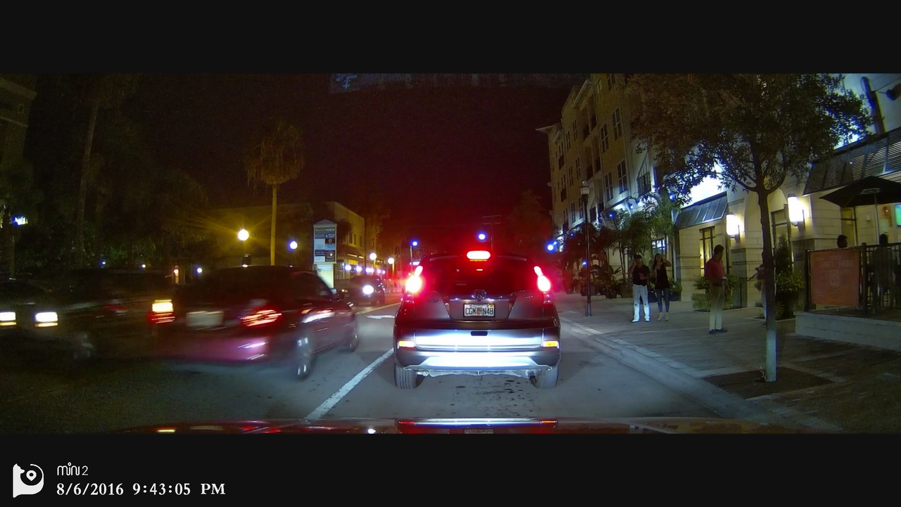

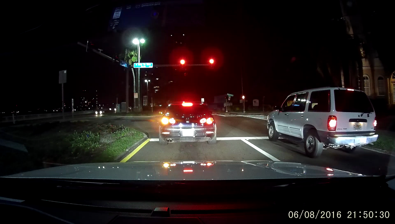

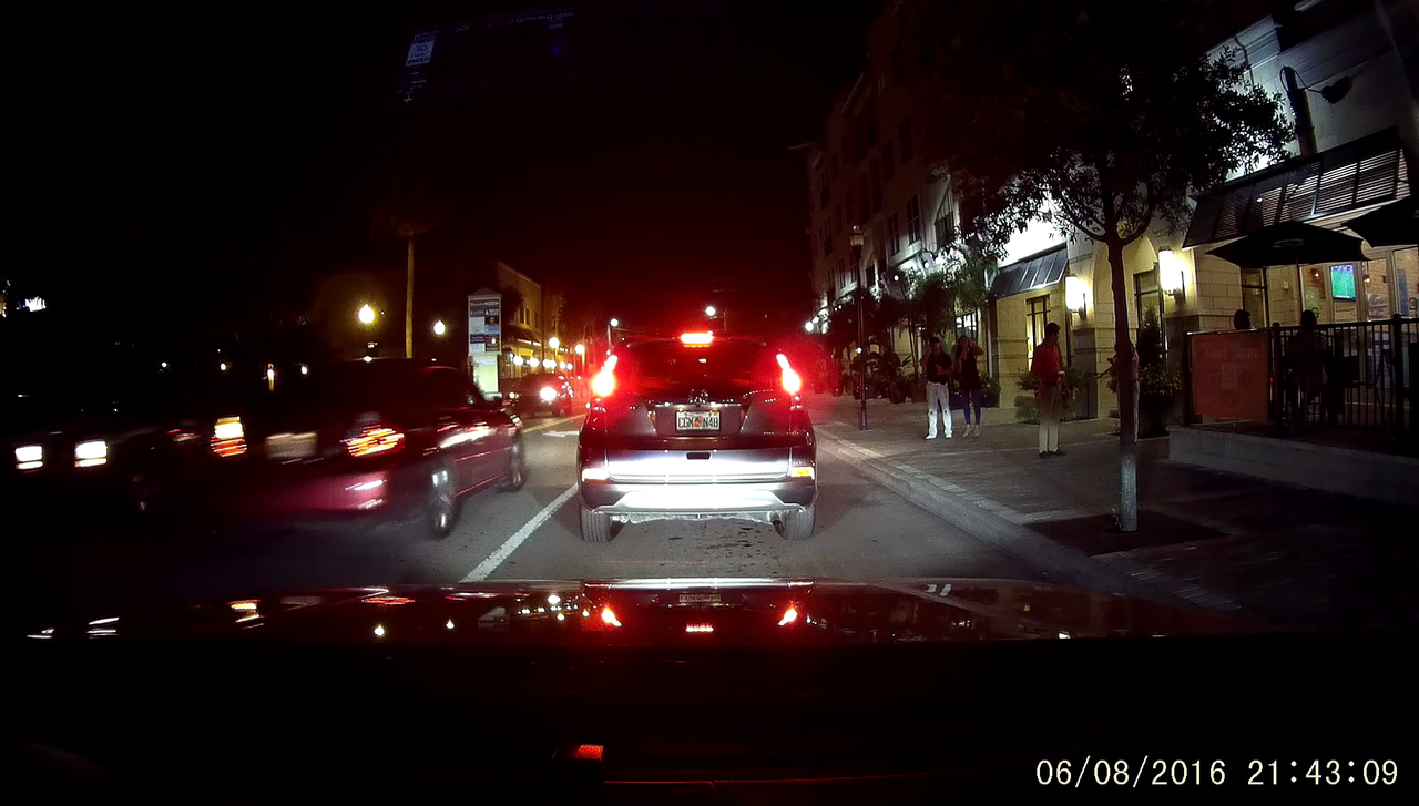

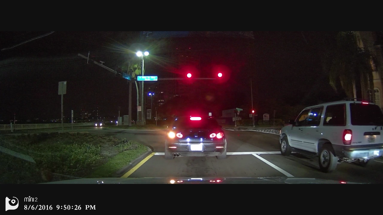

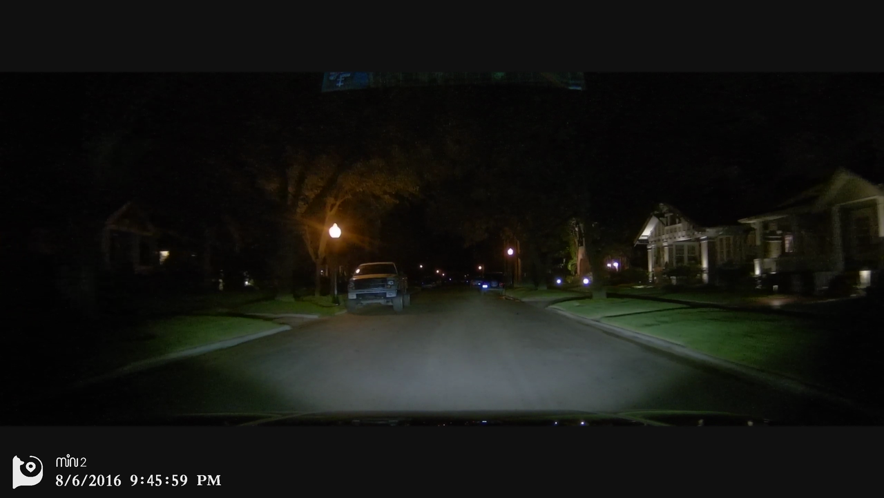

Night Performance
Stills:
Mini 2
SG9665GC
I see more details (left side of picture, trees) in the Mini2. Reading moving license plates (even at slow speeds) like in the above pics is about impossible in both cameras. The SG9665GC looks slightly better in this regard. Maybe to do with the framerate. SG9665 is 30FPS, and the Mini2 is 25FPS.

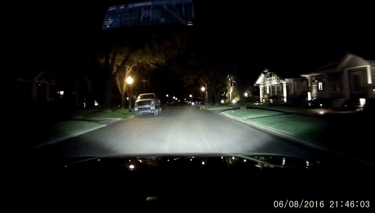

Mini 2
SG9665GC
This set is interesting, because to me it looks like the SG did a better job at picking up details than the Mini2. SG looks sharper as well.

While the Mini2, generally, provides more details in low light situations, it seems to do so at the cost of a noisy picture. This comes down to personal preference I think - do you want more details, or do you want a "cleaner" picture? I think I prefer the SG9665's night performance over the Mini2.

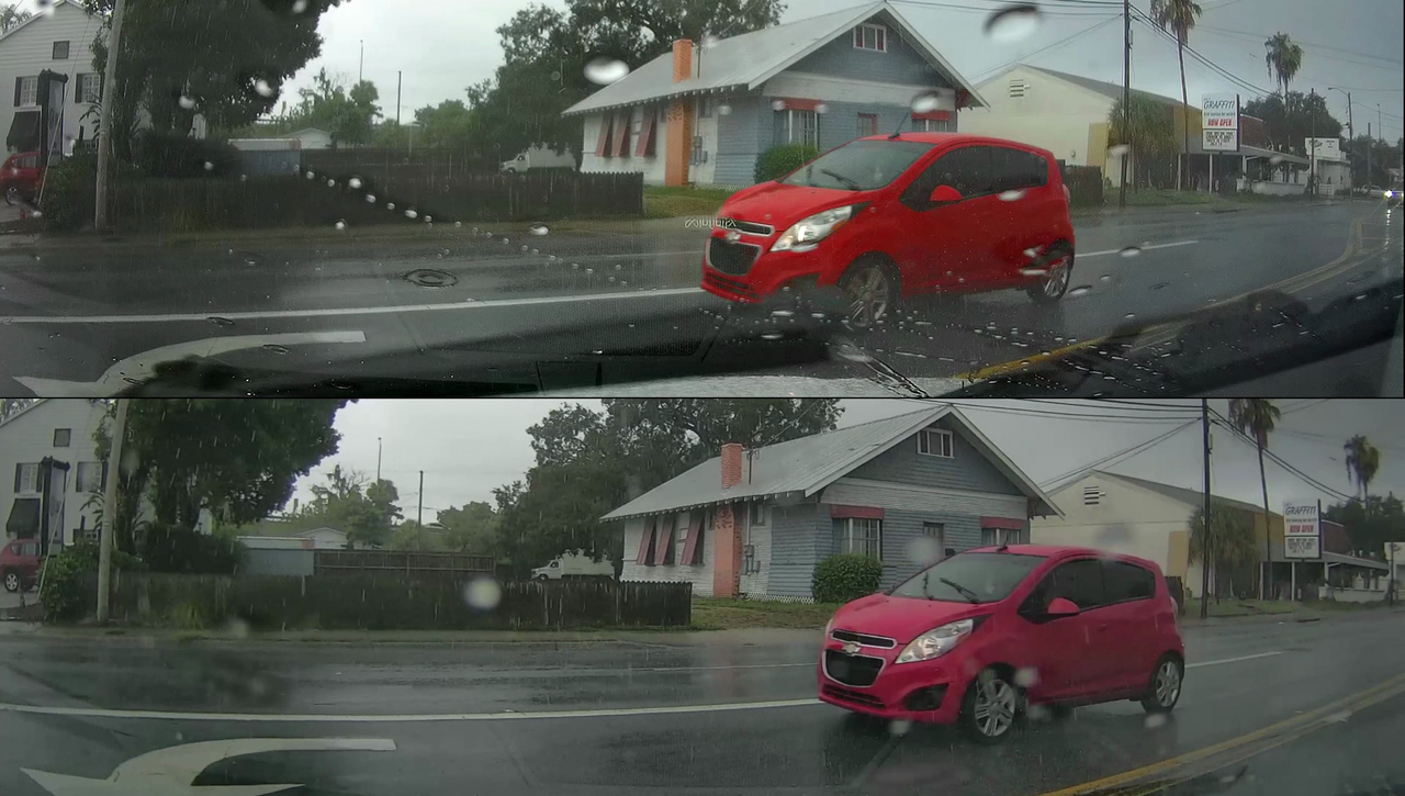

Rain Performance
Split SG9665GC (TOP), Mini2 (BOTTOM)
You can really see the saturation difference in this screenshot.

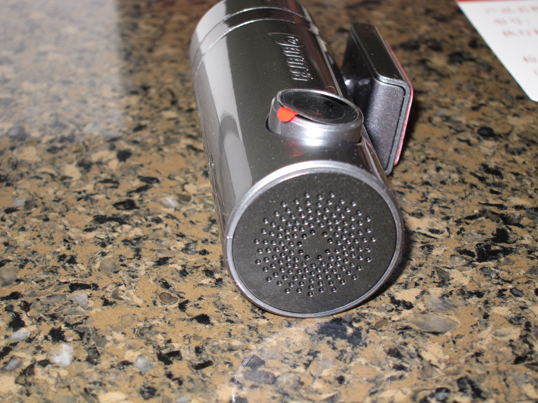

Sound
While I didn't take an audio clip, the sound is average at best. It sounds muffled, like it's recording in the glove box. The SG9665GC is much better in this regard.
