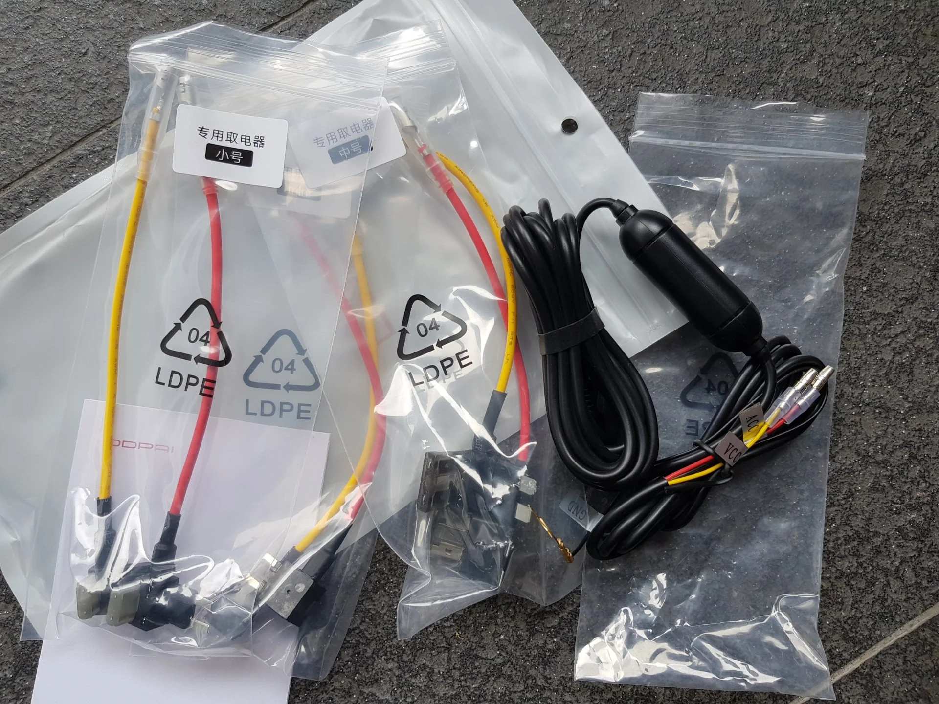

The hardwired kit is a US$12 add-on when purchasing the dashcam. For that kind of money, it's hard to believe they've also included 3 types of fuse taps, 2 each. Mini, midi and low profile. Each one of them already have 2A fuses installed for the dashcam. The other slot is for your car's original fuse.

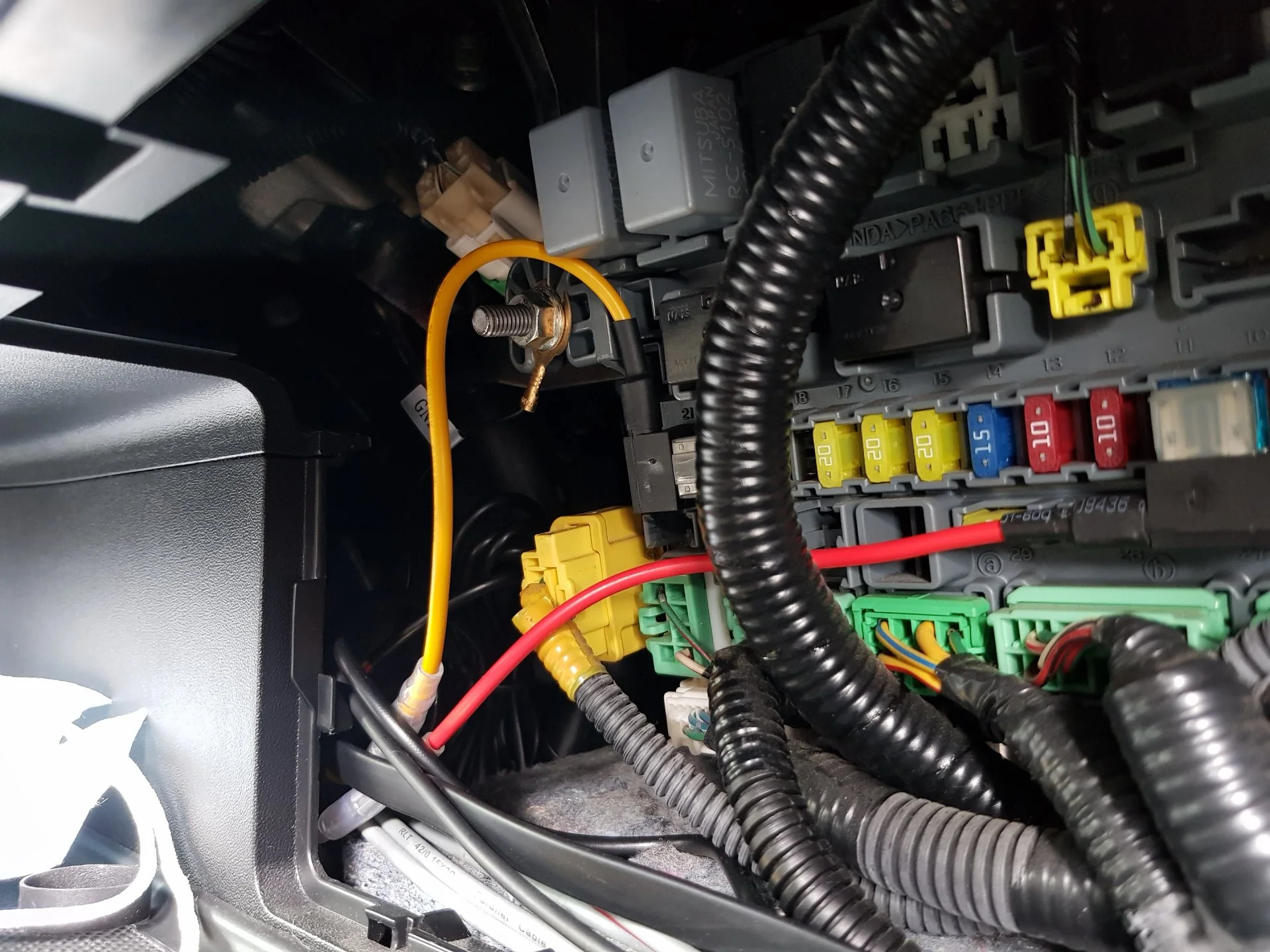

The fuse taps fit nice and snug on both male and female ends. In this example, a 2006 GD3 Honda Jazz (Fit in some countries), I've tapped constant power from the headlamp 20A fuse, and ACC signal from the cigarette port 7.5A fuse.
Here we can see the ground line terminated at the fusebox mounting bolt. The power supply unit itself tucked into the other side of the fusebox nicely. The taps and power supply leads are pre-crimped with terminals so that you can connect them without additional tools. All makes for a clean and easy install.

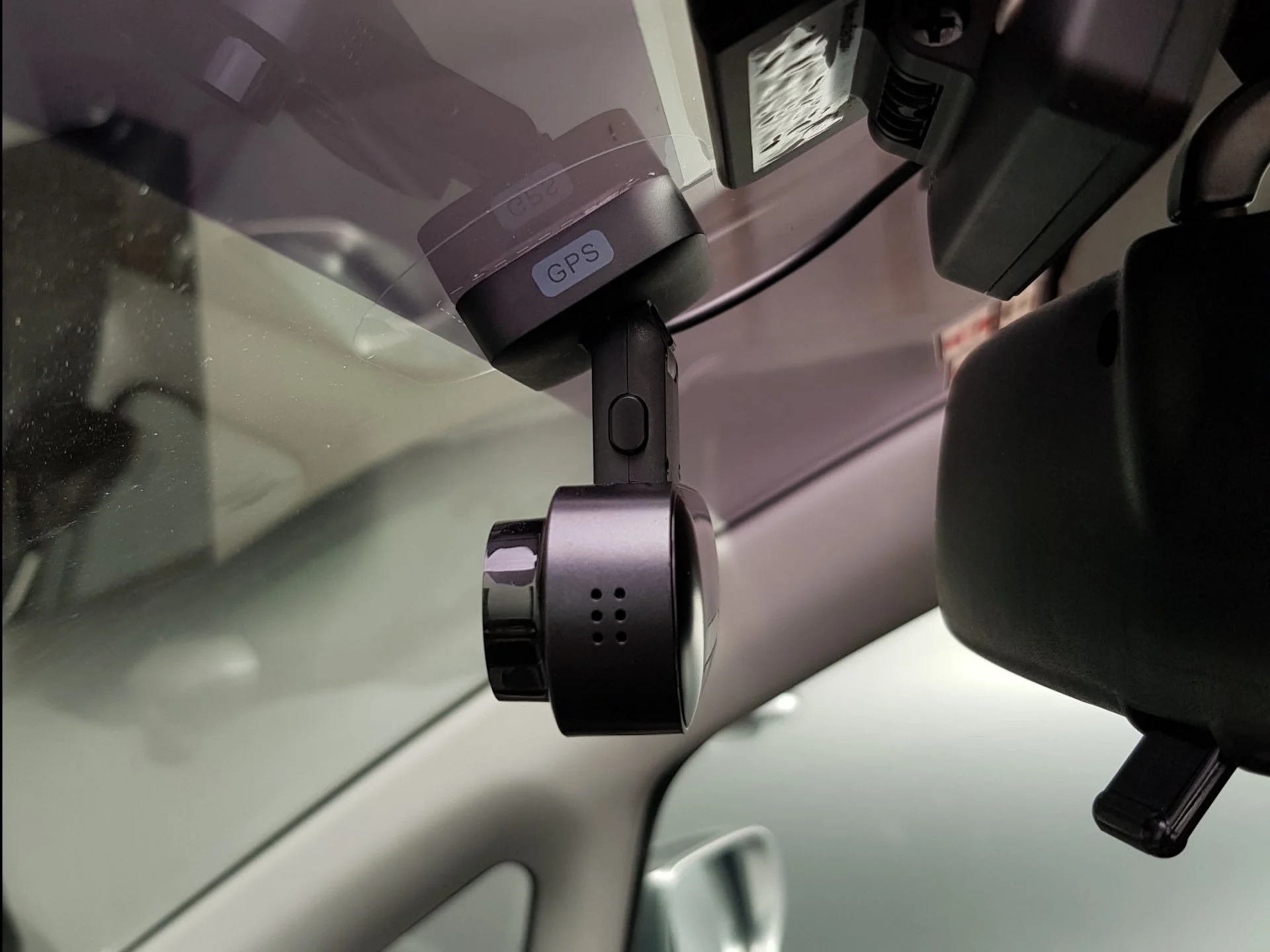

Yes, the dashcam is quite far away from the glass. It's not optimal and is a by-product of their decision to make the camera reversible so that you can get footage from inside the car as well. Of course at this mounted position, it is pointless to try to reverse it (because all you would see is the back of the mirror). The release isn't the smoothest as well, but okay it works if you wanna bring it down. I've aligned the lens to the centre of the mirror stalk, which means the power cable needs to go around the far side where the driver can see all that clutter :/

Overall, the availability and pricing of this hardwired kit, its quality and bundle, makes it a must-have when buying a Mola N3. Both items go for ~ US$60 on Lazada Malaysia, and I think is available regionally in South East Asia where Lazada operates.

Other than fitment, I'm not sure that there is any great disadvantage with a lens being away from the glass, and that can help with keeping a cam in the shade during the summertime, which can be important for many of us in hotter climates ;)
Seems to catch more dashboard reflection. I had an A119v2 in front before this, I don't remember the dashboard details being that clear.
That can happen, but it doesn't always happen. I've had a B2w, Mobius, WR1, and some G1Wx cams mounted 2 1/2" (67mm) or more away from my windshield without much dashboard reflection. My K2S install was almost touching the glass at the very top without much reflection too. Yet with that same B2W and other cams mounted on the glass as intended but lower, they're getting some serious reflections :( So at least in my experience it's not consistent or predictable and I cannot determine exactly why this happens. Akaso once sold a cam with a 4-sided "V" shaped shield meant to go against the glass to eliminate reflections, but it looked horrid from the inside and looked very out of place and noticeable from the outside too :( It wasn't on the market for very long and I never found much comment of how well it helped with dash reflections.
A non-reflective dashmat is the best cure, a CPL can also help, and having both should eliminate the problem but might not. All you can do is try ;)
You're right in how unpredictable it is. Just gotta keep trying. I looked back at footage from some other dashcams, height of mounting seems to have strong effect too. Obviously tinting film plays a big role depending on lighting condition. If you've got light coming in from the side, it'll reflect more internally.
In regards to the distance from glass, in theory further away means you capture across a larger area/section of the glass. The amount of glare from the glass is probably the same as being nearer, but since being nearer captures most of the vision from a smaller spot of the glass, the camera can better compensate with exposure adjustments since the glare profile is likely to be consistent in that smaller spot. Across a larger spot, some parts of the dashboard reflect more, other parts less. The camera exposure attempts to adjust across the average frame, but some parts would be blown out and others underexposed. That's how I think of it in my head anyway. Hope it makes sense.

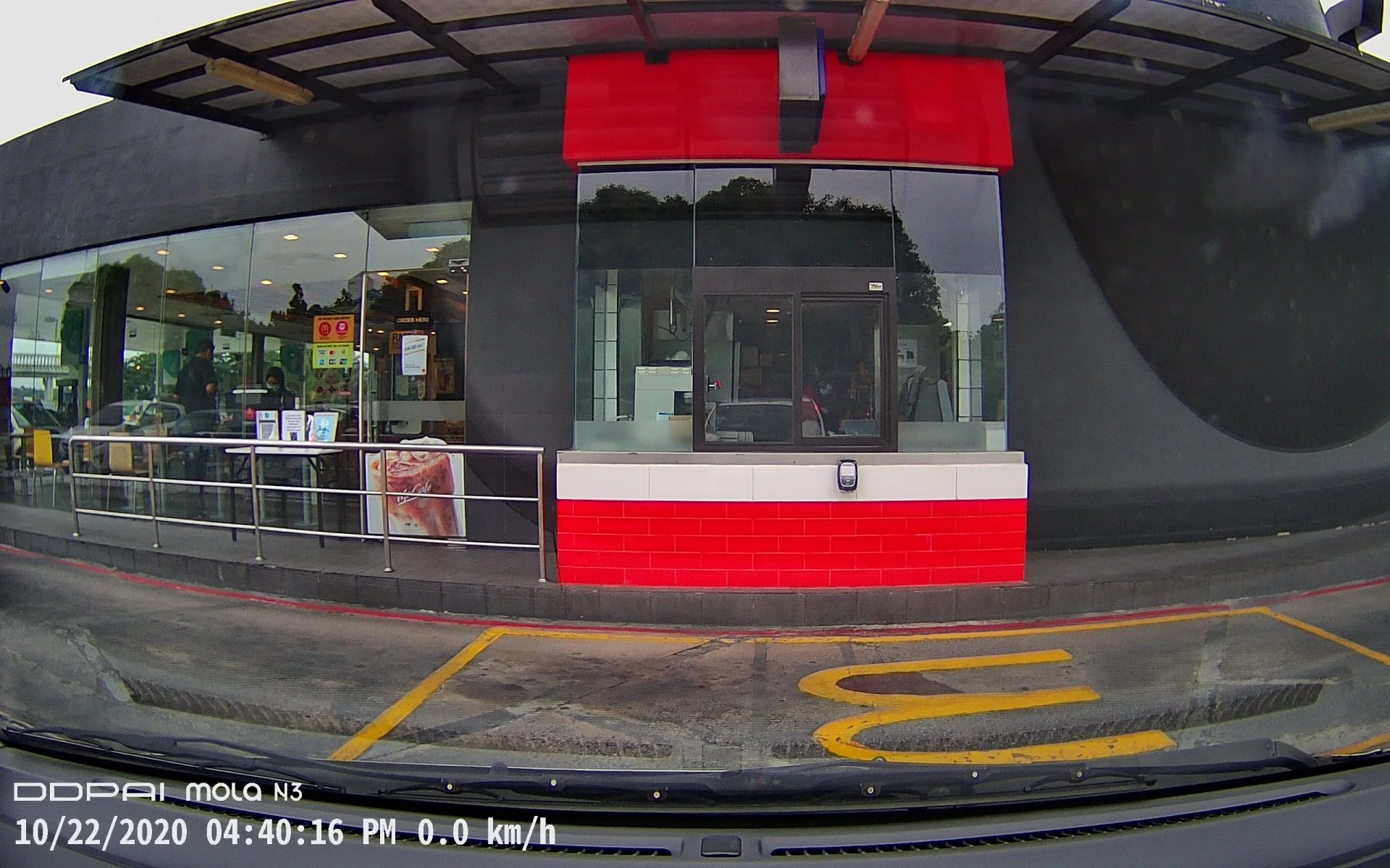

Forgot to post this earlier. Here's a G-sensor triggered snapshot taken by the camera when I got into the car. It seems to be at full sensor resolution regardless what video resolution is being used for normal driving recording. Clicking on the in-line image should allow you to see the full resolution photo.
