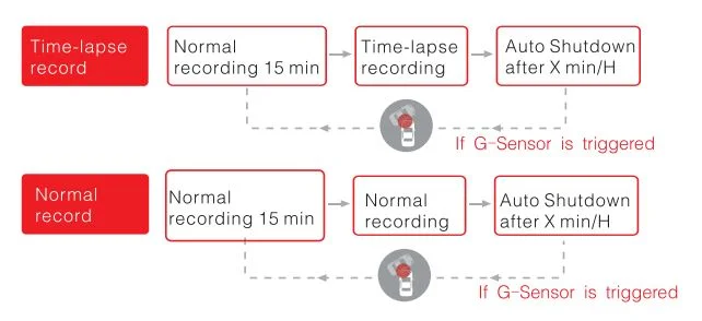

I found this explanation in the user manual of the DDPai Mini ONE. I can confirm the Mola N3 behaves similarly based on these priorities:
  1. Battery voltage has not dropped below the cut-off setting (12.4v, 12.0v, 11.8v).
  2. G-sensor if enabled, is always active until condition 1) has been breached.
    1. If condition 3) is active, it will take a snapshot and record normal video for 2 minutes after the G-sensor event and continue with 3).​
    2. If condition 3) is inactive, it will wake the camera and start recording normal videos for 2 minutes and starts action 3). It takes 2-3 seconds to wake the camera up.​
  3. Time lapse/full motion parking recording if enabled, will try to run for as long as you've set the timer for (15m, 1h, 6h, 24h 48h) or until condition 1) has been breached.

So it seems like there's an option of full recording while parking too!
Is it 15 minutes or 2 minutes before switching to time-lapse mode after ACC power OFF?
And yes, please do a comparison for Mola N3 vs Mini ONE vs Mola A2. Thank you!!!

@fisherman10 yes, the option's always been there. It's just that I've never considered 30fps recording as viable for parking recording. You'll run out of space so fast you won't be able to check back what happened yesterday maybe. I don't know why the manual listed 15 minutes. It didn't seem like a logical value for G-sensor recording, but I used a stopwatch to time when the camera woke up and slept and it was 2 minutes 5 seconds or so. It will probably take a bit more investigation to see how different combination of functions will operate.

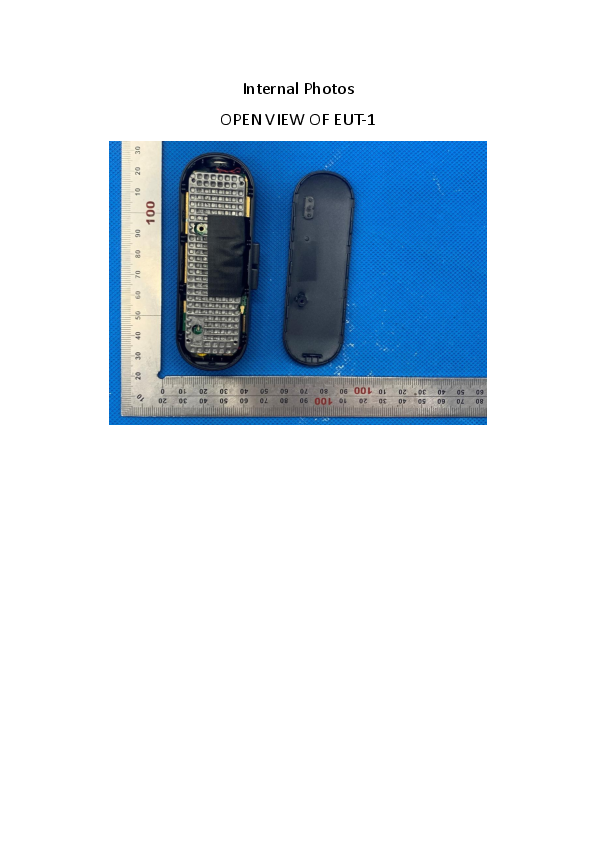

Some further info. Based on FCC internal photos of the Mola N3, the main SOC is HiSilicon Hi3556 V200. Nice big heat-spreader and supercapacitor has a connector for easy removal.
Based on the SOC datasheet, this chip has 2x 900MHz Cortex A7 CPUs, built on 28nm process and has embedded 1Gb (128 MB) DDR3L RAM. Hardware encoding for H.265 and H.264 is present, as is lens distortion correction.
wow! That is a HUGE heat spreader!
Meanwhile the B1W has none. Haha

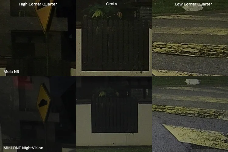

250 x 250 px samples taken from still shots taken by Mola N3 vs Mini One. The "corner quarter" areas are based on the rule of third points. Each camera applies pretty different processing idea, I think. The Mola N3 oversharpens a bit while the Mini One seems to prefer to reduce noise more. The exposure bias and white balance are also quite different [if you refer to video footages (Mola N3 vs Mini One) it's also evident there]. Overall I think this is a win for OmniVision's 5MP sensors (I dug around the firmware update files, seems to have reference to OS05A series sensors, but hey I may be wrong).
