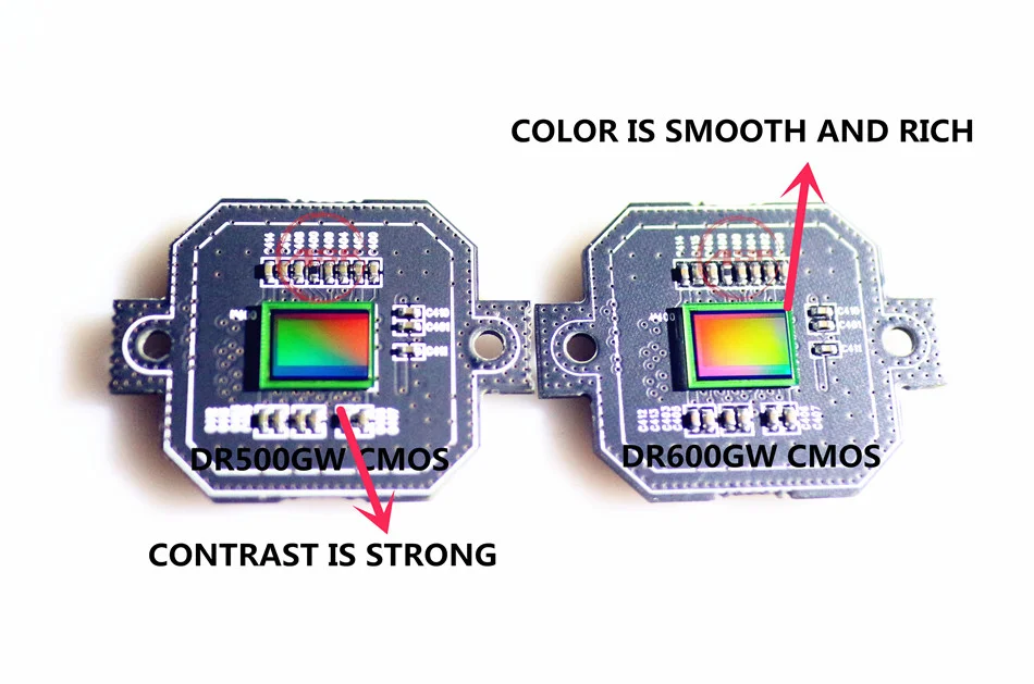

I disassemble one Dr600gw and a dr500gw camera and found out this. Blackvue does change a bit on the Matte Black Dr600gw comparing the older verison Dr500gw.
If you have more information about these 2 models, please post the pictures and comments to help the members justify the differences between these two models.

Differences from 600 to 500
1. Memory card support up to 64GB (500 up to 32GB)
2. Smaller angle: 133/107/80 (500- 156/122/89)
3. Completely in black (including the holder and trim around the lens).

Great thanks. I thought Blackvue use new Nand Memory Flash hardware in DR600gw, they use Samsung 349 replace the samsung 310.
