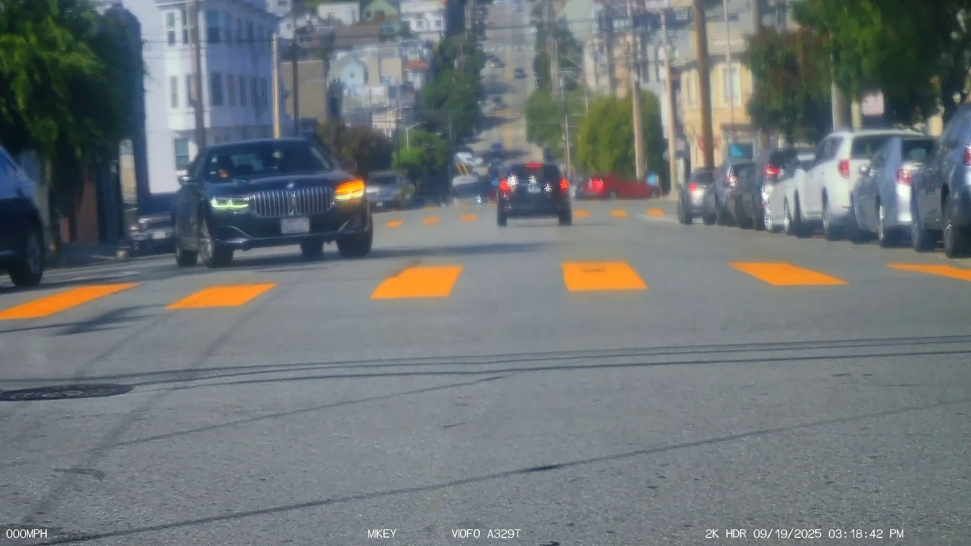

Sharing here to warn others who might make the same mistake -- I purchased a CPL-600 filter for my A329T telephoto channel. While reviewing telephoto footage yesterday, I wondered why the oncoming license plate was difficult to read. I thought maybe I needed to manually focus the polarizing filter (because the notches could be off like with the front channel), but the CPL-600 is rectangular vs. round so that couldn't be right. Then I noticed my CPL-600 lens ships with a clear protection film on the inside of the lens that I neglected to notice and remove. Oops!
With protection film (bad):

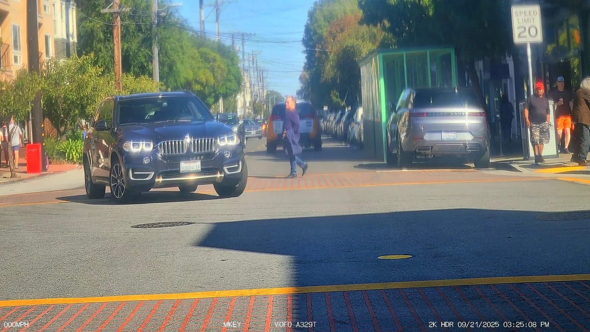

Without protection film (good):
That "after" pic should look a lot better than that. Maybe start with cleaning both sides of the window,
then remove the CPL and clean both sides, and also clean the cam lens.
It looks like maybe there is a finger smudge, or just dirty window glass, but I'm betting on a smudge
somewhere. There are parts of the After pic that look better and some parts look worse.
Hope this helps!
you can never clean your glass too often as a dashcam operator, windows first and foremost, but i have also at times cleaned camera glass ( lenses / CPL filters )
The bottom pic still look a bit,,,,,, smokey, i am sure it can be better.

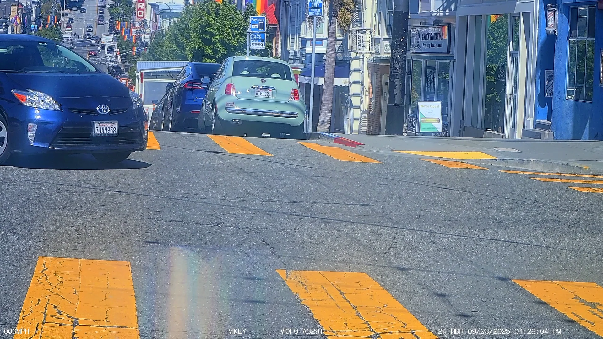

I cleaned my telephoto lens and CPL filter. More importantly, I installed a fresh static sticker and mounted the telephoto again. There's still some telephoto smudge near the bottom left third that I need to track down.
After my very initial telephoto + sticker installation, I had to remove it to fix something with the cable. Afterwards, I just reused the same static sticker. Today I noticed a lot of air bubbles in that old telephoto sticker so that may be why my previous "after" picture still had issues. Thanks for calling it out!
With new static sticker (best):

Is your telephoto camera looking 'through' the static sticker? You will get an even clearer view if the sticker is not in the way.
^ This is the first thing I thought of. @mikey94025 if you like this image you are in for a very nice surprise
when you see what this lens can do. 😉
Your static sticker should ONLY come between the self-adhesive and the windshield, and nothing should come between the
lens and the windshield. There is glare and a rainbow in your image that would not come from the glass.

Huh, I didn't think it mattered. Thanks for pointing this out.
The reason why I use the static sticker, besides the fact that it came in the box, is because it makes it easy and clean to remove the dashcam. I change cars frequently, or used to.
