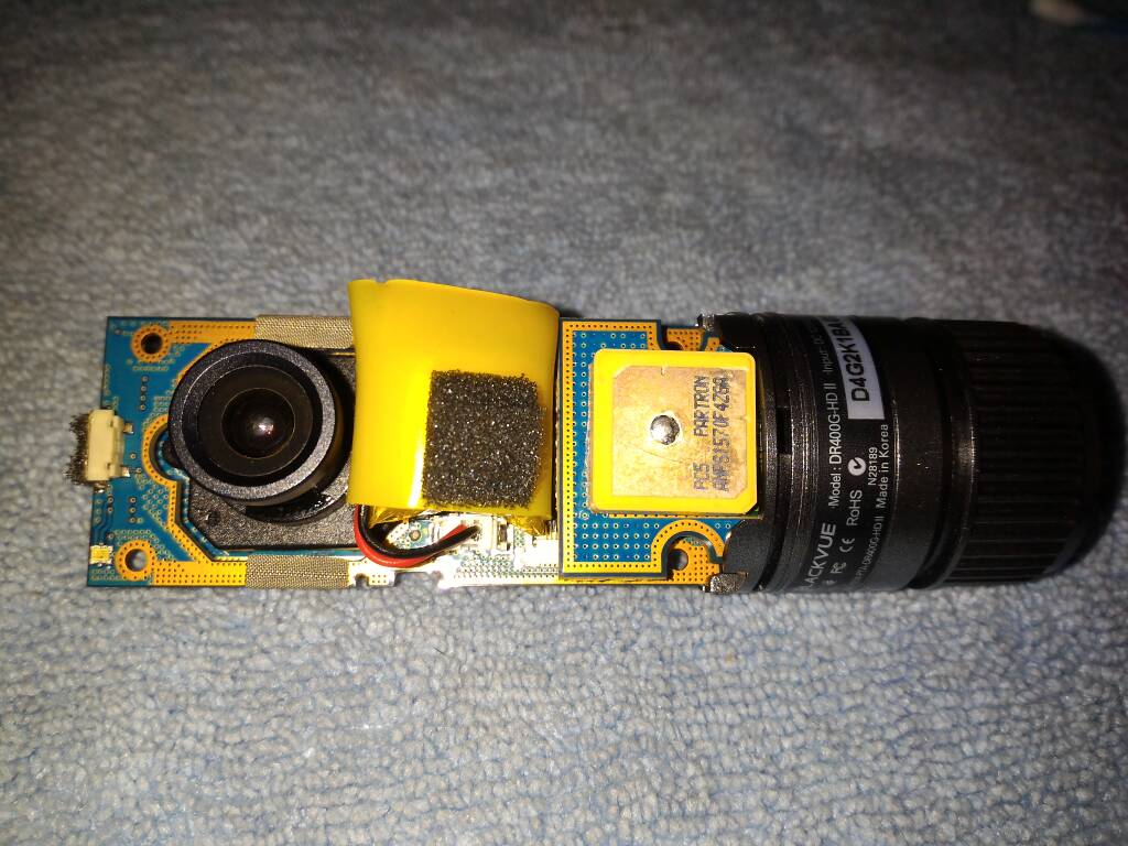

My DR400G HD-II just fogged up recently after 6 Years of service. (Lol, I cant believe its going on for 6 yrs now!!)
I just opened it up for the first time to clean up the lens and took a few pictures.
Can you tell if what I'm seeing adjacent to the lens, is a super cap or a swollen battery?

that is a very swollen battery so you'd want to replace that while you have it apart

I just looked up an article on battery replacement. Will order a replacement via ebay.

Replacement battery was a bit bigger.
The case was able to close with quite a lot of manipulation.
But I made sure that wires were safe.
Lens cleaning made the picture perfect again[emoji4]
Some pictures of battery comparison
Cant find the exact same battery as before[emoji20]
