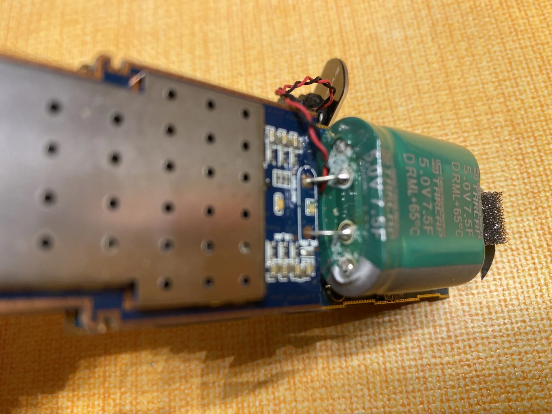

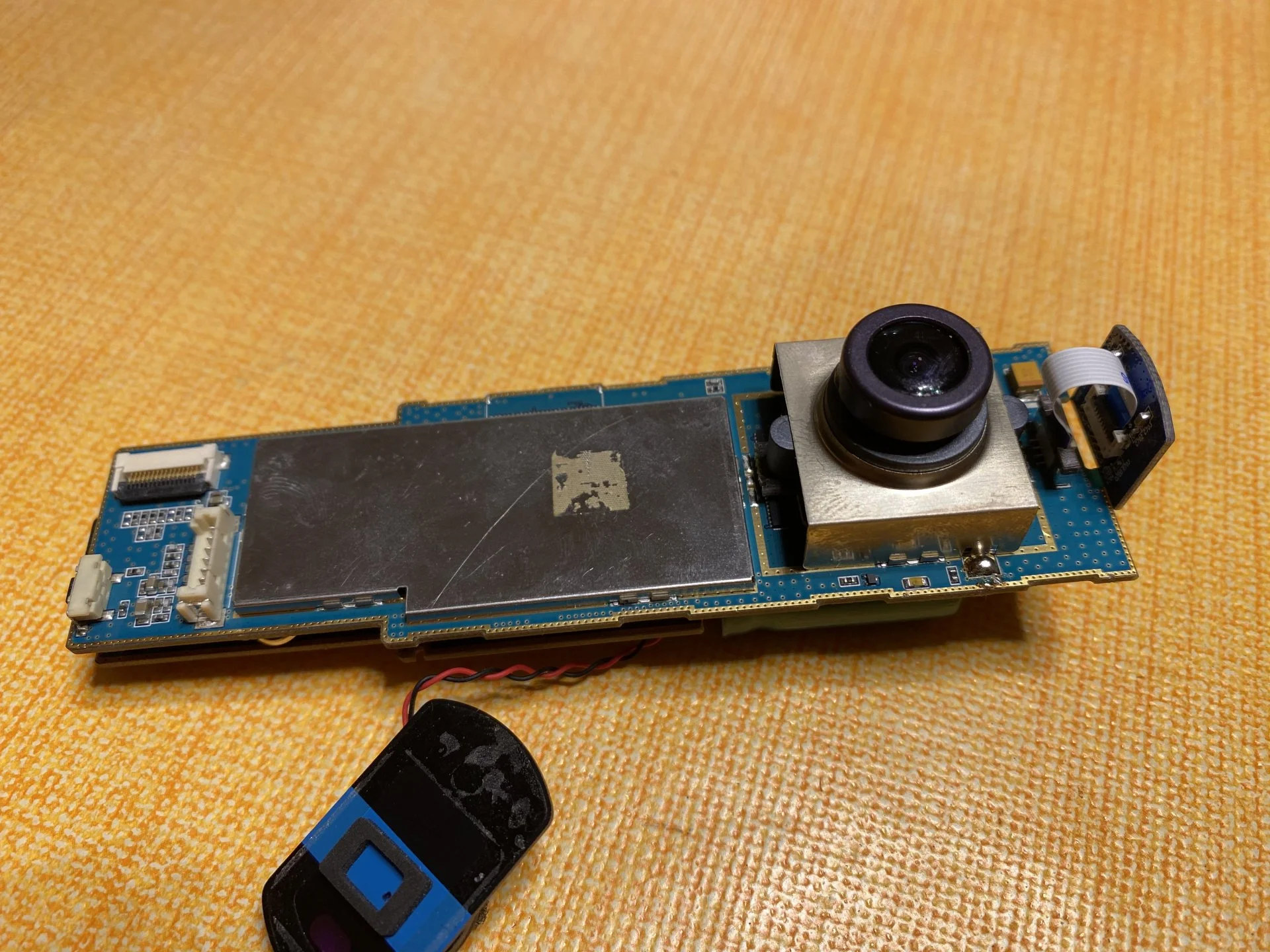

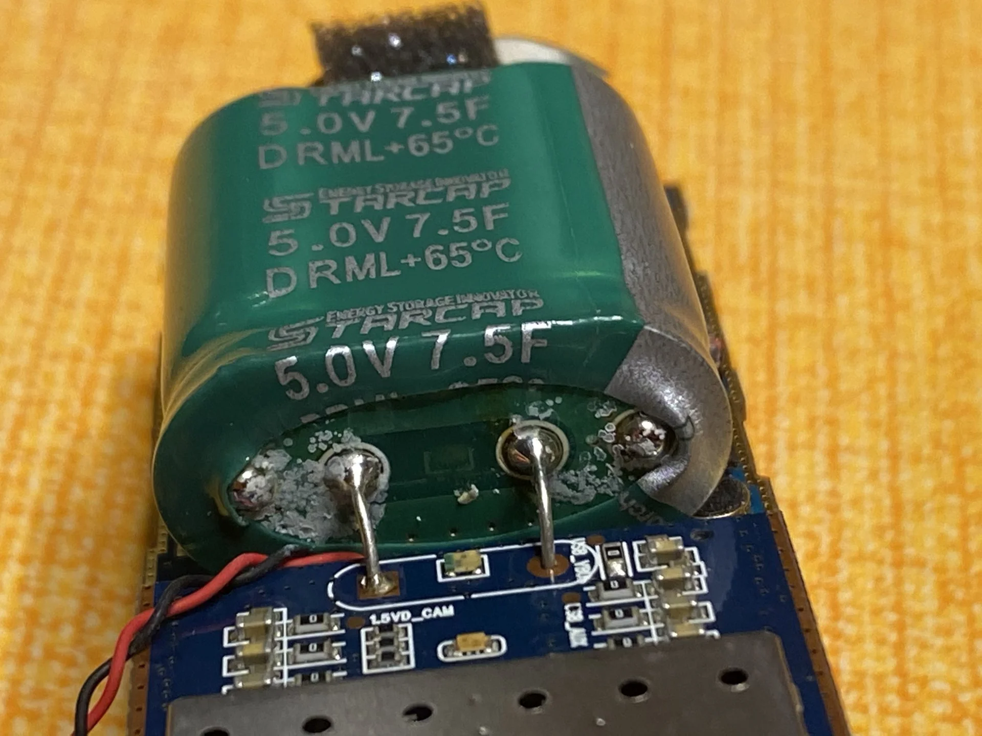

as promised, I send you some pictures in accordance to my investigation.
The PCB looks like brand new, no dust, nothing overheated. Only the capacitor 5.0V 7.5F show typical electrolyd marks, so as I mean he lost capacity. I will try to find a replacement and let you know.

I don't think the capacitor will make any difference as it is only there to provide enough power to allow the camera tho shut down gracefully when primary (car) power is removed. If the cam announces "The Blackvue is now shutting down" or similar, (providing shutdown message has been enabled in the firmware) then there is nothing wrong with the capacitor. Don't bother to replace it.
I'm 95% certain that it must be a sensor fault.
Yes, it is not really a sign fur warming up fault. You are right. The camera announced the shutdown message.
Sensor fault is for me not to repair. At first the sensor is propper capseld and without spare part not to replace. Also I need a SMD desoldering equipment.
Thanks once more for your assistence and have a nice weekend.
