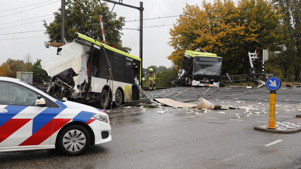

There were no passengers on the bus. There were no injuries among the train passengers either. The driver was outside waving his arms to warn the approaching train. You maybe able to make him out near left the red flashing signals.
The bus was on the crossing possibly due to a technical defect on the bus, police said. It is being investigated.

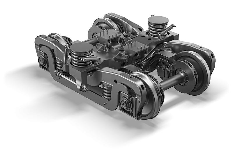

So, now you're an expert in train design and engineering too? Trains could never weigh the same as a bus "per person". Trains ride on multiple very heavy steel trucks (also known as "Bogies") that include the wheels, suspensions, braking systems and other components that buses simply don't have even if the cars are similar in weight and design.

The vast majority of train wheels in use are still made of steel. Even with aluminum wheels the tires are made of steel because they ride on steel rails. Aluminum is lighter than steel but they would still make train cars far heavier than buses which do not have bogies. The weight of an individual train wheel can be anywhere from 400 pounds (181.437 kg) to 2,000 pounds (907.1847 kg) and that doesn't even take into account all the other heavy components in a bogie which can weigh in at several tons and there are two on each car. An average train with 10 cars would have at least 80 wheels not including the locomotive. And you think they can build railroad cars that weigh the same as buses based upon the average weight of cargo or personal carried? :ROFLMAO:
