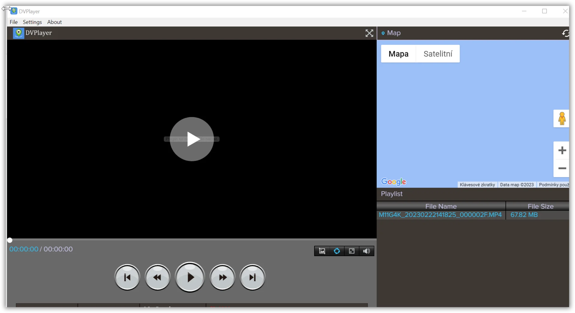

DVPlayer It doesn't work. Does anyone know what's wrong with it? Thank you for the advice.
This problem should be caused by your operating system environment variables. You can solve this problem by trying to reinstall the operating system. I haven't encountered this problem. I haven't found the specific reason for this problem. sorry!

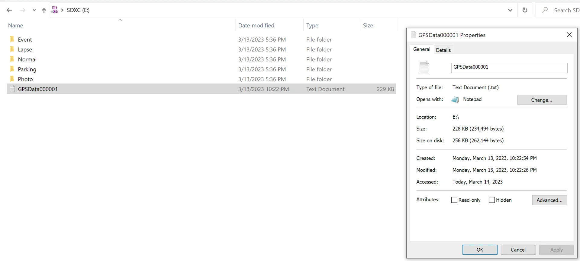

On CD card it has Archive and Hidden attributes and stored in the root folder of CD card.
You need to display this txt and remove the hidden attributes of the file

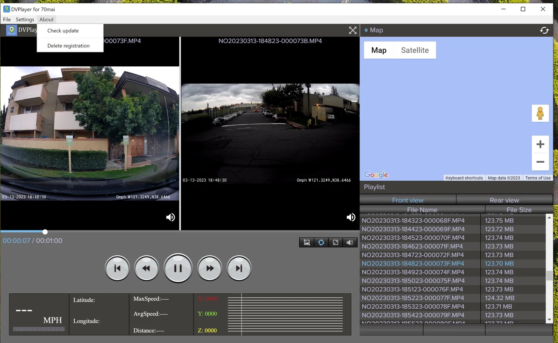

Thank you.
I removed attributes from the file:
But nothing changed.
Possible I have to load GPS data some way?
And Yes I use version from you post and Yes application is registered.
You put the txt file in the same directory as the video file
Thank you!
yes now it works! Or almost works;-) I see some data but still:
No tracks on the map - but as I see Latitude (north in my case - positive double) and Longitude (west in my case - negative double) shows correctly.
Speed shows incorrectly - possible it related to 1. or possible it get info from another column.
Will continue to investigate
