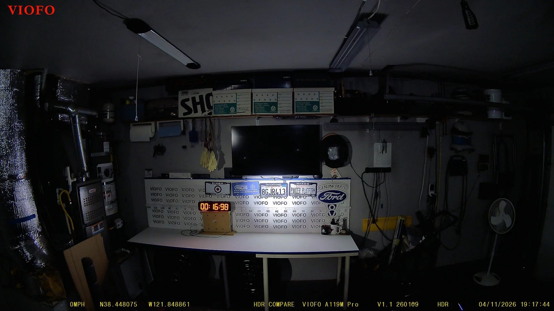

Q: What is the Measured Horizontal FOV of E1 Pro, and how does it compare to Viofo A119M Pro?
A:
112.26° = E1 Pro
112.26° = A119M Pro

STATIONARY HDR COMPARISON - E1 Pro vs. A119M Pro
I’m getting ready to install these cameras in my car to gather driving test footage.
Before I head out I wanted to check for any stationary differences in my garage.
Wow, I’m impressed the E1 Pro can actually read the plate better than A119 M Pro.
However, it comes at a cost, (everything else not under direct illumination is dark AF).
I know I can turn off PlatePix to brighten up the image but, that kind of defeats the whole purpose.
I’m excited to see how this plays out on the road with motion.
SETTINGS
A119M Pro
Firmware: V1.1_20260109
HDR: On
CPL Filter: On
1 Minute File Size: 266.5MB
Bitrate: 37Mbps Approx.
SD Card: 512GB Viofo Brand
E1 Pro
Firmware: VT-EFB271
HDR: On
PlatePix: On
CPL Filter: On
1 Minute File Size: 232MB
Bitrate: 32Mbps Approx.
SD Card: 1TB Vantrue Brand

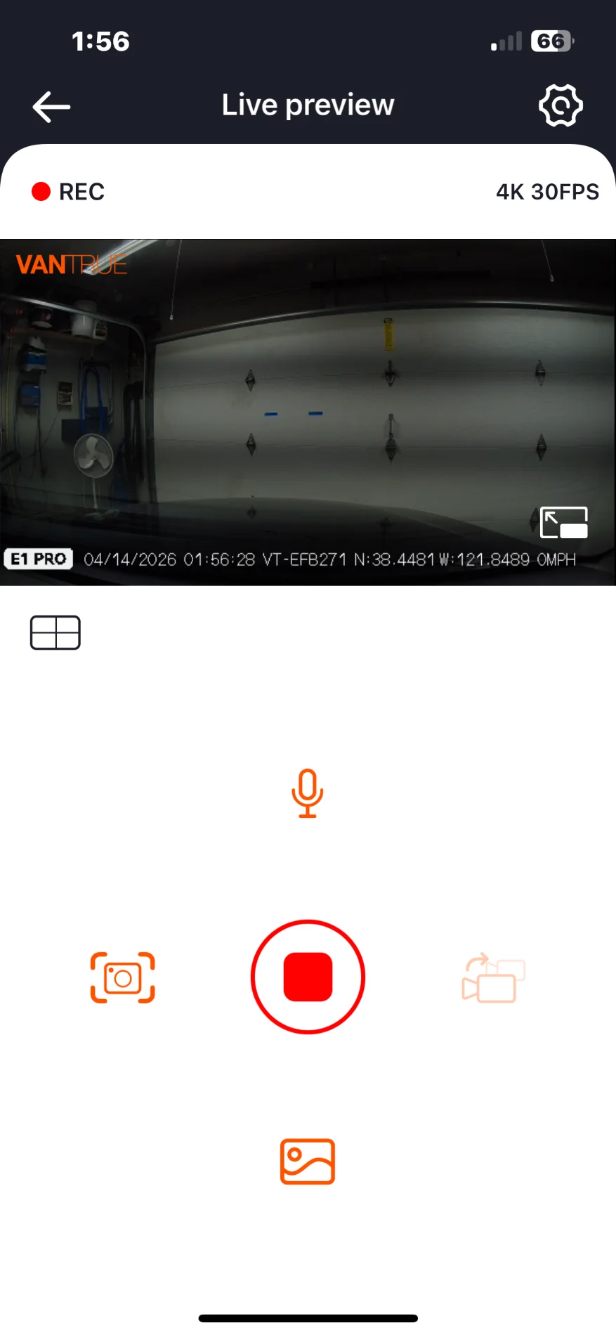

Q: Why do I have E1 Pro mounted with the OPTIONAL SUCTION MOUNT instead of included “permanent” mount.
A: Back in 2022 when I tested the original E1 (IMX335) STARVIS 1 I said the “hanging mount design” would be perfect for a temporary suction mount for rental car & travel use.
When installing the camera I was impressed how much stiffer, and rigid the mount was compared to the E1 from 2022.
However, I just looked at some test footage, and I’m seeing “vibrations” in the recorded footage.
It sticks out like a sore thumb when a car’s headlights are coming right at me, and I hit a small bump in the road.
These vibrations are detrimental to grabbing fine details, but I guess that’s the trade off you get with a hanging suction mount, instead of solid adhesive wedge mount.
