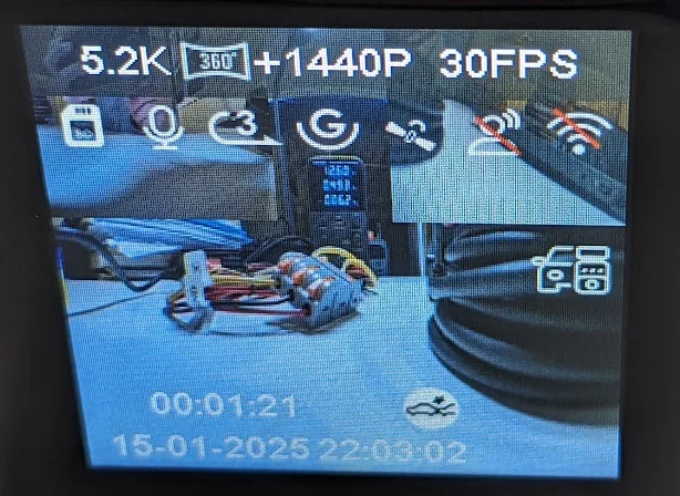

When the E360 is in normal recording mode, 5.2K + 1440P, this is what I see on screen. The third symbol from the left indicates a loop duration of 3 minutes.

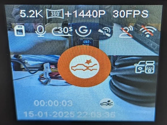

When I tap the camera to trigger the g-sensor, this is the screen after it wakes up. There is a collision indication symbol in orange in the centre, and the loop duration is shown as 30s.
