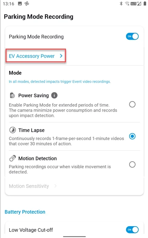

The EV accessory mode option is also turned on. I found that if it's off, the camera stays in normal recording the entire time even then the car is off.

You stated your Elite 10 is getting its power from a hardwire connection to your vehicle's fuse box. The connection to the vehicle's fuse box should be using the BlackVue 3-wire power cable provided with the Elite 10. If it's properly wired into the vehicle's fuse box [constant power, accessory/switched power, and ground to the vehicle's body], there should be zero need to use the "EV Accessory Power" setting. That's assuming the 3-wire power cable's accessory power wire is connected to an accessory/switched fuse socket with power that turns off when the vehicle is turned off.
The "EV Accessory Power" setting can be used when the dash camera is powered by cigarette lighter socket power cable or a the BlackVue 12V USB-C cable power cable. When the "EV Accessory Power" feature is enabled, the dash camera enters into parking mode after the vehicle is stationary for 5-minutes and exit parking mode when the vehicle begins driving. This feature was added to give the Elite 8/9/10 dash cameras the same G-sensor based parking mode functionality the older BlackVue cameras had.
You stated the Elite 10 stays in normal recording mode when the "EV Accessory Power" feature is disabled. That suggests that the 3-wire hardwire cable's accessory wire might not be connected to an accessory/switched power fuse box fuse socket. That might also be why the "Timer Cut-off" feature might not be working as expected. I would expect the "Time Cut-off" feature to work for Time-Lapse or Motion Detection parking modes no matter how the Elite 10 decided to enter parking mode.
