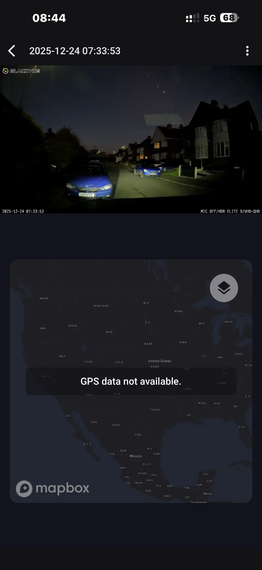

Paying closer attention to the app screenshots, there is a 'GPS Data Not Available' banner across the (presumably default) map of continental North America, once that banner disappears, the GPS position refines itself over a (usually) double-digit number of seconds.
These screenshots may help explain.

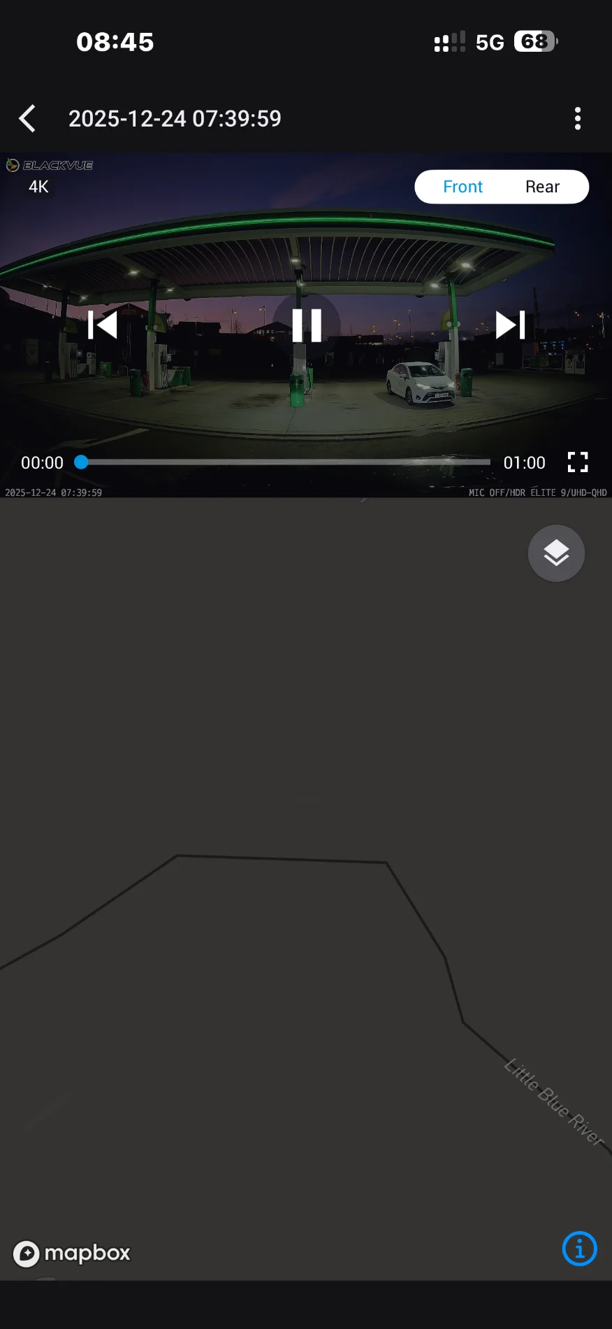

This one appears to have zoomed in to the centre of the continental mass

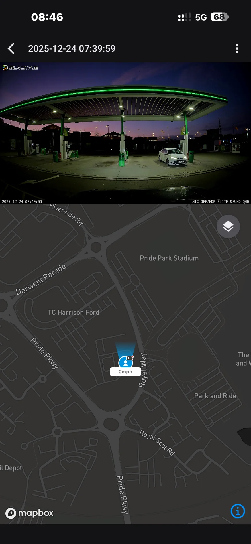

Finally, a GPS lock
