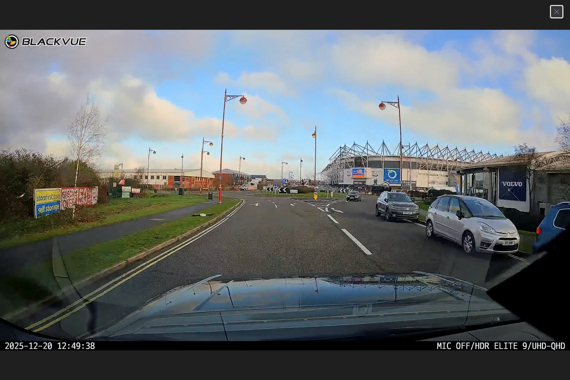

A couple of screenshots from a drive out earlier.
I've got a couple of CPL filters en-route, so hopefully that'll sort out the reflections, I can already see some improvement in daytime registration plate readability, as mentioned, for me, it's night-time static and dynamic readability that I want to gain. I'm not expecting ANPR class results and I don't want to go down the Chinese brand route although admittedly they do seem to have the edge...

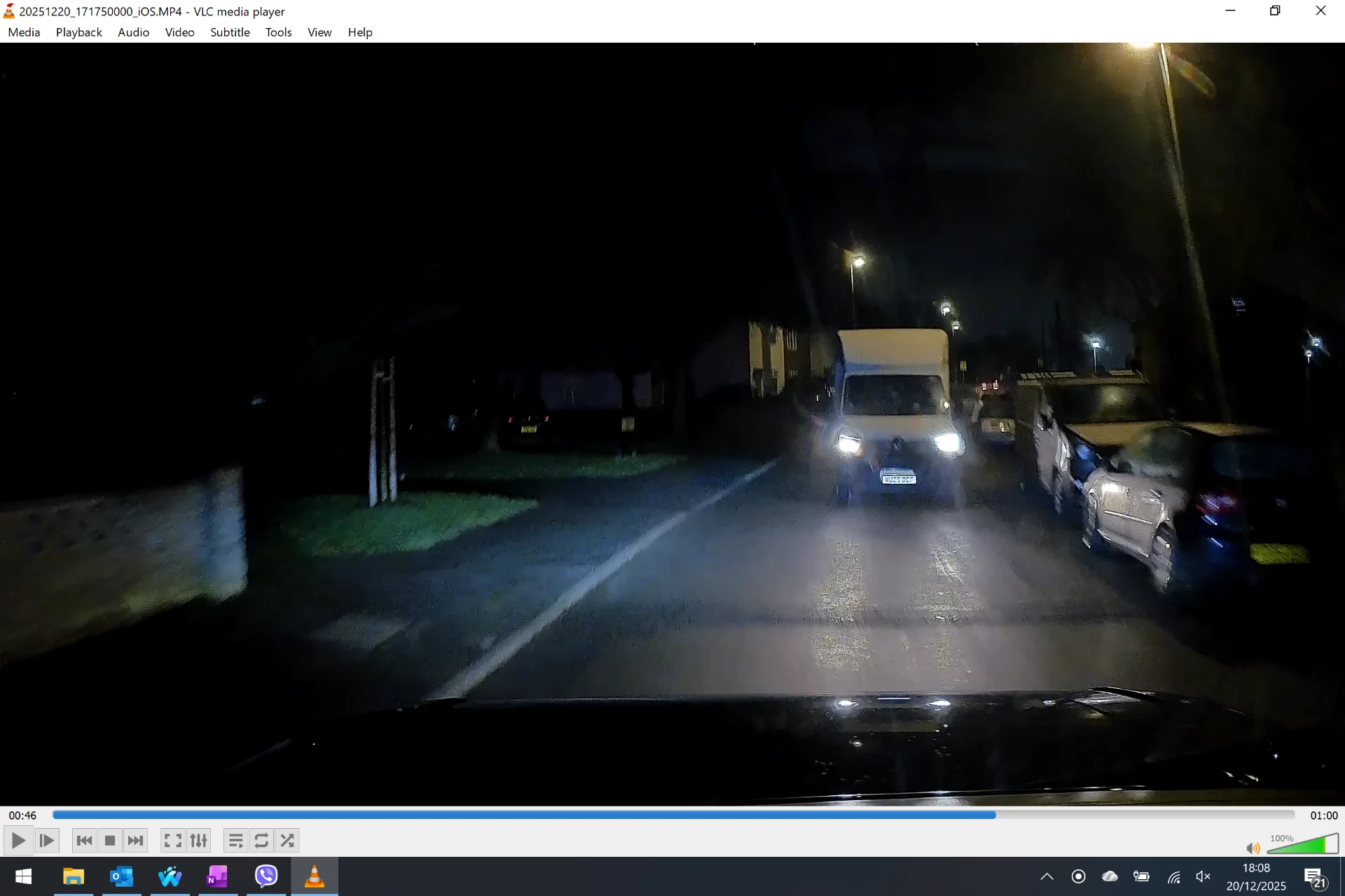

A short drive 'there and back' to take the dogs for their daily run in the woods produced some good results:-
White van man doing his usual....

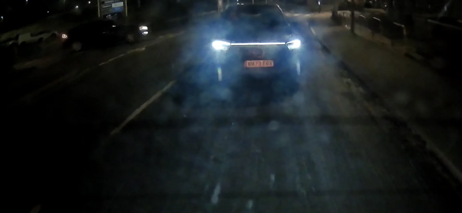

And some perplexing ones:-
Oncoming traffic (30mph + 30mph so closing speed of 60mph) renders the registration readable but the car in front, effectively stationary as we were both moving at the same speed is overexposed.
'Contrast' that with this shot - both moving at slow speed ~10-15mph, but perfectly readable
It did occur to me that maybe this car had an anti-camera coating on the plate, but it didn't seem 'the type'...
Anyway, lots of food for thought, including the images from my ARC 900 in similar circumstances

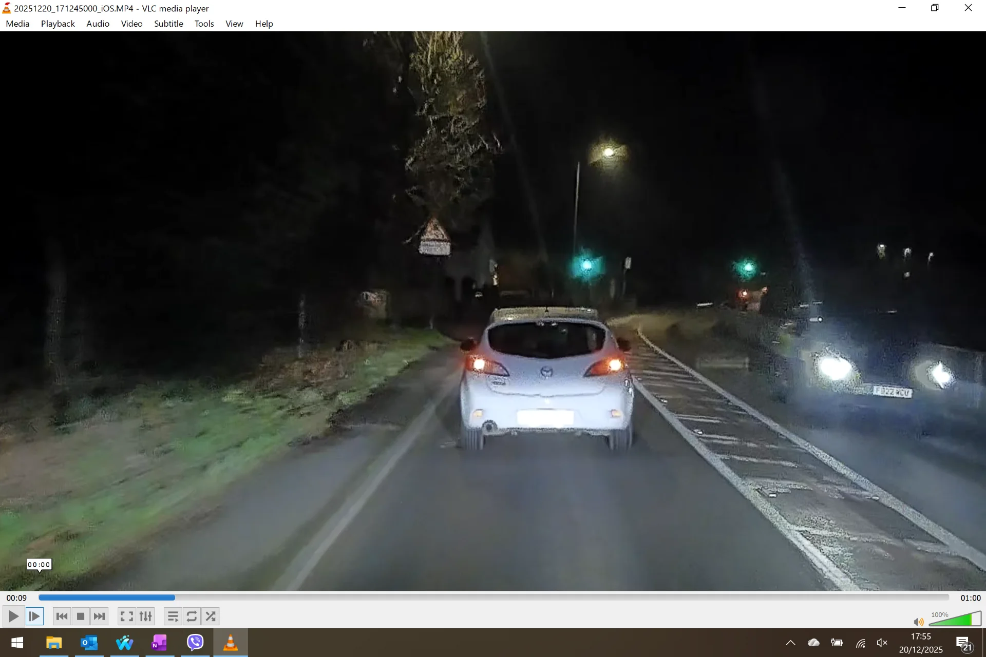

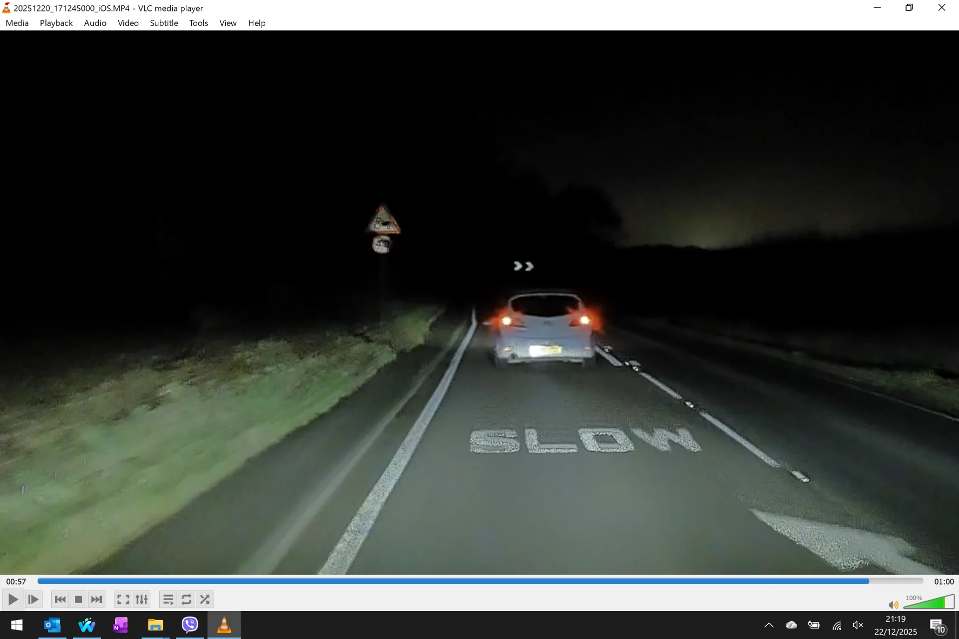

Some photos from earlier tonight, both rear camera - odd that the white car is blurred out of all recognition but the darker car behind me isn't?
Street lighting was present but minimal, rear screen was dirty, but clean enough to read the plate of the following car, it was on a retail park approaching a pedestrian crossing and then a set of traffic lights so speed was probably ~20mph

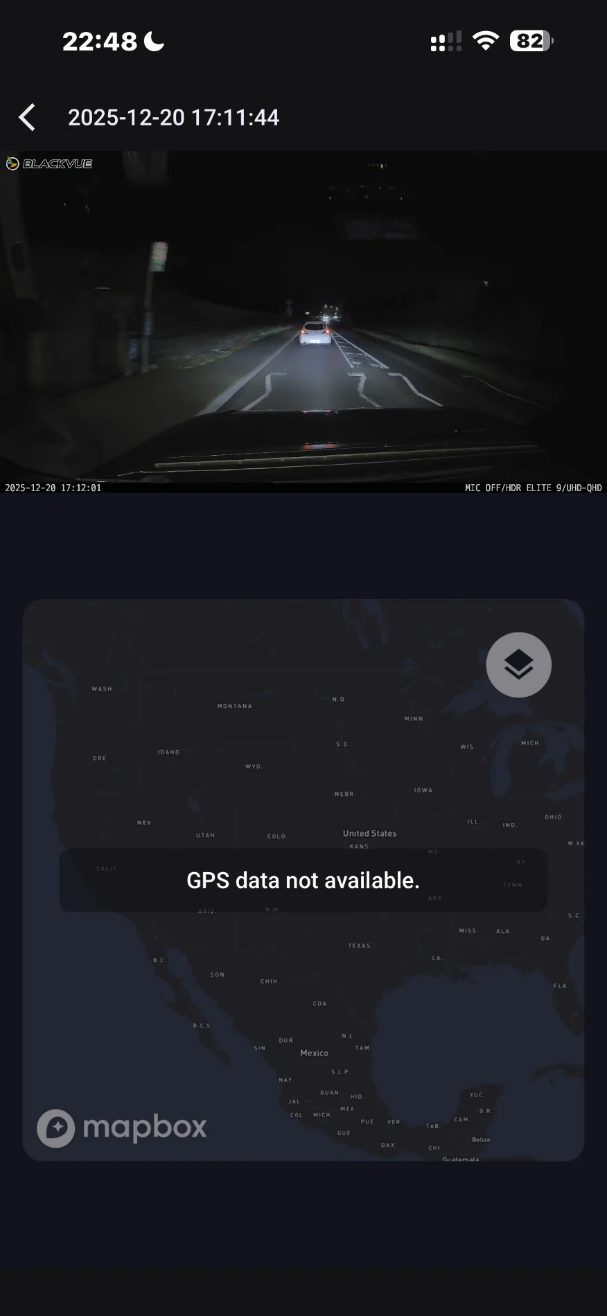

As mentioned elsewhere, GPS lock is still taking longer than expected, even after firmware update 1.003 - something that was never a problem with Thinkware Q850 / U3000 Pro / ARC 900.
I could understand it if the unit had been powered down and moved several thousand miles, but it hasn't. The timezone and the sky according to the 'last known' set of visible satellites is the same. This is basic functionality that the cheapest Chinese chipset is capable of achieving, I have other GPS devices that will achieve a lock in seconds, or, in the case of those that have not been used in weeks or months, in a single number of minutes. Yes, I have a heated windscreen, that is thicker than average - but - the GPS receiver is (presumably) positioned optimally in the housing, the one in my phone is in my pocket, on it's side, and still manages to give an accurate position - better still, I switched on my Garmin handheld that hasn't been used in months and was last used a good distance away - it achieved a lock in less than a minute.
Maybe the default location is somewhere in the US - as the map would suggest using the Blackvue viewer, rather than starting out with the last known position, which would result in a faster lock?
Have you tried turning on the dashcam outside of the car via like a power bank or something to see if the GPS locks on faster?
These screenshots would seem to support the US-centric GPS initial location
The first one, a few seconds after setting off - only parked for <15 minutes.
Second one, a few seconds later, presumably the short parking time meant the GPS location wasn't 'stale' and didn't require the full refresh it seems to require after parking for a few hours

Some photos from earlier tonight, both rear camera - odd that the white car is blurred out of all recognition but the darker car behind me isn't?View attachment 88941View attachment 88940
There's perhaps 40mph relative speed differential between you and the white car, compared to almost none for the car following you. That would account for the blur on the white car.
The white car had stopped at the junction. I do think there is a 'problem' caused by the combination of UK plates and white/light coloured cars.
