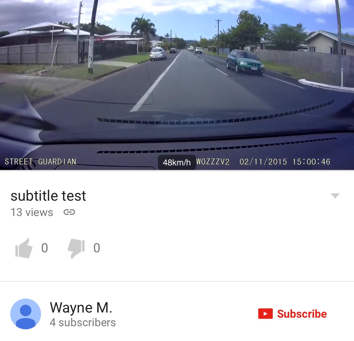

how come mine sucks??
Looks ok, What's wrong? I see your speed at the bottom. Be sure you are viewing via the full YouTube app if you're mobile.
theres the black background
I cant work it out
