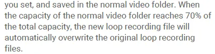

Some cameras have fixed allocations for video folders, others can be adjusted by the user within an available range to suit their preference or their mix of driving / parking durations.
Here's one example from the Vueroid S1 4K Infinite (copied from thread by @lufa6977)
The Vantrue S1 Pro Max allocates 70% for Normal video and 30% for Event recordings:
That's a cool feature which takes it to another level, allowing the user the ability to adjust memory storage allocation.
