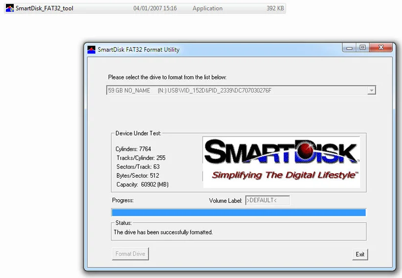

Majority of dashcameras uses Fat32 MicroSD / SD cards, which are up to 32Gb
However many of them can use higher capacity like 64gb and maybe higher, but problem is that all of them are in exFat.
There are few ways how to format exFat to Fat32.
I found for myself best and quickest way to use SmartDisk Fat32 Formatter Utility Tool.
I have tested it on SanDisk and Samsung 64Gb MicroSDXC cards and all works fine.
You can download it from HERE
