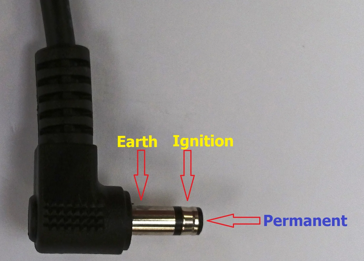

I strongly suspect the Ignition & Permanent power are back to front. If they are correct then the permanent power could be going to sleep so the camera can't go into parking mode. It should be about 30 seconds after the igntion going off that parking mode starts (verbal message is given if you have volume on). I have attached the image of the connector plug as it would be good to check the voltages at this end.....
