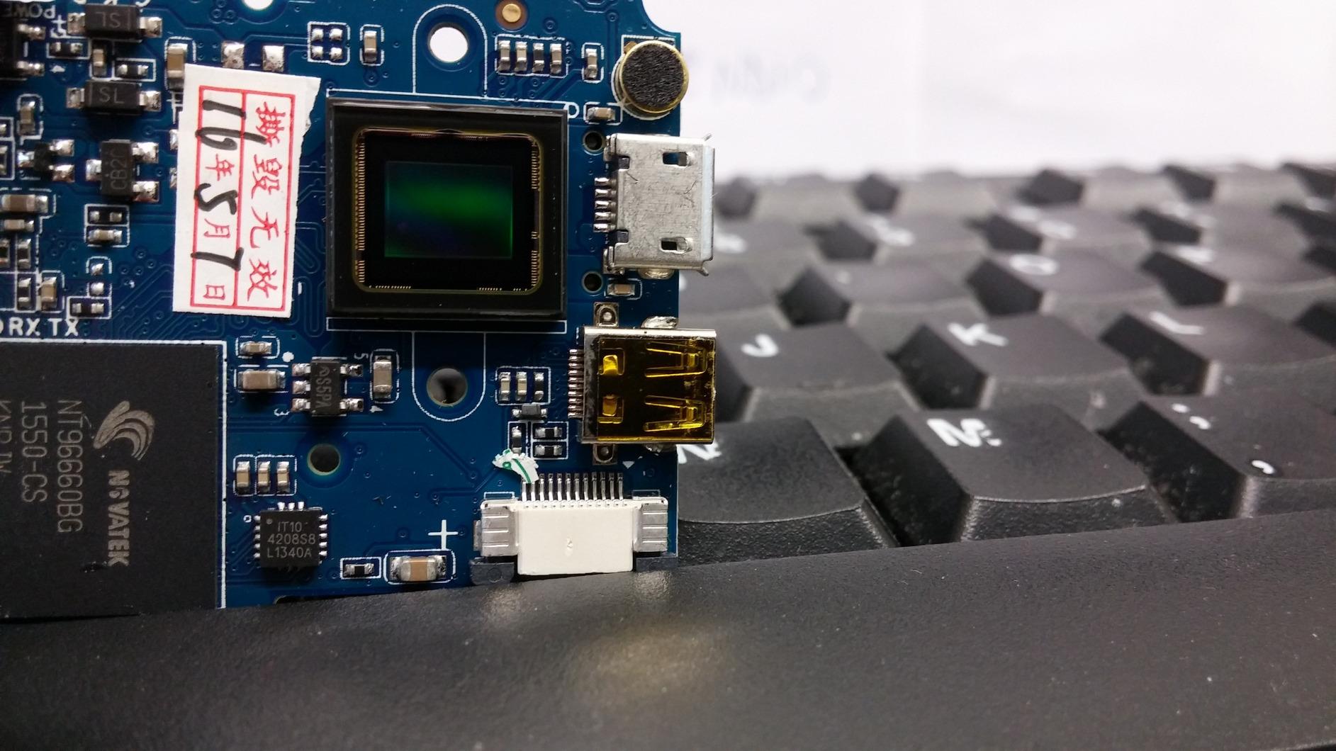

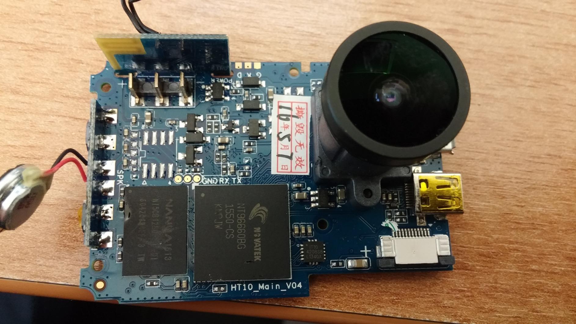

Yes!
Sensor: Sony imx078cqk
Chipset: NT96660BG
RAM: Nanya NT5CB128M16FP-DI [2Gb (128Mbx16) DDR3-1600 (800MHz)]
Accelerometer: IT10 - 4208S8 - L1340A
Flash ROM: MXIC MX - 25L6406E
Vocal synth: NY3P115BS8

Great pics! thanks for posting.
Same parts used in SooCoo C30/C30R and Elephone Explorer Pro V1.0/RV2.0. All have HT10 series PCB's (Firmware FWHT108M.bin)
