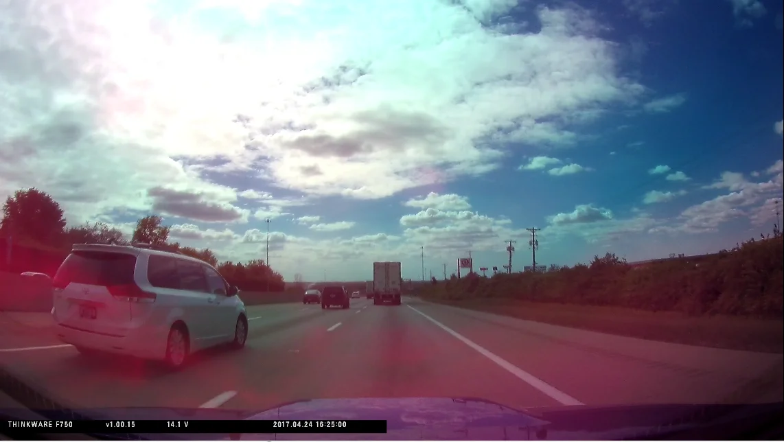

Fast forward a year or so and now my front camera is blurry with a purplish haze on the outer edge of the bottom half of the recording. I no longer can see license plates as everything is blurry. The camera lens has no artifacts and is clean. My rear cam quality is as perfect as the day I bought it.
Has anyone experienced this? If so, what was your fix? If not, what is a good resolution?

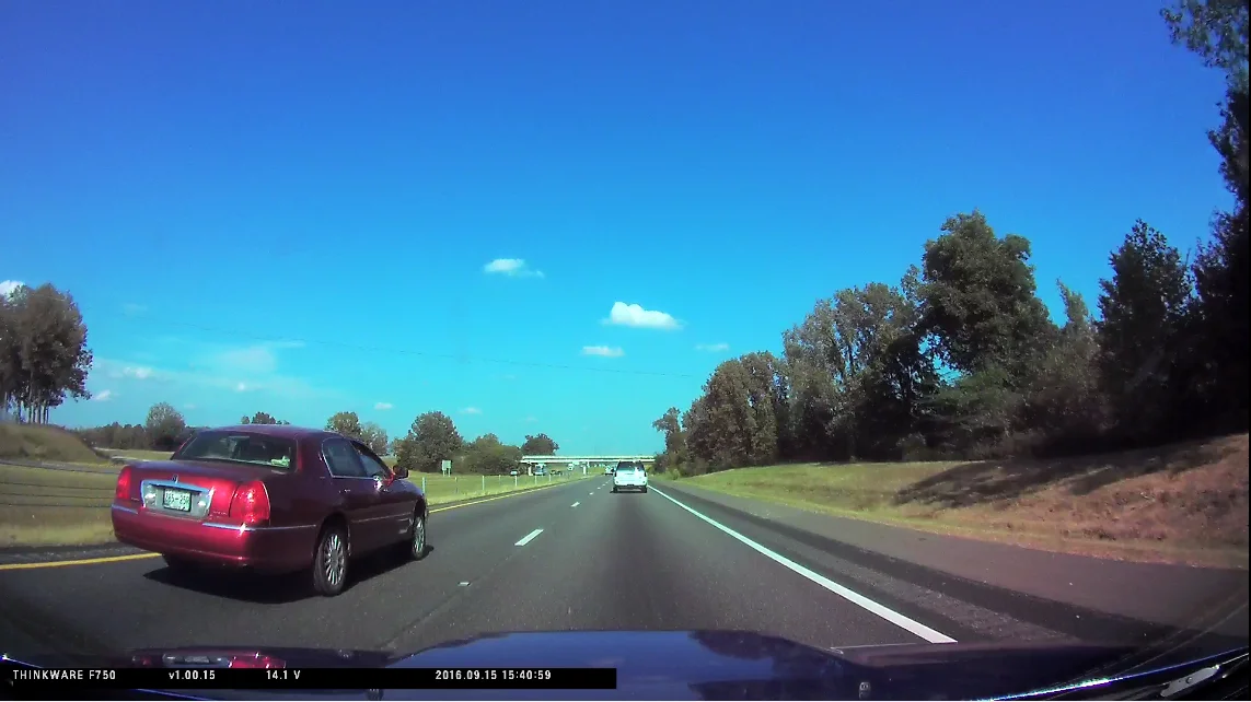

I uploaded a screenshot of the earliest recording I can find and a screenshot of a recording from the other day

looks like a hardware fault, you should talk to wherever you bought it from about getting it replaced
I was afraid of that. I was hoping there was something I could do myself. I bought it in late 2015 so I doubt Best Buy would exchange it after all this time. I'll ask though. Thanks for the help!
That actually makes sense. I do recall that this all started around the same time that we experienced a really hot summer and I wasn't able to park my car in the garage for a couple of weeks.
My feeling is it won't be heat related (as we're in the UK!) but i have seen one other camera with a very similar issue. As said it was hardware related but i think it was an unlucky general failure.
