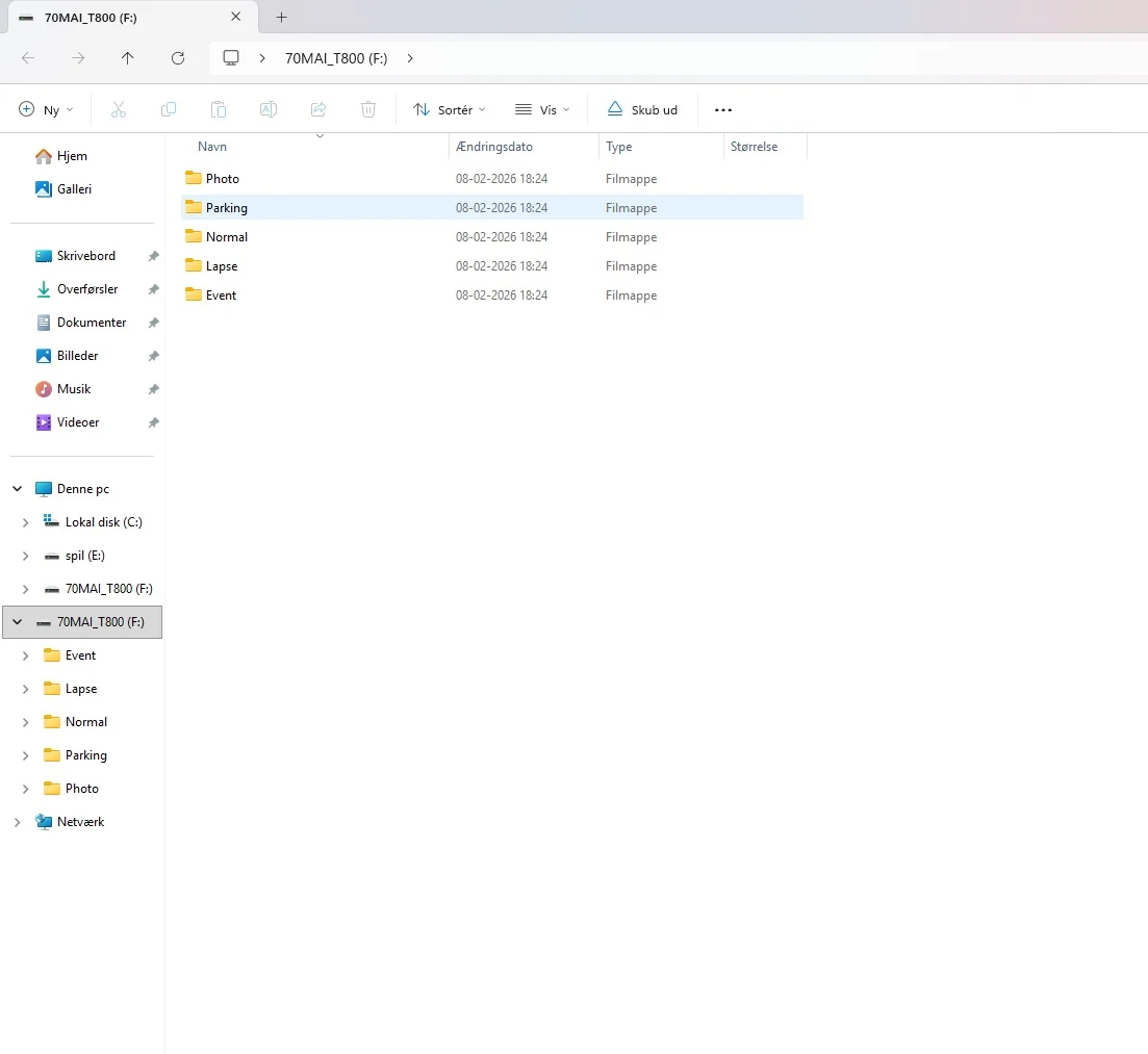

I agree if G-sensor is on there aught to be a event created as you crash, and as mentioned they go to a read only folder named event or RO / something like that.
Also as i recall, even if you do not have any event on your brand new system, folders for such things are usually created anyway, and so you also often find a photo folder ASO
So to me this all sound very strange, but i have no experience with the red tiger brand, but i assume they are much like all other dashcams.
PIC of file structure on a memory card from a 70mai T800 system, each folder have 3 sub folders ( front / Rear / Interior ) as it is a 3 channel system.
This is a 100 % full memory card of 256 Gb but only the Normal folder have anything it it, as there are no time lapse recordings / photos or regular / parking guard events made.
