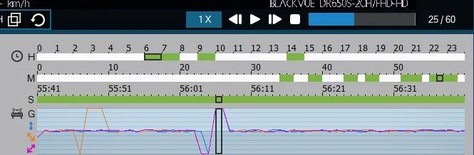

When you view that file in the Blackvue Viewer, it should show the G-sensor graph. Anything of note there?

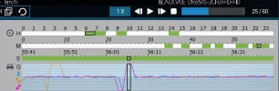

I looked at the graphs, and they spike like crazy... no visible movements, we haven't had a storm in a while and the car is on rock solid coilovers so i won't budge easily, and as of that, i'm having a real struggle with this 1.009 FW..

Wow! That's whacked. The spikes you're seeing are off the scale, which should be near impossible in real life. If you get 1.008 back, it'll be interesting to see if that rectifies the problem. Either way, you'll want to report this to BlackVue (not that I'd expect a response).

Well... off the scale you say? I took a look at the calibration tool.... totally OFF grid!
This shouldn't be possible! Not even with a windy stormy day, unless s*** is hitting the roof...
FYI; Car is parked, and has been at that moment for 1½hr, no wind, no rain, no nothing. And just as if the cam decided to have some fun, things went off the scale, quite fast!
