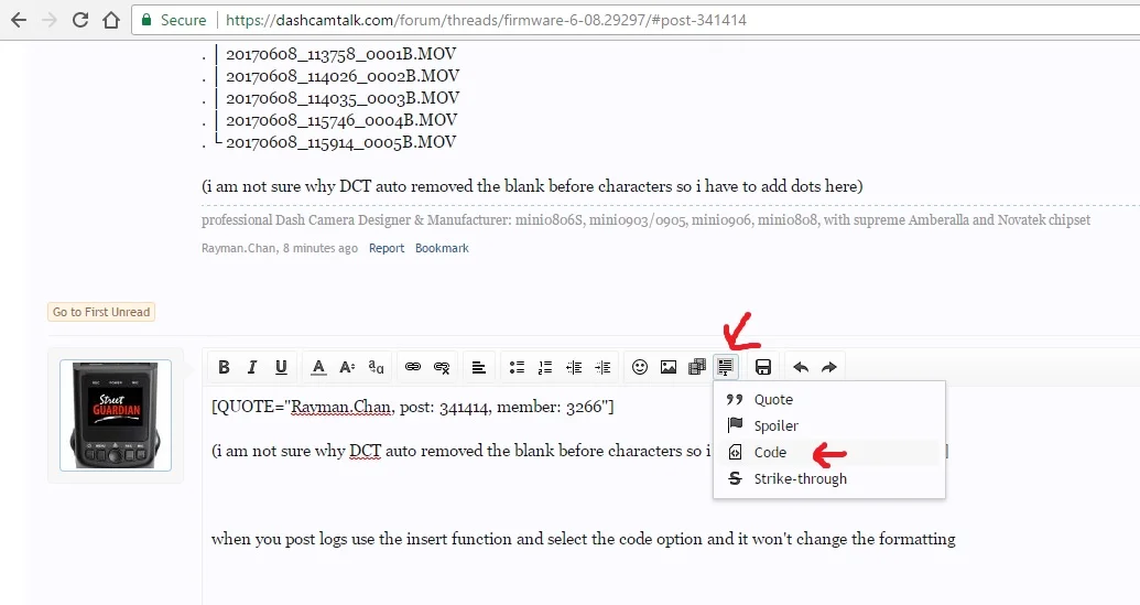

(i am not sure why DCT auto removed the blank before characters so i have to add dots here)

when you post logs use the insert function and select the code option and it won't change the formatting
Thanks Rick
