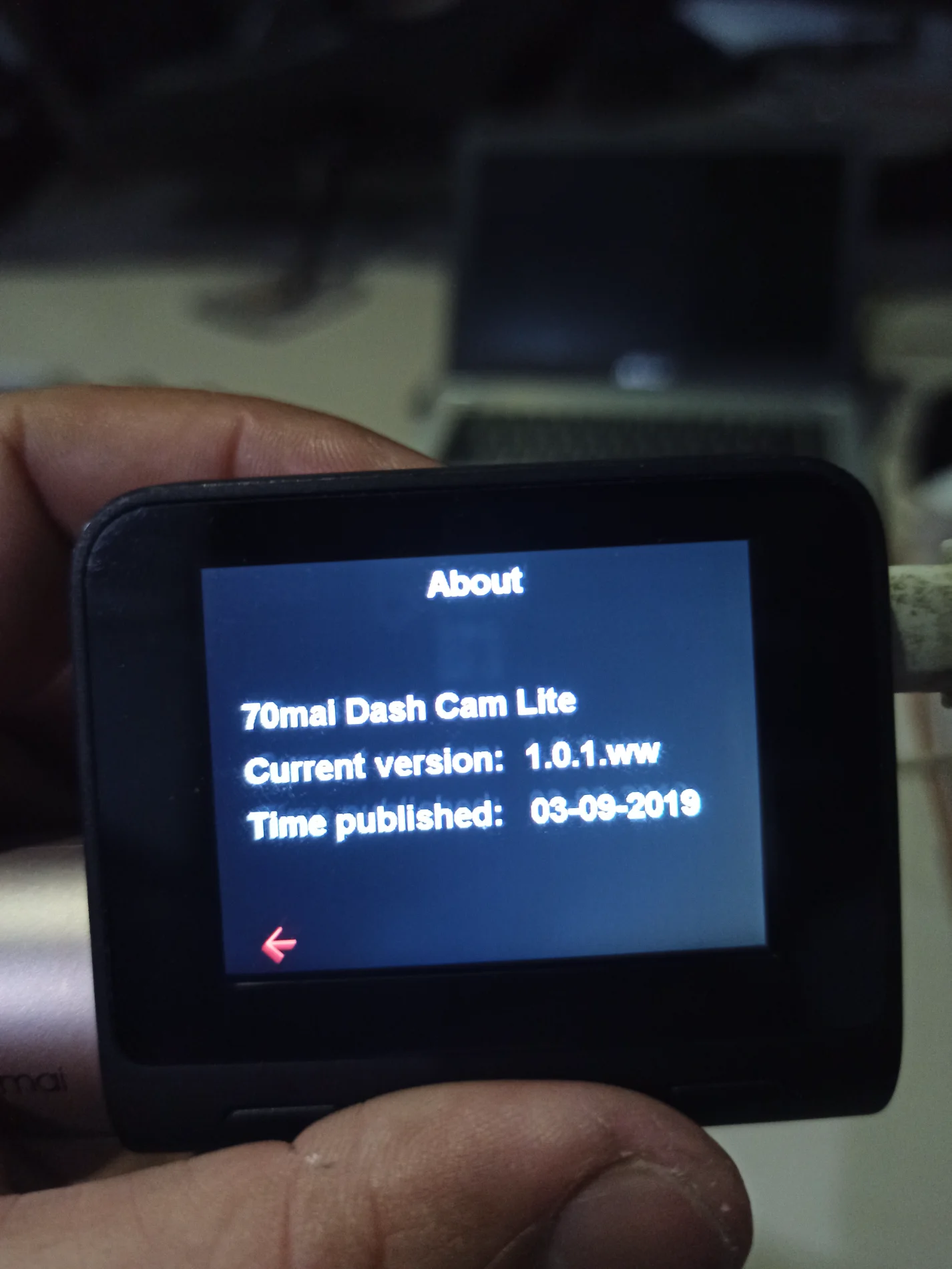

- Original FIRMWARE 1.0.1ww for International Version (WW):
(Russian, English, Spanish, Japanese, Korean, Portuguese)
OTA_31_FULL_DR0010_v1.0.1_ww_20190903-1923_full
Option 1:
1. Turn off the recorder and pull out the power cord.
2. Download the archive and unpack.
3. The unpacked file FW_DR0010.BIN, copy to the root of the flash drive (just throw it on the card and not in some folder).
4. Insert the card into the registrar. Not including the recorder, insert the power cord. The update will start automatically.
Option 2:
1. Turn on the recorder from charging without a flash drive.
4. Insert the card into the registrar, turn it on as usual (if turned off).
5. Click the Menu-System Update button and agree to the firmware. We are waiting for about 2 minutes. The recorder will shut itself down. Turn on the recorder and enjoy the firmware.
