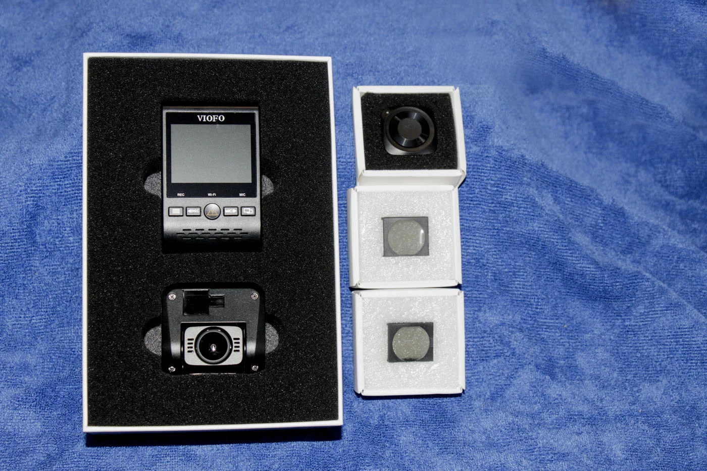

I received an A129 Duo for testing with front & rear Polar Filters and the Bluetooth Button.

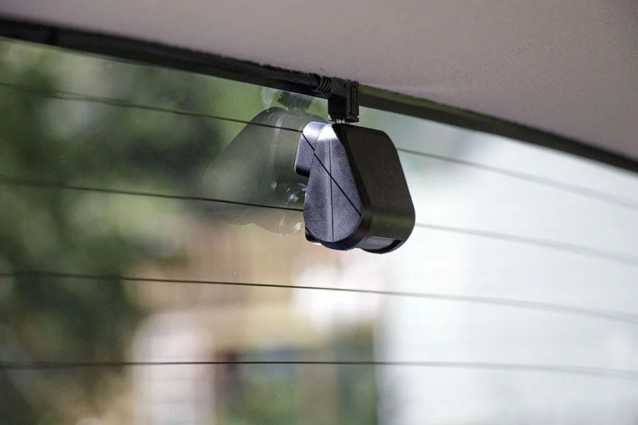

Some have complained about the larger diameter rear camera cable but I have no issues. I am impressed with the quality however, its kink free, as it will lay out flat when you unwrap it. This was really nice when routing the cable.

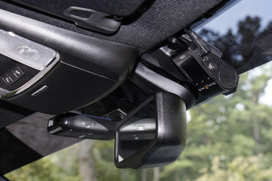

The Installs: I will not complain about the cable attachment points or angles, how the or which direction it slides off or on the mounts, or which side the mSDcard is inserted. You have to roll with it because they just cannot make it super custom for all vehicles. There is no selection menu at point of purchase asking what make, model and year vehicle you will be mounting it to. No selection asking if you are going to mount it under, to the left, or right of the rear view mirror. I think the layout is done well and I had no major hoops to jump through to apply the A129 Duo to my vehicles. I do suggest you add a visor tint film strip up front and let the cam lens protrude below it. Your mount tape or suction cups for other devices will not show or attract thieves.
Both my cams are to the right of the rear view mirror. I run radar detectors on the left.

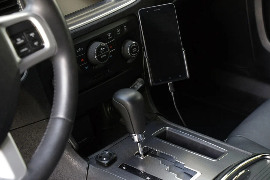

The Bluetooth Button: A very nice feature. It pairs immediately and puts locked files in to a folder named RO. It gives a confirmation beep or two. I still have to get deeper into it and see how far back it goes.
The battery is included and you pull the tape and stick it on.
Know this. To change the battery you twist the unit and the battery cap stays on the tape. So put it where its not going to get hit by dragging cords, coffee cups, you name it. It can be bumped enough to twist it open.

Here is what I received from Viofo

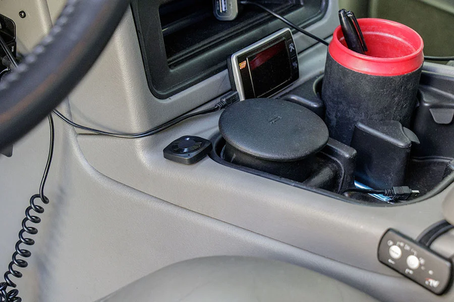

The Charger Install The images make them seem larger than life.
The Truck Install

Great review :cool: I will be watching this thread closely too but one thing I noticed in your'e pictures above:
Is in the truck install? Don't know if it mattes or not but the cable from the front camera to the rear camera (the cable ends are the wrong way round?) as the charger install! you have them the correct way round, I was thinking you knew this because of the layout & suppose it doe's not matter but just thought to mention in-case it helps you out down the line for future etc. (I'm not trying to blame anything or anyone) Just I installed mine the other day & either end is marked with a silver sticker.
I know you mentioned something about this in the OP under The Installs:
You can use the cable for the rear camera either way.. whatever suits you best with the connectors..
Yes, which ever is more convenient. A nice option.
